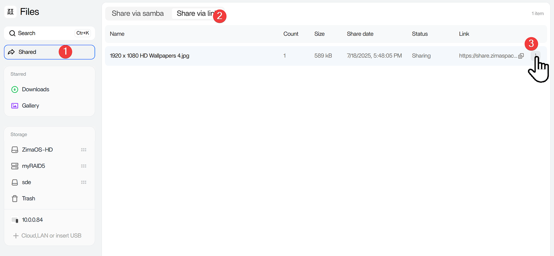

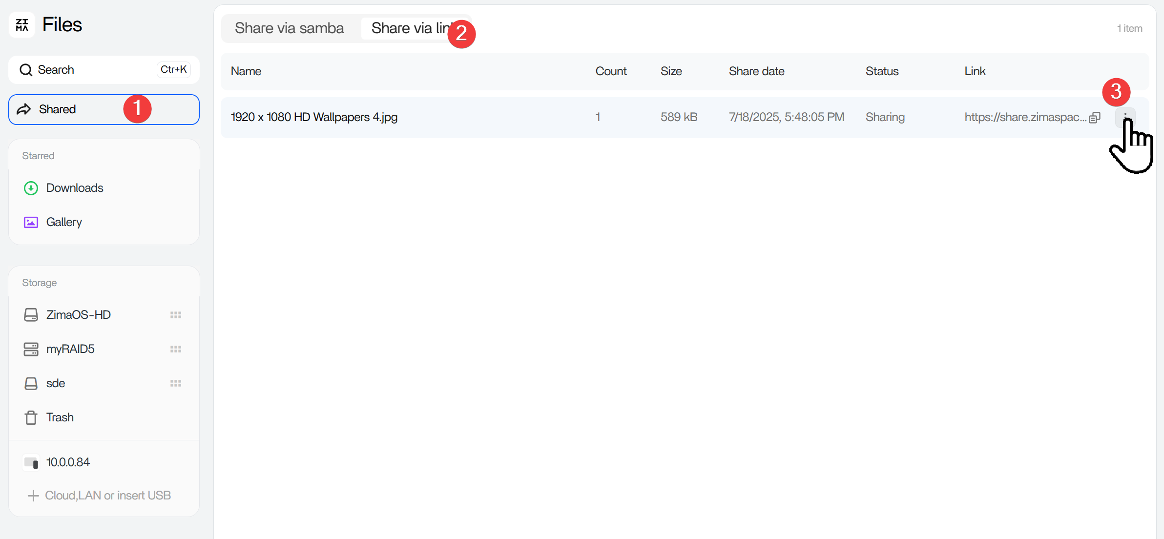

Hello, thanks for the feedback. These traffic is serving our Share via Link feature. This happens when you use this feature.
For details, see: this article.
We may consider turning off this feature by default in the future. And alert users when they use this feature for the first time. Thanks again!
Thank you for the answer,
How I can disable this service?
Disable all the sharing that uses the share-via-link service.
Stop all the sharing and watch the traffic.
Look forward to your feedback.
