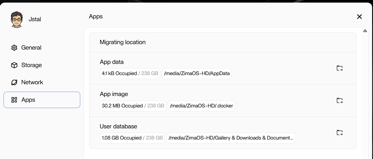

So I want to migrate the User database from ZimaOS-HD to the second SSD drive called “sda1”.

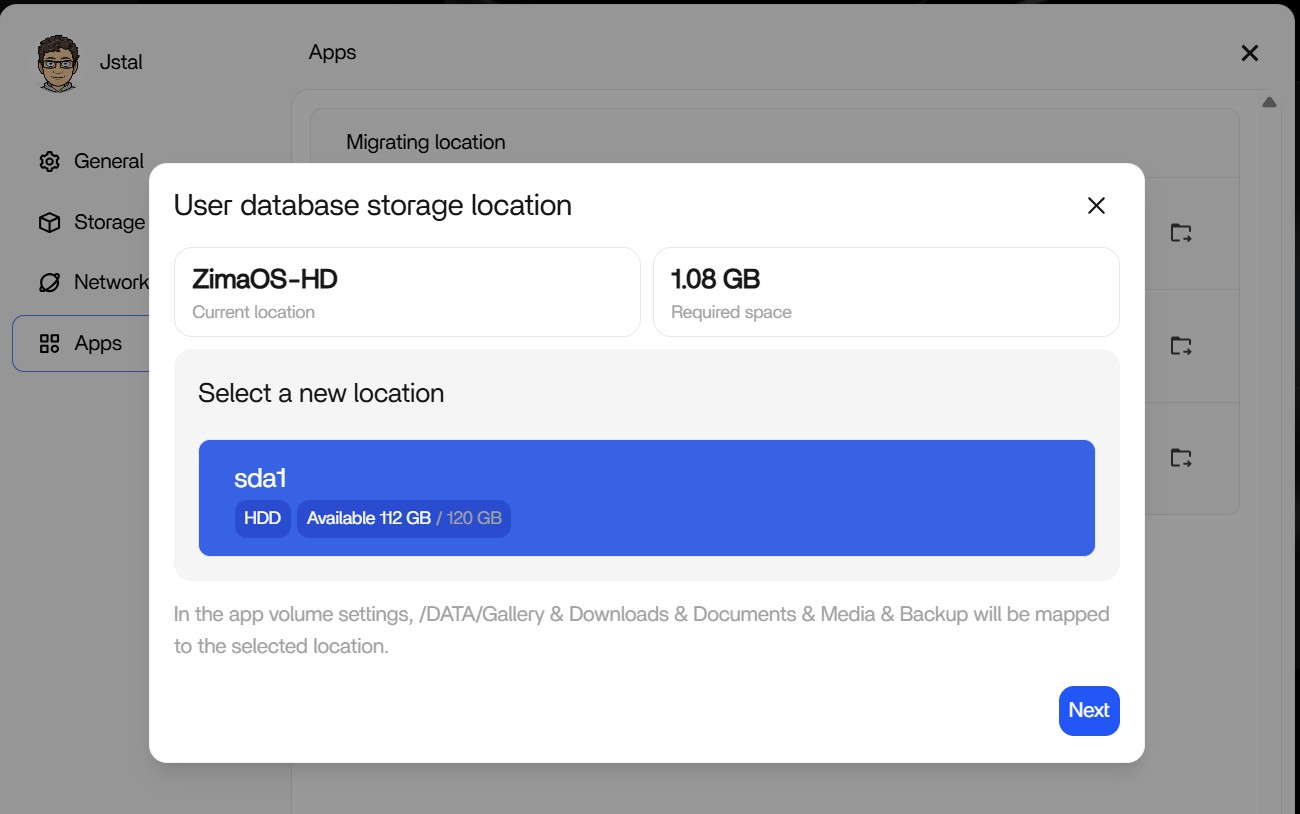

Step 1: Select the target disk

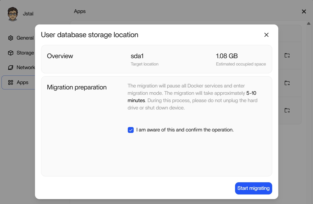

Step 2: Confirm the transfer

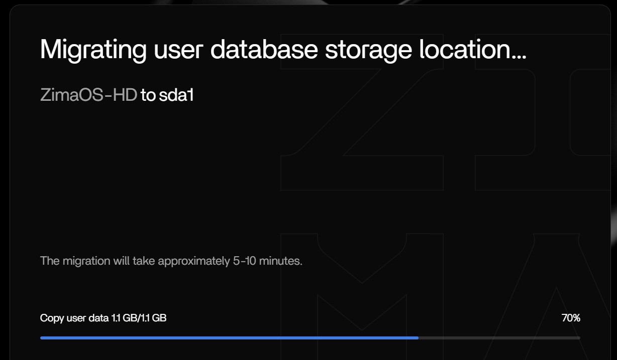

Step 3: Migration in Process

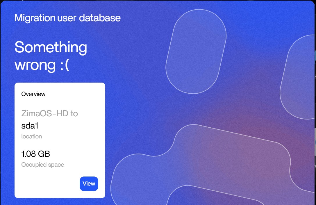

Step 4: Result of migration - always fails, where can I find a logfile of this process? maybe that could help you’re investigation.
Step 5: Finally nothing has been migrated

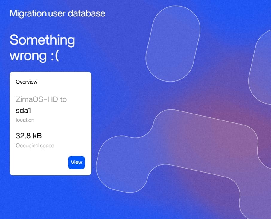

So as matter of test I removed all the data from the target disk and repeated the migration process.
Same as before: NO Migration took place.

Thanks for your feedback, we have located that the reason for the migration failure is related to the file system of the drive letter of the target path, you can format your sda1 to ext4 format and try again, the final permission copy list cannot be copied, resulting in failure, we will improve it later
After formatting the disk to EXT4, the migration worked perfect.
So we can state now that when your disk is formatted as NTFS migration will not work.
