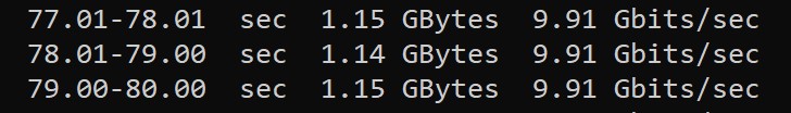

Ok i got new problem now :upside_down_face: My smb multichannel setup does sometime kickout to singlechannel and one card stop working after i while. so I took a test with iperf3 and find out with one nic got problem that was sitted in PCi gen4 slot.

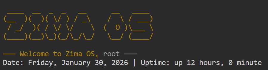

Finally I have managed to fix all the problems I had with instability.
I updated latest bios on the Asus tuf z570 motherboard which fixed the problem with unstable Pci port. After the Bios update I have had the server up for 12 hours without any problems :slight_smile:

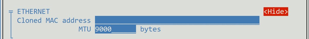

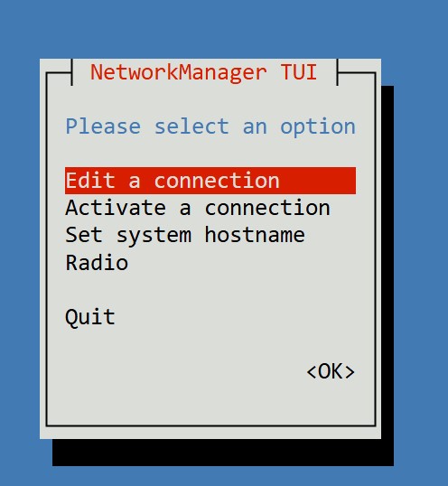

Now I have changed the settings for the network cards to 9000mtu

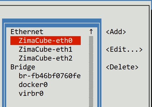

You have to go into advanced settings which you have to start with terminal by typing sudo nmtui

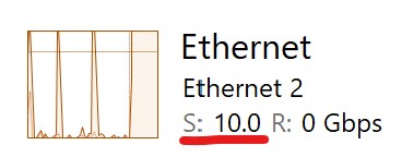

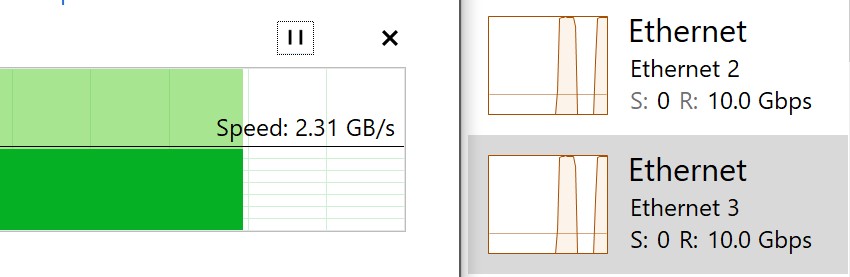

Now i get full 10Gbit on both cards wich in smb3 multichannel is 20Gbit
up and download to ZimaOS server :slight_smile:

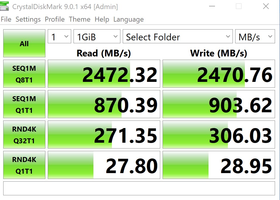

I get this result in CrystalDiskmark
