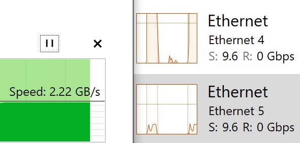

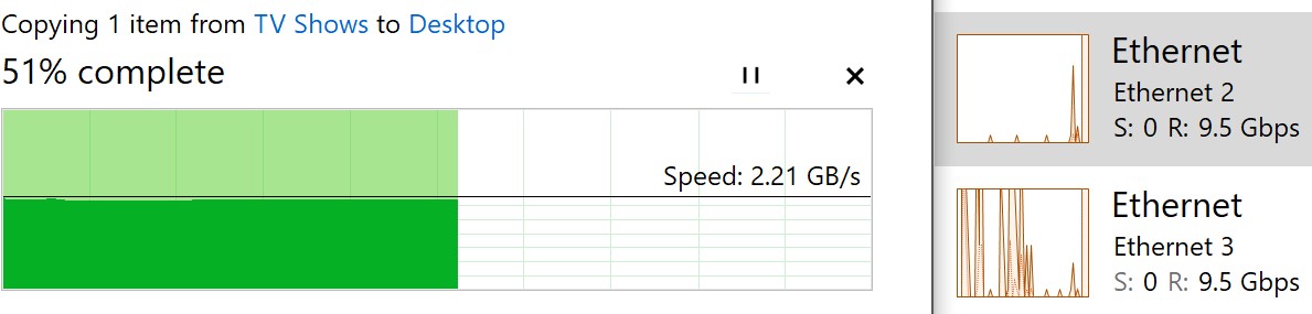

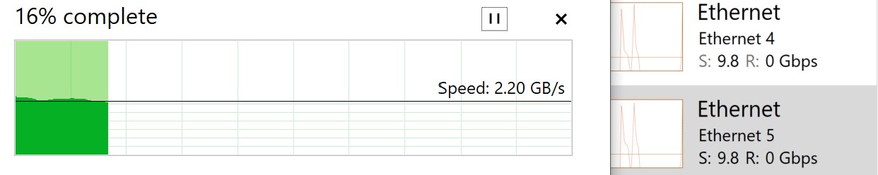

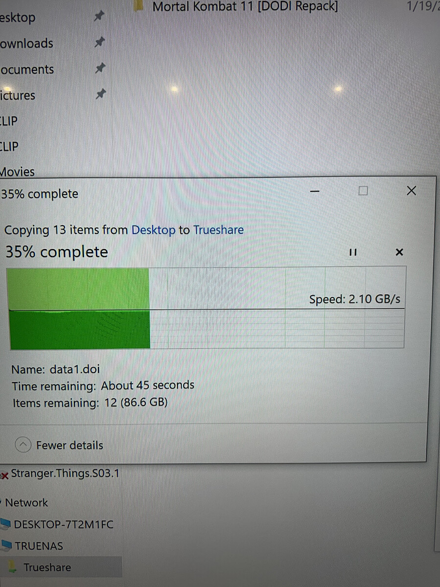

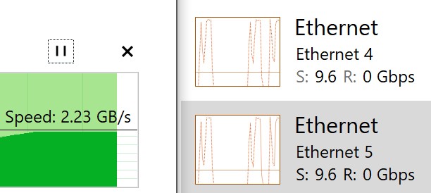

This is my result in TrueNas SMB3 Multichannel activated with to 10GBe nic. I get double speed in TrueNAS because it use both nics. I hope ZimaOS impliment this future
Perfect @Norinatt

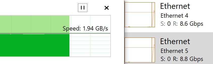

Your screenshots confirm SMB Multichannel is working now:
  • Transfer speed is around 2.1 GB/s
  • And Task Manager shows both Ethernet links active at the same time
That’s exactly what SMB Multichannel is supposed to do (multiple SMB channels over multiple NICs).
Looks like you’ve got it sorted :+1: thanks for posting the results — super helpful for others.

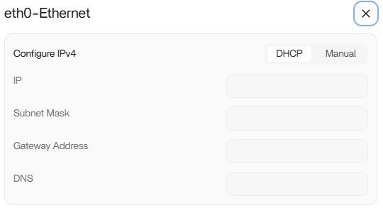

First, Linux/Samba isn’t very happy about multi-homing (two interfaces with IP on the same subnet). It’s possible to hack it on a normal Linux, but not recommened. Windows on the other hand handles it fine for SMB MultiChannel. But using Samba on Linux, you should use two IPs in different subnets.
If you have 2 x 10G in ZimaOS (is it zima hardware or custom?), what do you have on your client, and is it Windows, Linux or MAC?

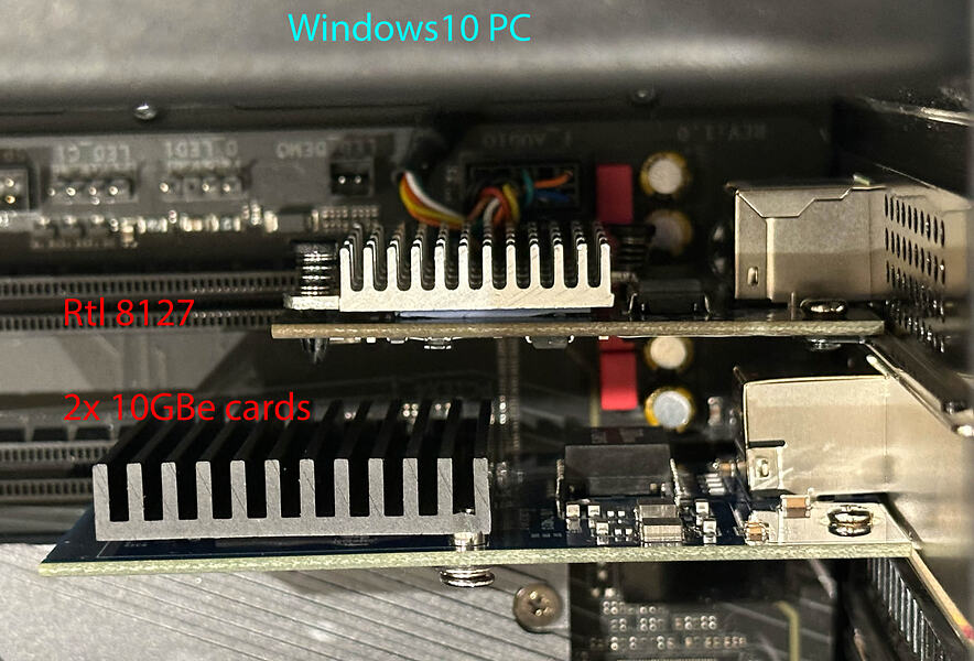

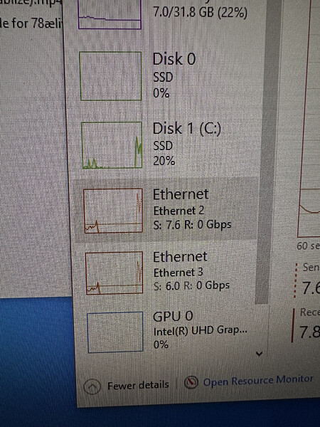

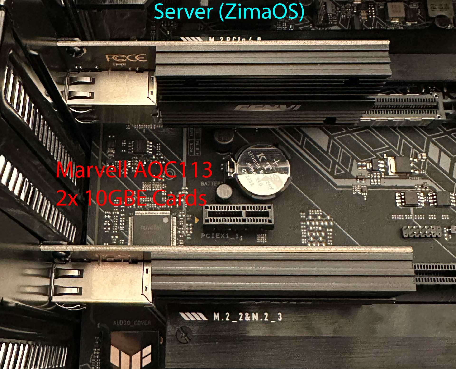

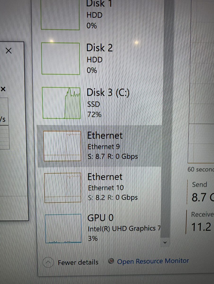

Hi thanks for reply. I have 2x10GBe RTL8127 nic in ZimaOS server and 2x10GBe Marvell AQC113 nic in windows 10.
When i write ``` testparm -v in terminal i get this

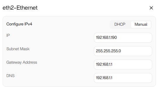

How can i use diffrent subnets? Can you explain how I should do that?

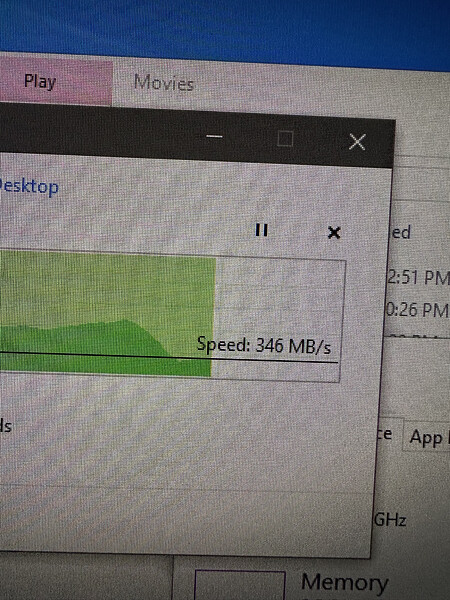

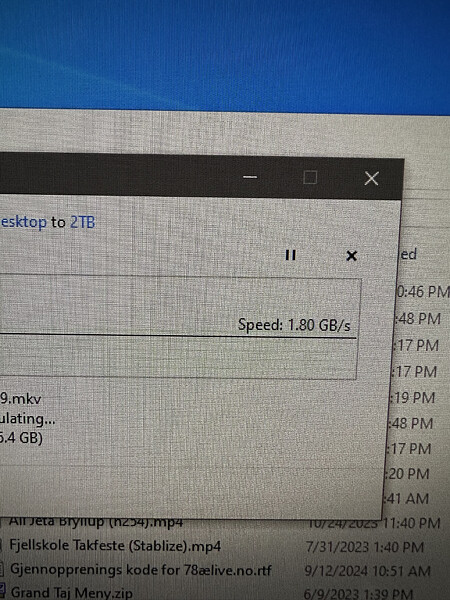

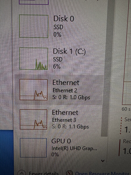

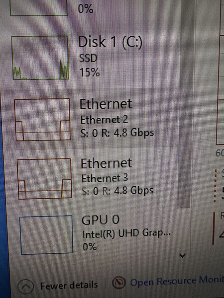

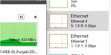

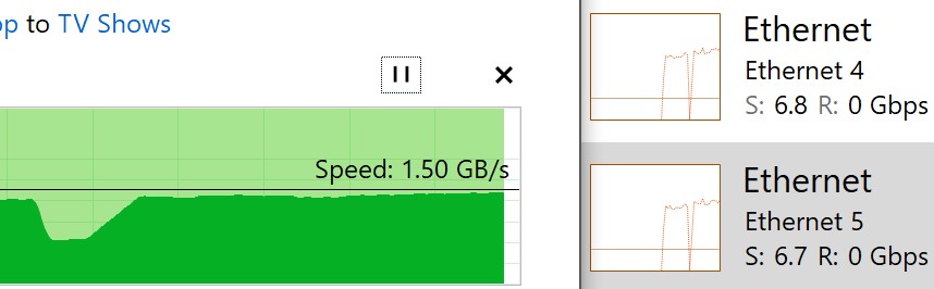

Ok now its work but preformence is poor. Only one time i get full speed. Most of time it split half speed on both nics.Sometime its very poor. So its very unstable.
Here is result
I get this speed most of time. Half speed split on both nics. My ZimaOS setup is one nic have static ip adress and second nic have dhcp.

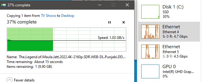

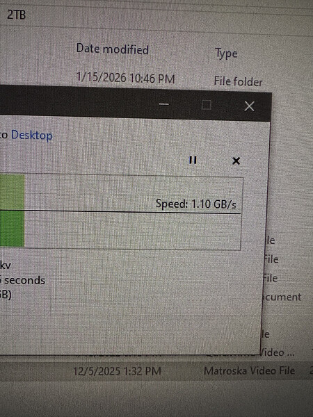

Now i have Smb Multi channel activated, but i get not optimal preforence in ZimaOS
transfer files from ZimaOS Server i get max 1.03GB speed
This is tranfer file to ZimaOS to PC then i get max 1.65GB speed
and some time it fall down to low speed
So SMB multi channel in ZimaOS is very unstable

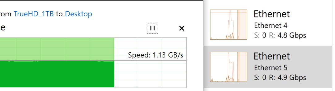

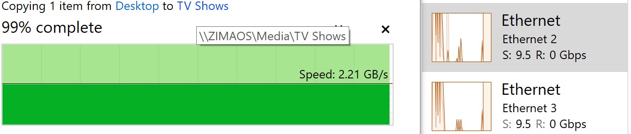

But when i boot from Truenas server with same Server pc and windows10 PC
I get this result
File transfer to TruenasServer i get Full 2.20GB speed :slight_smile:
But when i transfer files from truenas i get low speed :frowning:

Thanks for detail reply. My SMB Multichannel is working now. Thanks to Joffer I have change subnet ip on one nic in ZimaOs and Windows 10 and now it working but not optimal. I post result later
Ok after i change my static ip adress from 192.168.1.190 to 192.168.2..190 In ZimaOS
File transfer from ZimaOS to Win10
File transfer to ZimaOS from Win10
But in TrueNas i get little better result with same Pc and Server
This is from Truenas to Win10
This is from Win10 to Truenas
So ZimaOS is litte slower transfer. I dont know why. Because is exactly same Pc and ServerPC. But now Multichannel works :slight_smile:
Finally made it :hugs:
After swaping nic cards from Server pc to Win pc I now get full speed both ways :slight_smile:
Windows to ZimaOS
ZimaOS to Windows
I have swap nics before but it did not work. Now SMB Multichannel works optimal because I changed the IP address.
Thanks to everyone who tried to help me :slight_smile:
