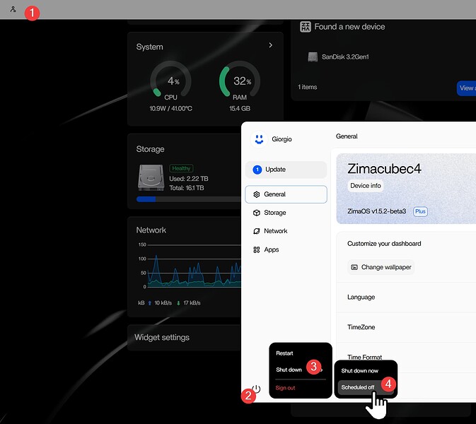

Normally, this can be done by RTCWAKE on Linux, but you still need to do some research beforehand. ZimaOS already has rtcwake built-in. You can refer to the following tutorials: https://ostechnix.com/automatically-wake-linux-system-sleep-hibernation-mode/
I tried using the Zimaboard’s scheduled shutdown, but after shutdown, it loses the schedule memory. Is this normal?
