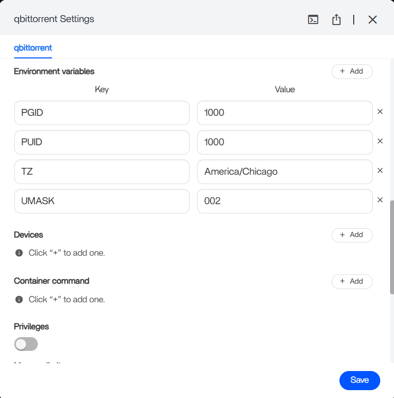

Before changing anything else, can you post a screenshot of the Environment Variables section of the qBittorrent container configuration (feel free to blur any keys/passwords)?
I suspect qBittorrent may still be configured for its own VPN mode rather than simply using Gluetun’s network, and that will tell us exactly which setup is currently active.

Thank you for the clarification. I think you’re on the right track because my Environmental Variables don’t contain any keys or passwords.

Thanks, that screenshot helps.
I don’t see any VPN-related environment variables in qBittorrent, which is actually good news because it suggests qBittorrent isn’t trying to manage its own VPN connection.

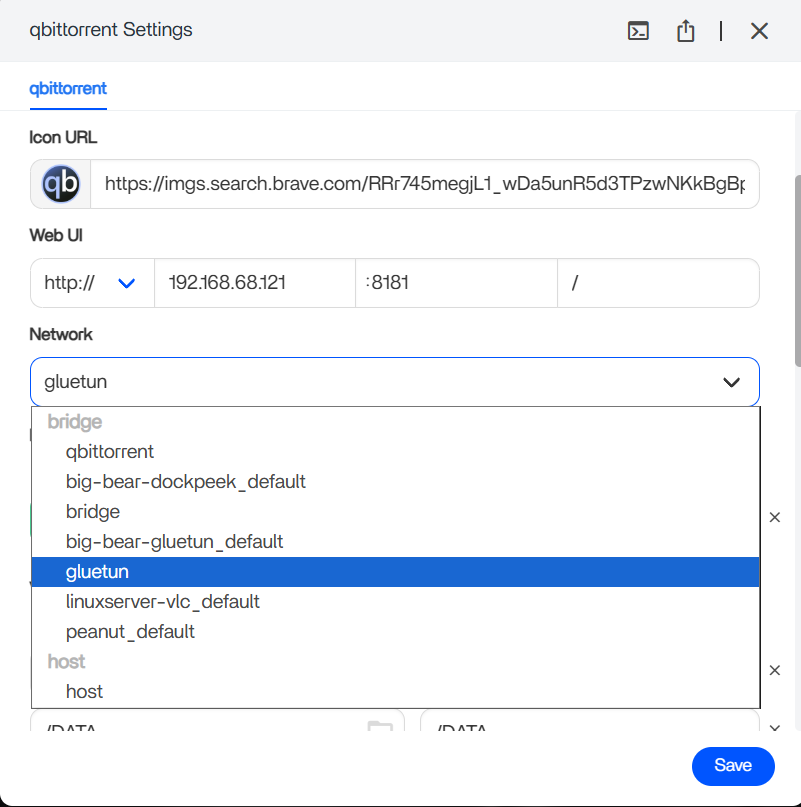

Can you post a screenshot of the Network section from the qBittorrent container settings (the same page where you selected gluetun from the dropdown)?
I suspect the container is attached to the gluetun Docker network, but not actually using network_mode: service:gluetun, which would explain why downloads work but appear to bypass the VPN.

The dropdown also contains a “big-bear-gluten_default” choice, I chose that one first but qBittorrent wouldn’t even start with that one selected. Choosing “gluetun” allowed me to actually open qBittorrent. I suspect there are 2 gluetun choices because of the docker compose method that I also tried.
That screenshot explains quite a lot.
The Network dropdown in ZimaOS is selecting a Docker network, not necessarily telling qBittorrent to share Gluetun’s network stack.
So seeing:
  • bridge
  • big-bear-gluetun_default
  • gluetun
simply means Docker networks exist with those names.
I believe your suspicion is correct: the extra big-bear-gluetun_default network is likely left over from the Compose deployment you tested earlier.
The interesting part is that qBittorrent starts and downloads successfully on the gluetun network, but still only sees lo and eth0. That suggests it’s connected to the same Docker network as Gluetun, not necessarily routing through Gluetun itself.
Before we chase ghosts, the easiest test is to check the public IP from inside the qBittorrent container. If it matches the VPN IP shown in the Gluetun logs, you’re done. If it matches your ISP IP, then qBittorrent is bypassing the VPN.
At this point I think we need to verify the actual IP path rather than relying on interface names or container logs.

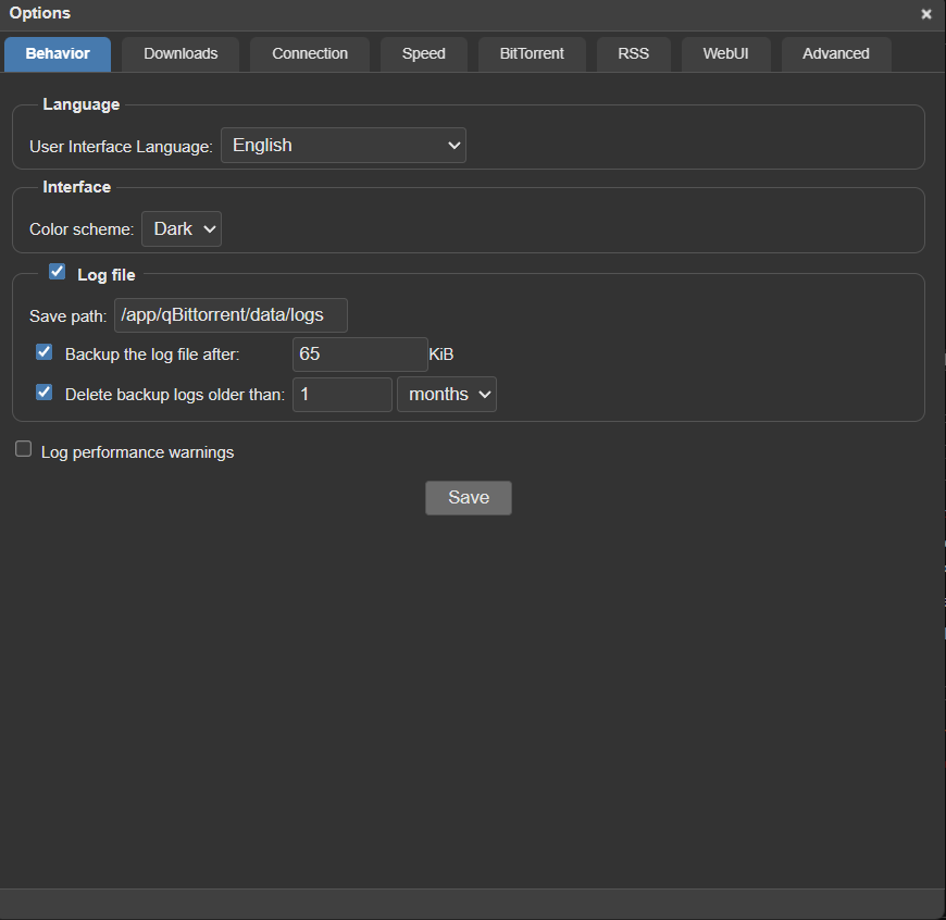

Earlier today I had Googled how to check IP from within qBittorrent but the directions were wrong. It said it was in qBittorrent->Options-> Behavior tab at the bottom, but it is not…
What is the best way to check the public IP from inside qBittorrent?
The Google result is probably referring to an older qBittorrent version. Recent versions don’t show the public IP in the UI anymore.
