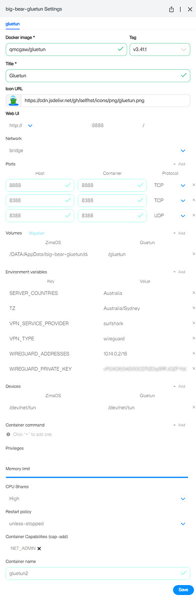

Final tip (very ZimaOS-specific)
If you “uninstalled” Gluetun but kept the old container name or network, the UI sometimes gets stuck.
Fix: change this:
container_name: gluetun
to:
container_name: gluetun2
Import again, if that works, it confirms ZimaOS had a name conflict.
If you want, paste what exact error ZimaOS shows during “import” (even just screenshot text), and I’ll write the exact corrected compose that will definitely deploy on ZimaOS.
Shoot. I didn’t realize that about the private key. Considering I can’t edit my previous post, I revoked the key from my account and got a new one.
But great news! Your solution worked! It seems like Gluetun is running now!

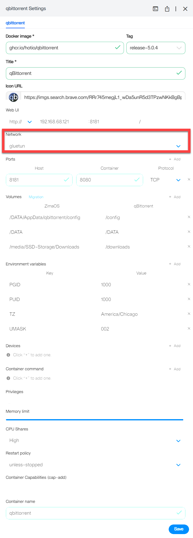

Thank you so, so much! I followed your steps, and it seems to be up and running with qBittorrent now as well.

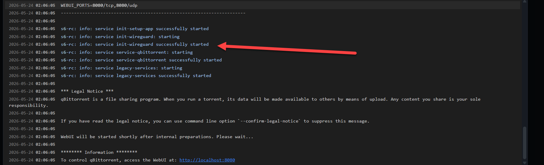

The logs seems to be doing an odd thing where they refresh, but it doesn’t seem to be interfering with the actual network, and each time it refreshes, it says the connection is successful.
Here’s the log
Log

network_mode: "service:gluetun"
qBittorrent is also routed through the VPN.

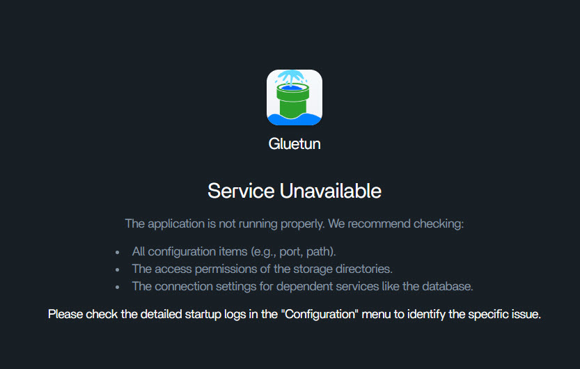

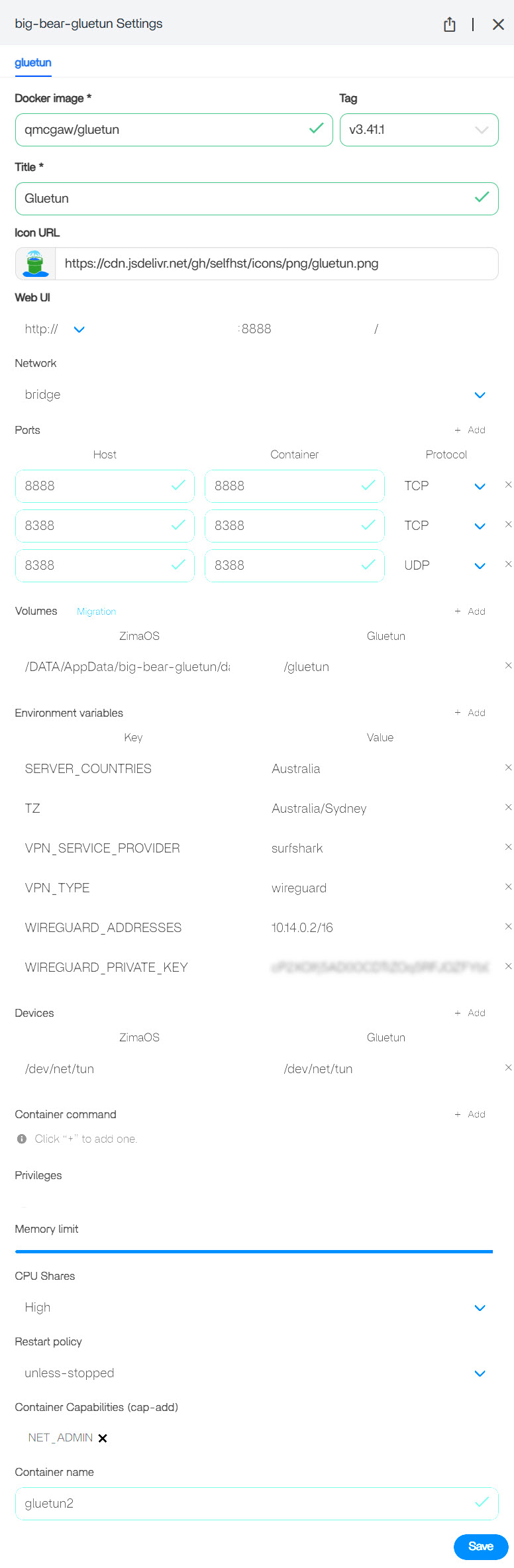

I too have been trying to get Gluetun up and running (for the purpose of eventually trying qBittorrent). I am not importing a compose file but rather trying to setup the container app from the App Store. (Though I tried that too with the same results)
When I saved my container settings I was met with “container gluetun2 is unhealthy”
2026-05-23_18-10-54
Not sure exactly sure where I’m going wrong. I use Surfshark and included my private key and VPN server IP address provided by Surfshark in my settings.
When I run the logs for Gluetun it says…
“Wireguard settings: private key is not set”
2026-05-23_19-14-17
I have added the key but I seem unable to generate a key without the “=” character.
You mentioned earlier in this thread that this could be problematic?
Any suggestions or direction would be greatly appreciated.

I tried yet another Private Key and I DO believe from the logs that it IS running…
Running version v3.41.1 built on 2026-02-11T14:22:29.184Z (commit 7f22fb3)

But when I try to open Gluetun I get the following…
Is this normal?
From the logs you’ve posted, I actually think Gluetun is working correctly now.
The important lines are:
Private key: aNF...nc=
and:
Public IP address is 149.88.101.18 (Australia, New South Wales, Sydney)
That tells us Gluetun is reading your WireGuard key and has successfully connected to Surfshark.
The = character is normal in WireGuard keys, so that doesn’t appear to be causing a problem.
As for the “Service Unavailable” page, I believe that’s expected. Gluetun is primarily a VPN container and doesn’t provide a normal web UI like qBittorrent, Sonarr or Radarr. The ZimaOS tile can still show an “Open” button, but there isn’t really a user interface behind it.
Based on the logs, I would focus on whether applications routed through Gluetun can access the internet rather than whether the Gluetun tile opens successfully.
From what you’ve posted so far, I believe the VPN tunnel itself is up and running correctly.

As far as routing applications through Gluetun, take qBittorrent for instance, is it just a matter of selecting “gluetun” in the Network dropdown of the qBittorrent container settings?
I have qBittorrent setup and running, but not quite sure how to test what IP address its using (VPN or ISP)

Yes, based on your screenshot, selecting “gluetun” in the Network dropdown is exactly what I’d expect if you want qBittorrent to share Gluetun’s network stack.

But when I run the qBittorrent logs it says “VPN_ENABLED=false”

Looking at your screenshot, can you confirm:
  1. qBittorrent was completely restarted after changing the network to Gluetun?
  2. The Gluetun container was already running and healthy before qBittorrent started?
  3. In Docker/ZimaOS, does qBittorrent show it is attached to the gluetun network, or is it still attached to the default bridge network as well?
If qBittorrent is truly sharing Gluetun’s network stack, I’d expect to see the VPN interface available inside the container. Right now the logs suggest qBittorrent is still using its own normal network namespace.
Can you post a screenshot of the qBittorrent network settings page and the container summary page after saving the network change? That should reveal what’s being missed.
Yes for both 1 and 2.
Not entirely sure about 3. Other than the qBittorrent settings I posted earlier, I’m not sure where else to look and check to see if it is actually attached to the Gluetun network or not.
The logs for qBittorrent show that Wireguard successfully started…
