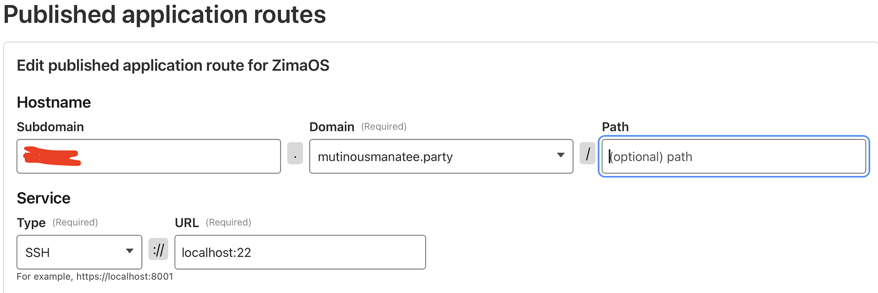

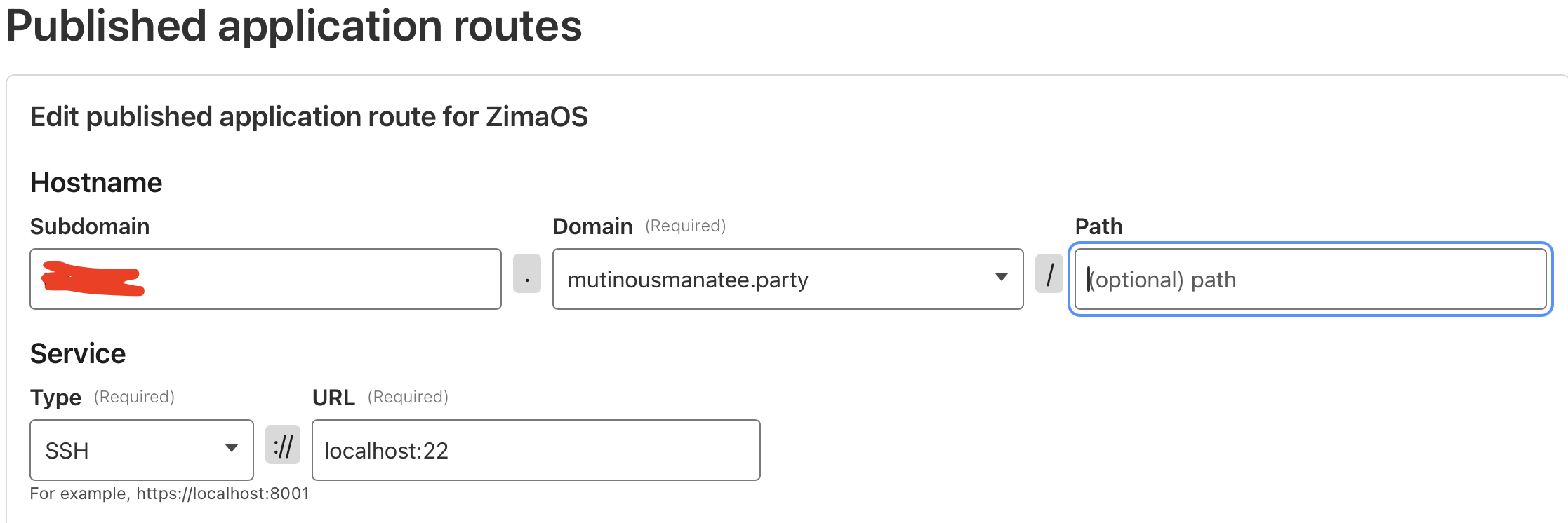

I currently have all containers configured through Cloudflare Tunnels for remote access. But I’ve not been able to get Cloudflare working to access my ZimaCube via SSH.

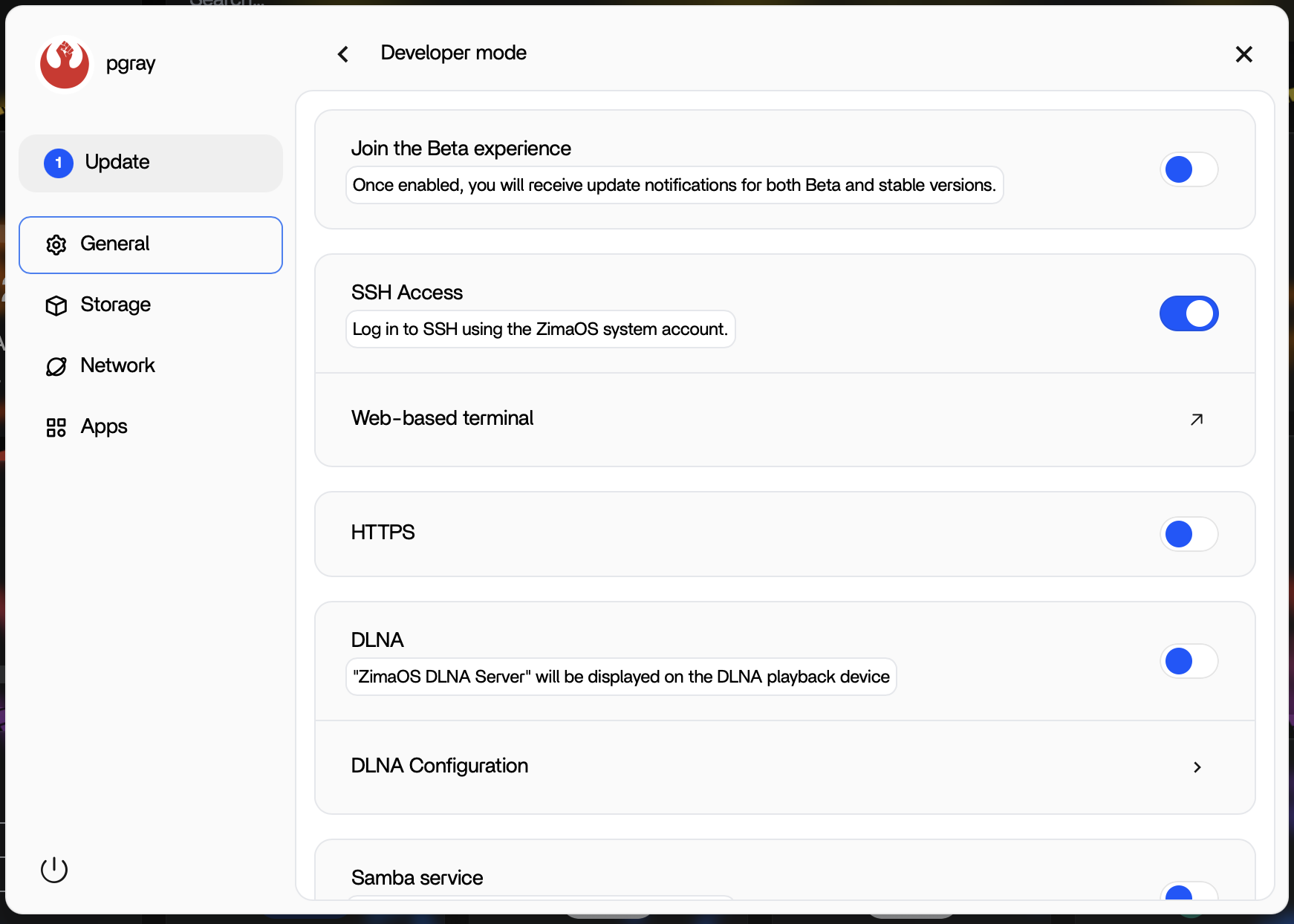

I’ve enabled remote SSH in Developer Settings in ZimaOS, am able to login on the Zima SSH web client or by connecting directly to ZimaCube’s local IP, but cannot get it to connect through Cloudflare (it eventually times out).

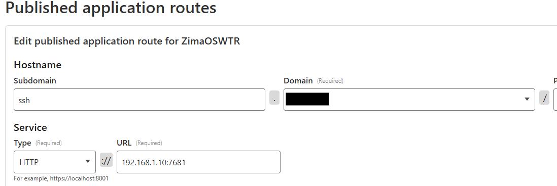

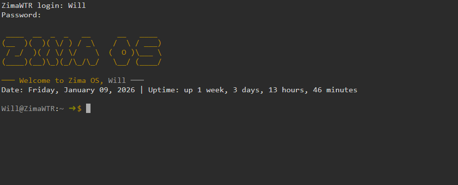

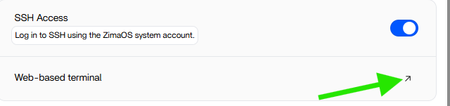

Native SSH will not work through Cloudflare without having a client on the computer you are trying to SSH from. But there is a solution. Where you enabled SSH, there is an arrow to lanch the web SSH app, This works through cloudflare. Set it up as an app route there.
It opens to http://192.168.1.10:7681 (your servers ip) Set that up in Cloudflare
If you need it bigger you can use the browser zoom function to increase it.

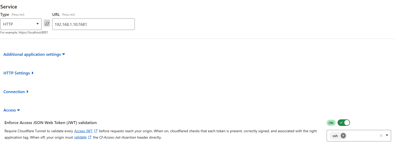

Another thing I suggest is setup authentication to use Cloudflare. I have one time use email auth, and Sign in with Google working with it now even for services that require a login too. Use their quality blocking of bad actors as a first line of defense.

I believe this is timing out because your tunnel route is set to localhost:22.
If cloudflared is running in Docker, localhost means inside the container, not your ZimaCube host, so the tunnel can’t actually reach SSH.
I suggest either:
  • run the cloudflared container in network_mode: host, then localhost:22 works, or
  • change the route target from localhost:22 to your ZimaCube LAN IP like 192.168.x.x:22.
