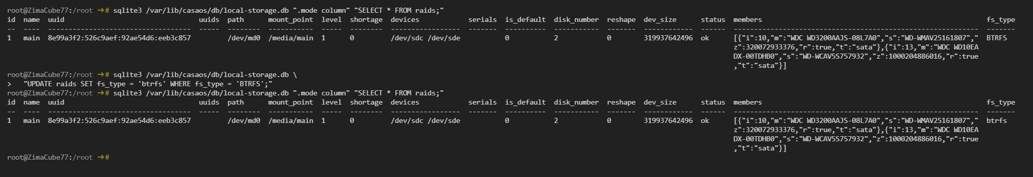

We have troubleshoot that the cause is that the value of the database fs_type is capitalized, causing the mount to fail, and it is expected to be fixed in the next release.
At present, you can run the following command on the command line to solve the mount failure problem , and you need to restore fstab manual.
sudo sqlite3 /var/lib/casaos/db/local-storage.db “UPDATE raids SET fs_type = ‘btrfs’ WHERE fs_type = ‘BTRFS’;”
Apologies for the delay. This indeed fixed the issue.
Thank you!

I’m on 1.5.4 but the error stills the same…
Hi, please run the following command, then go to Files to find the diskinfo.log file, send it to us, if you can, please describe the phenomenon you encountered, except for raid not mounted, is there any other problem?
curl -fsSL https://get.casaos.io/diskinfo.sh | sudo bash
