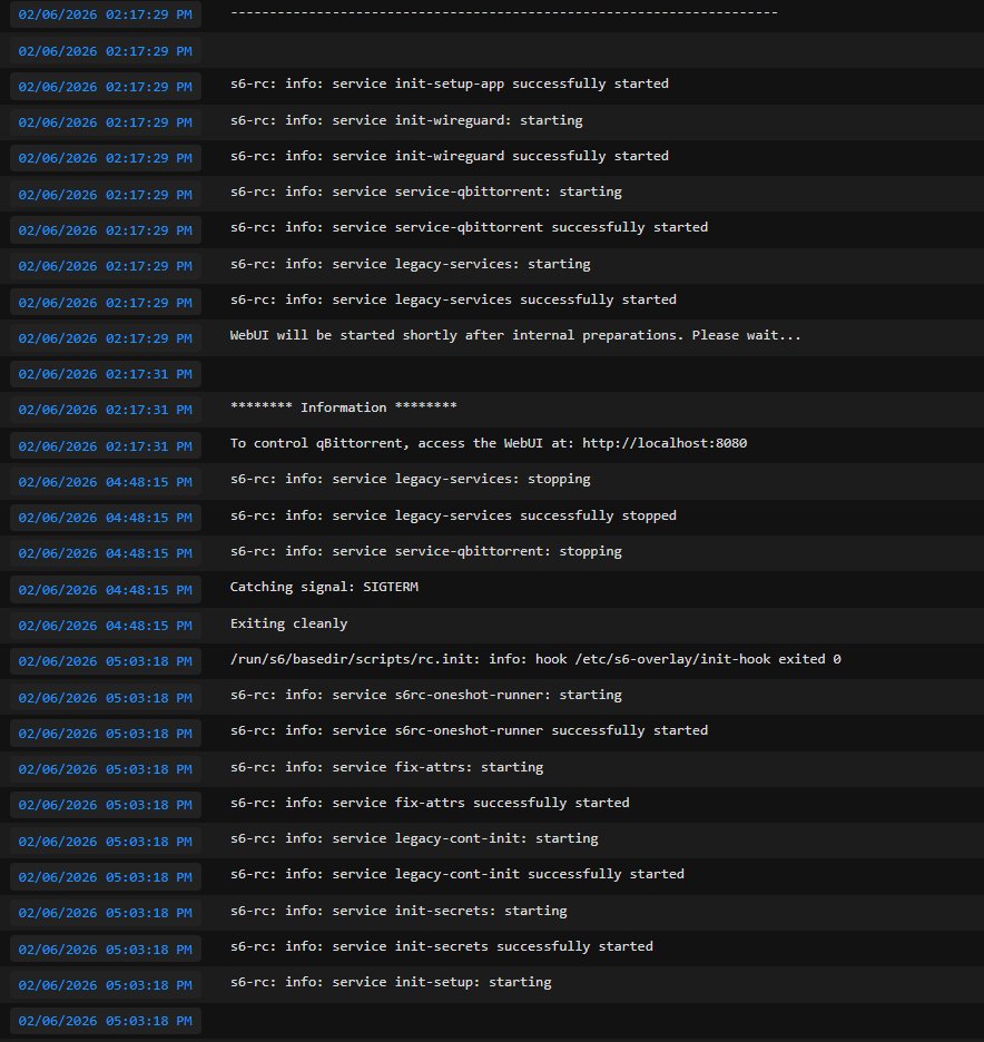

Zero meaningful logs are being generated, the container just runs into a “zombie” state and gets completely unresponsive after a few hours.
Logs:

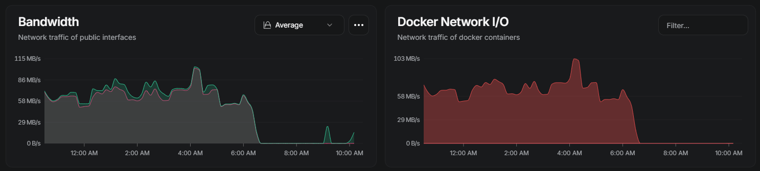

Zero network traffic when the container crashes:

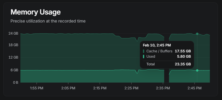

I have also noticed an abnormal cache allocation to RAM, where the system is just using 6GB of RAM but for some reason ZimaOS is caching 4x times that. The VM has 32GB of RAM allocated to it:

After a few hours of sustained network and disk activity, the qBittorrent container stops responding. Network traffic drops to zero instantly, but the container stays in a “running” state. When you try to stop or remove it, Docker fails with the familiar “tried to kill container, but did not receive an exit event” error.
