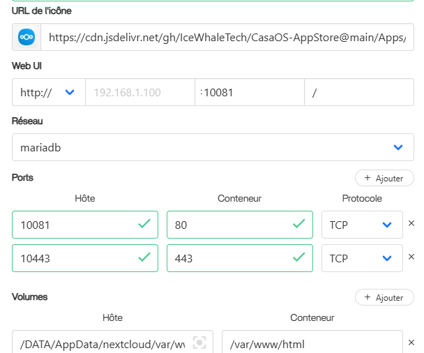

-I installed Nextcloud :
i changed my casaos UI port to 90 (not in conflict wirth port 80 of NGINX)

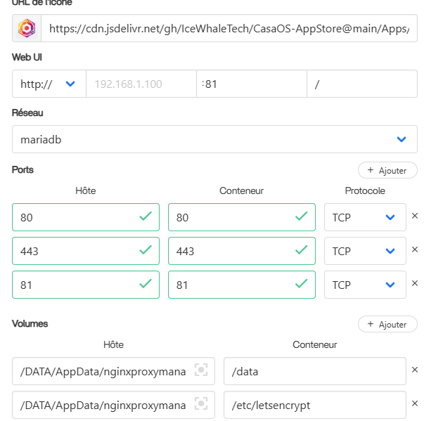

-I installed NGINX :

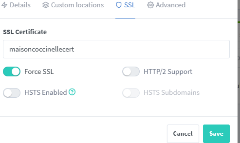

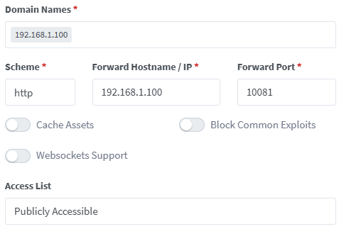

On NGINX UI, I created a Proxy Host :
I imported the certificate and set up the proxy host to use it like this :
