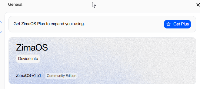

I have a snapshot of the VM that i can go back to. It has all my config and apps, with zimaos v1.5, plus enabled.
Is there a way for me to expand the storage now, and still keep the Plus ?

Another slot should be the last version you upgraded from.
We are talking about the status in snapshot: you have upgraded only once to ZimaOS 1.5.0, the status in snapshot, and never upgraded afterward, right? If so, then you switch, you go back.
It worked. Thanks for the tip. I’m on v1.5 with Plus, with a notification showing 1.5.1 is available. I will update to that another time. Have a good day!
