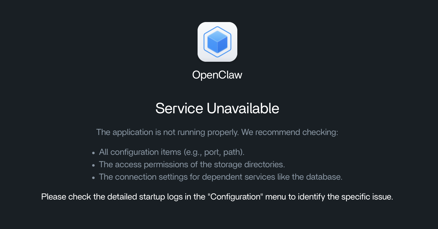

OpenClaw Service Unavailable
According to OpenClaw App, “The application is not running properly”. According to Tips, Generate a secure gateway token using: openssl rand -hex 32. Set OPENCLAW_GATEWAY_TOKEN in your environment before starting”. Any idea for setting the configuration items?

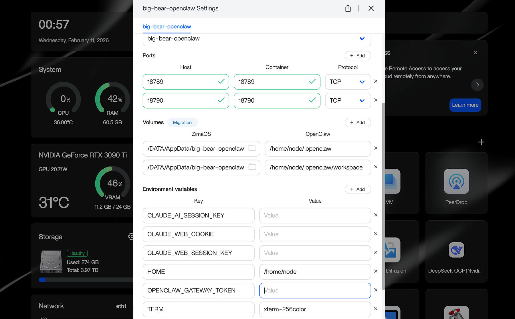

If they installed via CasaOS UI:
  • Open the app
  • Go to Settings → Environment Variables
  • Add
    OPENCLAW_GATEWAY_TOKEN = <generated token>
  • Save and restart the app

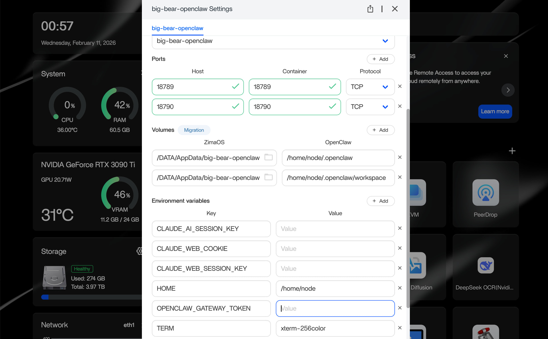

However, when I tried to open the settings page of the OpenClaw app on CasaOS, I couldn’t find a button to generate a token. Is there another way to generate the token?
I would greatly appreciate it!

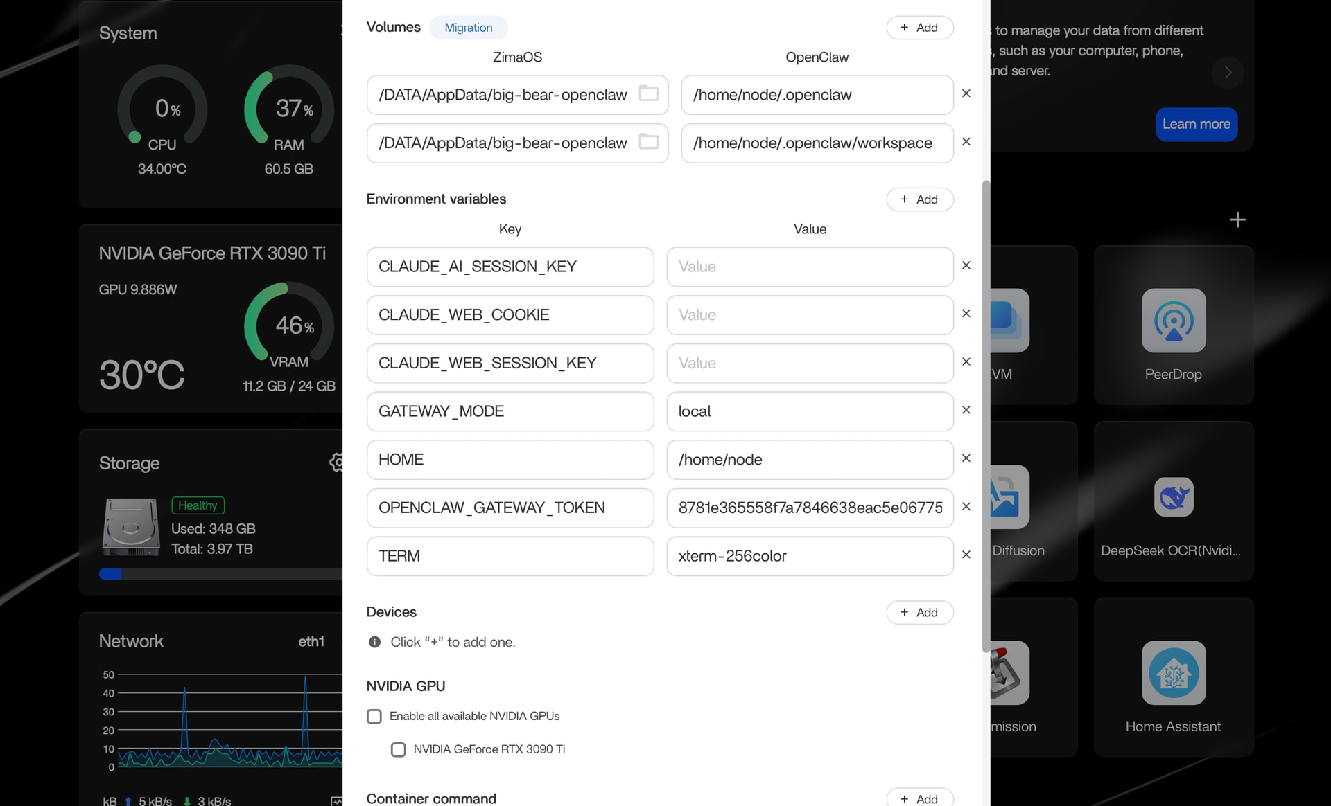

Then in CasaOS:
OpenClaw → Settings → Environment Variables
Set:
OPENCLAW_GATEWAY_TOKEN = <your_generated_token>
Save → Restart the container.

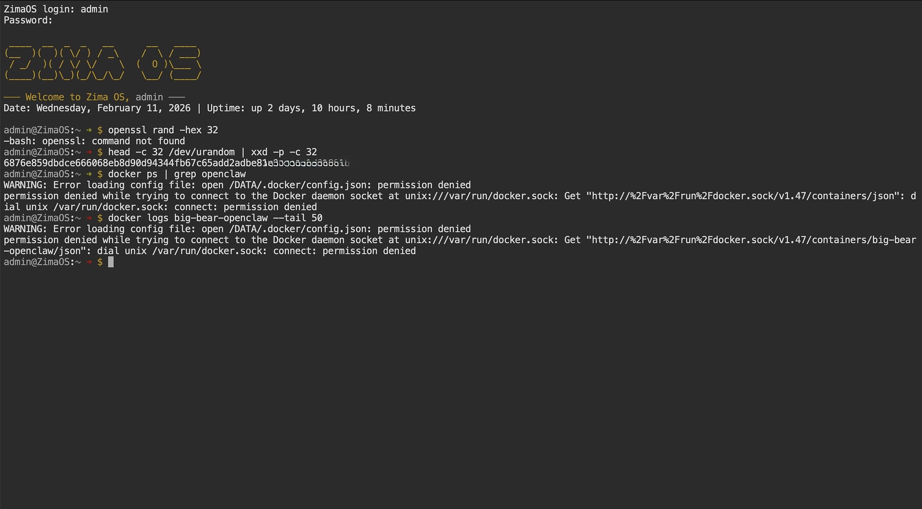

I have generated the token and pasted it into the appropriate field. However, the error still persists. The error message shows “Permission Denied.”
I believe this should be the final step, and I feel like I’m almost there. Could you please advise how to resolve this issue? I would greatly appreciate it!
Good, this is not an OpenClaw issue.
Your screenshot shows:
permission denied while trying to connect to the Docker daemon socket
/var/run/docker.sock: connect: permission denied
That means you are running Docker as admin, but that user does not have permission to access Docker.
On ZimaOS you must elevate first.
Run:
sudo -i
Enter your password.
Then verify Docker works:
docker ps
If that works, now check OpenClaw:
docker logs big-bear-openclaw --tail 50
If sudo -i fails, then check whether your user is in the docker group:
groups
But normally on ZimaOS, sudo -i is the correct method.
The “Permission Denied” you’re seeing is host-level Docker access, not the container itself.
Once you can run docker ps without error, we can inspect whether OpenClaw is actually starting or exiting.

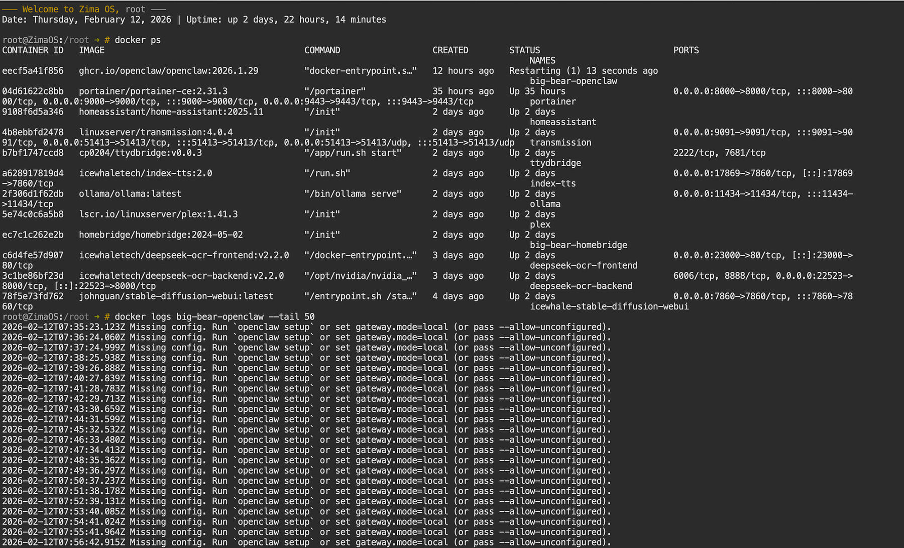

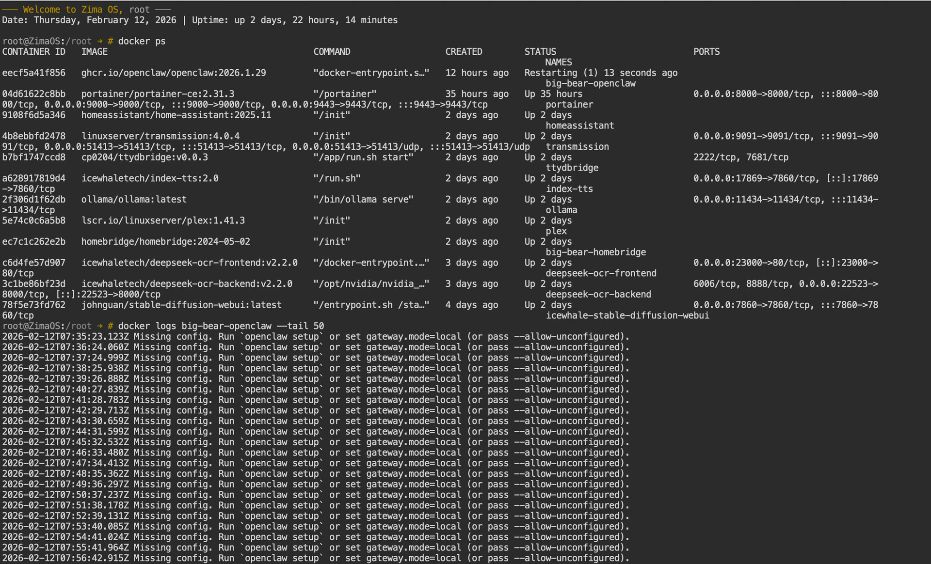

I have entered all the steps as code, and the current message shows:
“Run openclaw setup or set gateway.mode=local (or pass --allow-unconfigured)”, and there are about 50 lines in total.
I believe the light at the end of the tunnel is just ahead.
Perfect. Now we have the real issue.
Your logs show:
Missing config. Run `openclaw setup` or set gateway.mode=local
So the container is restarting because it has no configuration yet.

CasaOS → OpenClaw → Settings → Environment Variables
Add:
GATEWAY_MODE = local
That satisfies this requirement:
Alternative (not recommended unless testing):
ALLOW_UNCONFIGURED = true
But GATEWAY_MODE=local is the proper solution for a standalone install.

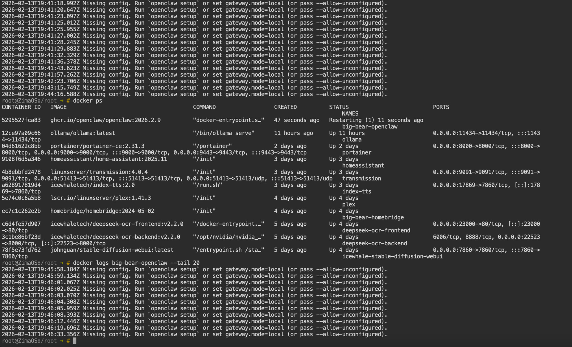

I’ve tried every possible method, even reinstalling the OpenClaw app via CasaOS. At the moment, it still appears to be looping and continues to show that it needs to “set gateway.mode=mode.”
Is there something else that might still be configured incorrectly? Thanks!

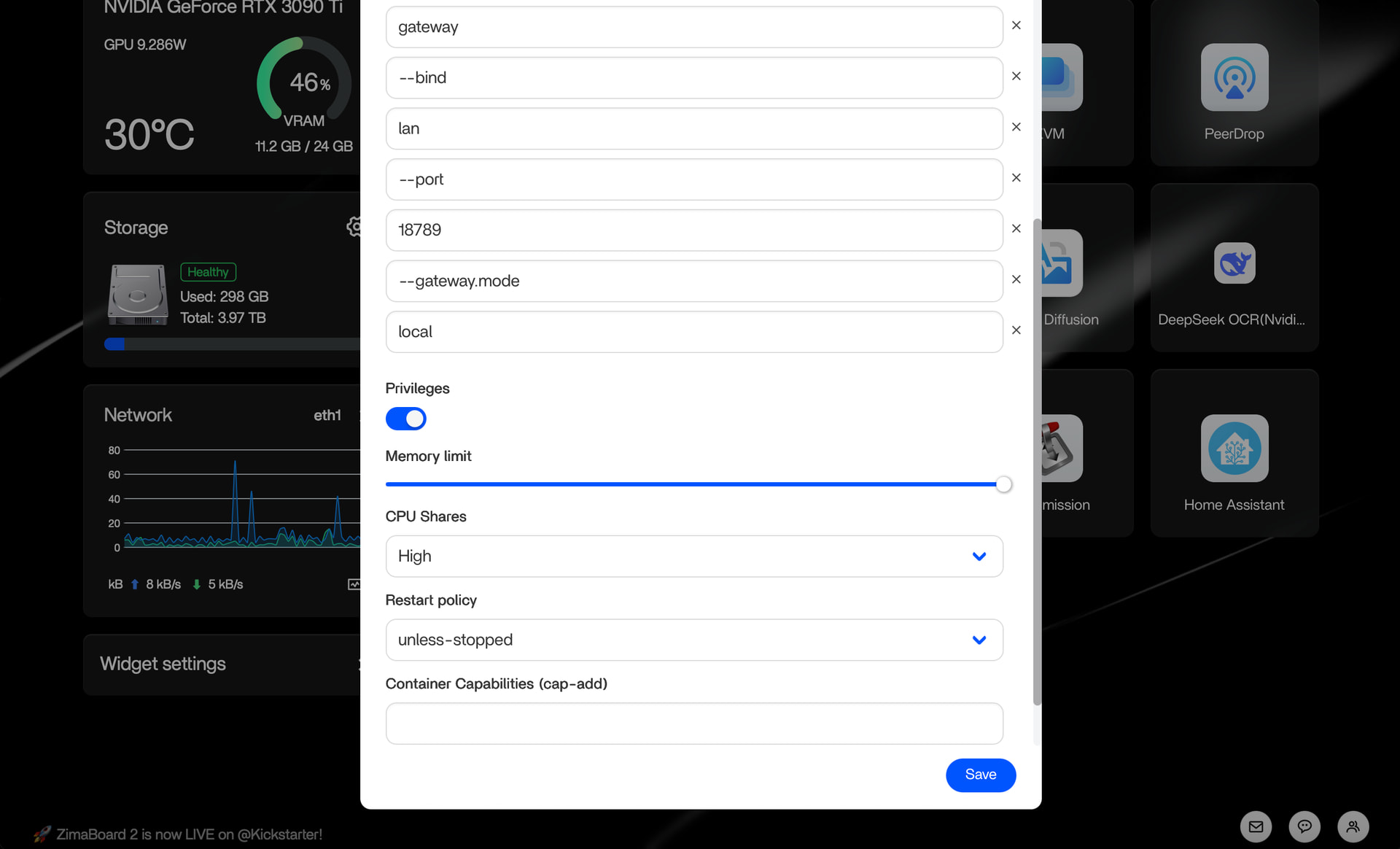

Do this only:
CasaOS > OpenClaw > Container command
Add:
--gateway.mode=local
Save > Restart.

I’m doing my best to follow everything correctly.

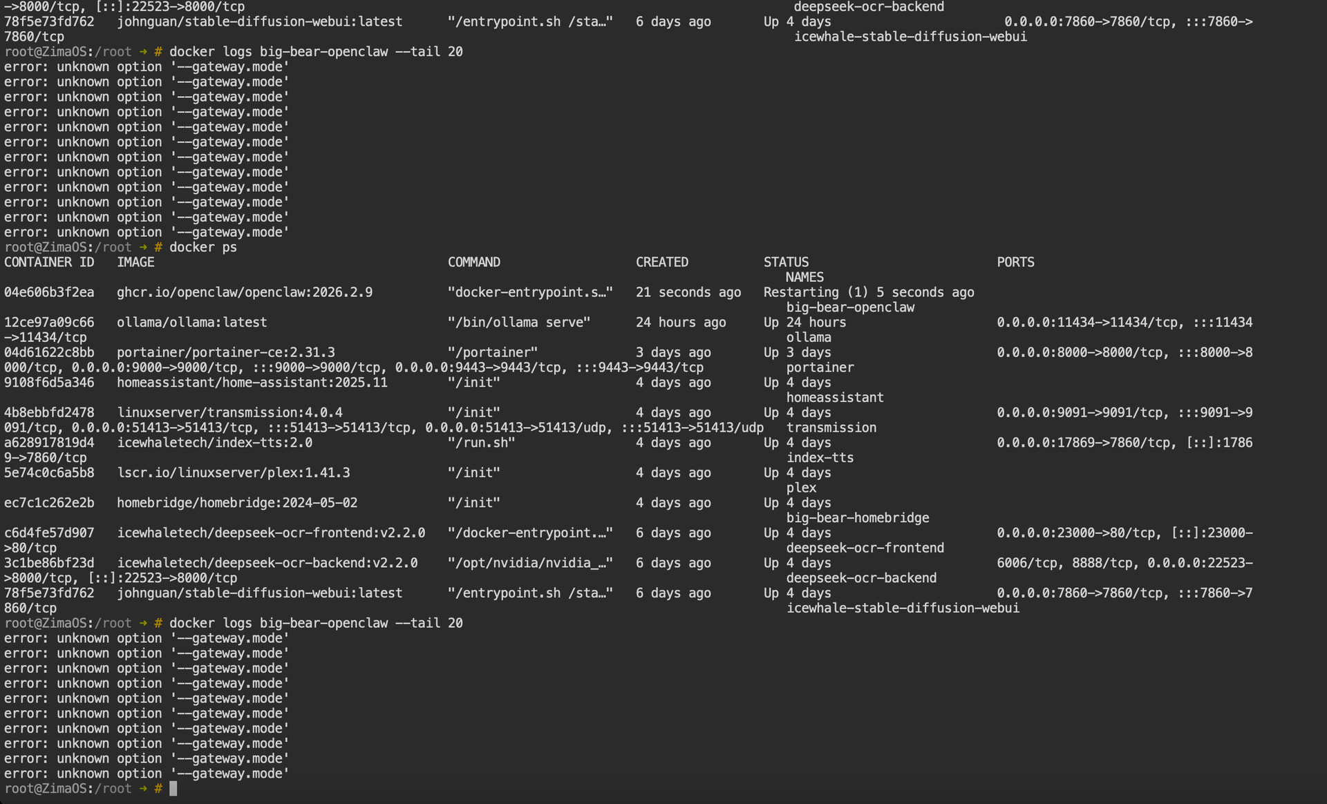

I’ve added “–gateway.mode=local” to the container command as instructed, but it still returns an error. This time, the error message says: “unknown option ‘–gateway.mode’.”
Thank you for helping clarify this—hopefully this is truly the final step. Thanks again!
Good. Now we see exactly what happened.
The error:
unknown option '--gateway.mode'
means the flag is being passed to the wrong binary.
Your container command shows this structure:
gateway
--bind
lan
--port
18789
--gateway.mode
local
That tells us the entrypoint is already calling something internally, and CasaOS is appending your flags to the wrong layer.
