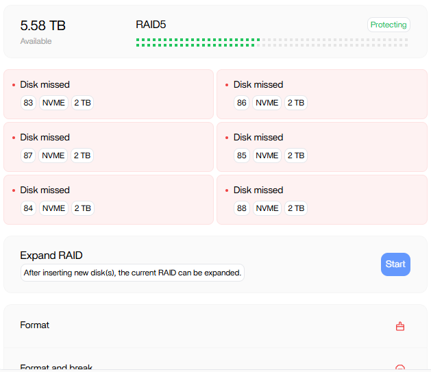

I have both Raid 0 and Raid 5 pools that are accessible via the dashboard and smb. I was initially using zimaos 1.4.2 and have updated to 1.4.3 with no change. Although I can read / write to the NVMEs I would like some information to verify the condition of my SSDs

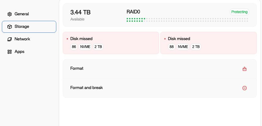

I have installed zimaos on the eMMC and have populated the ssd bays with 6 nvmes, none of which are recognised correctly in the dashboard. However both my raid 0 and raid 5 pools are working. The SSDs are sharable via smb including as time machine backup disks, and I have installed plex and syncthing with no issues.
I have since discovered that the nvmes are correctly identified in the local-storage.db file in the casaos database folder on the system drive. So I would hope that it is all working under the hood but I would not trust it in it’s current form for any really vital data. So I’m hanging on to my old WD NAS a little while longer!

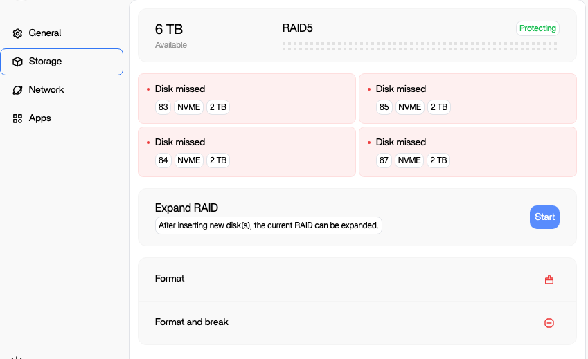

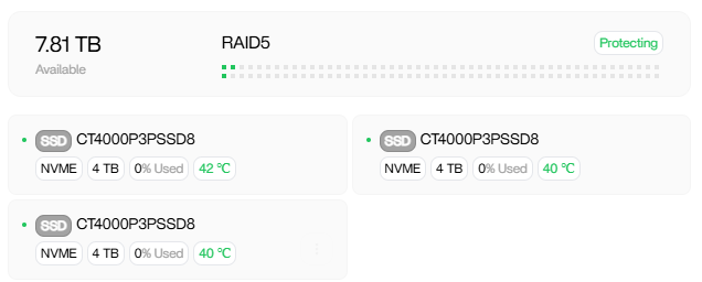

The dashboard does not recognise any of my nvmes and in the case of the RAID 5 pool it does not recognise the amount of data written. Although 500GB has been written to the RAID 5 pool the dashboard suggests that the pool is empty with a full 6TB available (refer to screenshot above). When I access the same pool via SMB, MacOS indicates that there is only 5.5TB available which makes more sense. So my impression is that the implementation of the dashboard requires more work. I have already shared some of my configuration files with @Zima-Giorgio and am willing to pass them on to you via DM. I do not share remote access credentials and passwords as that would defeat the object of having my own private server

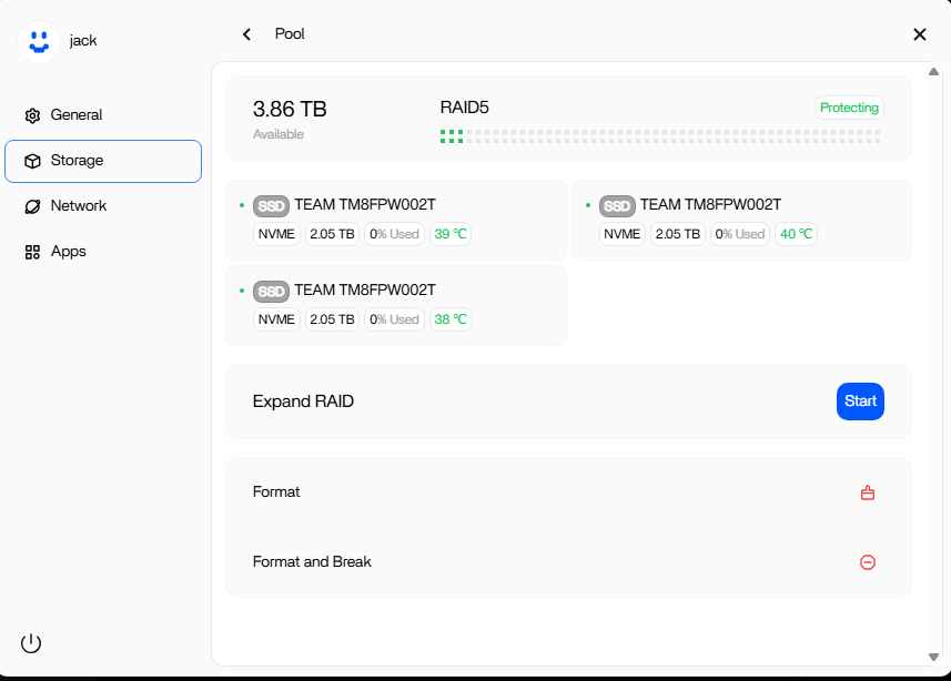

Same issue for me also. A new install on 1.4.3 on a Beelink ME Mini as of today and have the exact same failure to identify the drives - at least in the UI. The drives have initialised as a RAID 5 set ok and now have data on them.

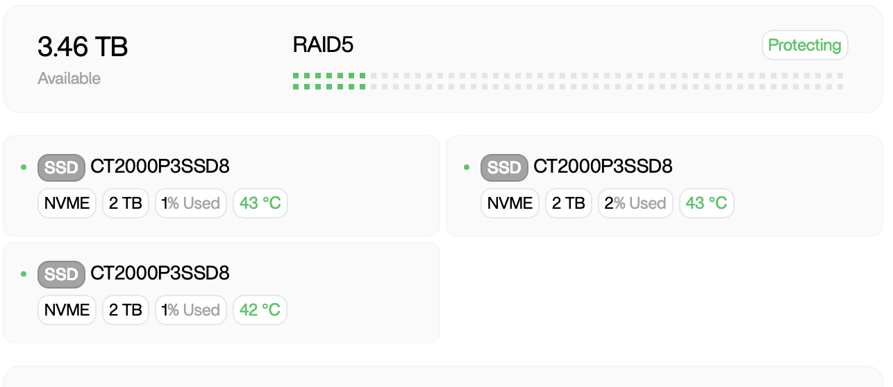

I had the same issue with Beelink ME mini, but found the following thread, and fixed the problem:
Thanks, that fixed it for me (although I used nano not vi :slightly_smiling_face: )

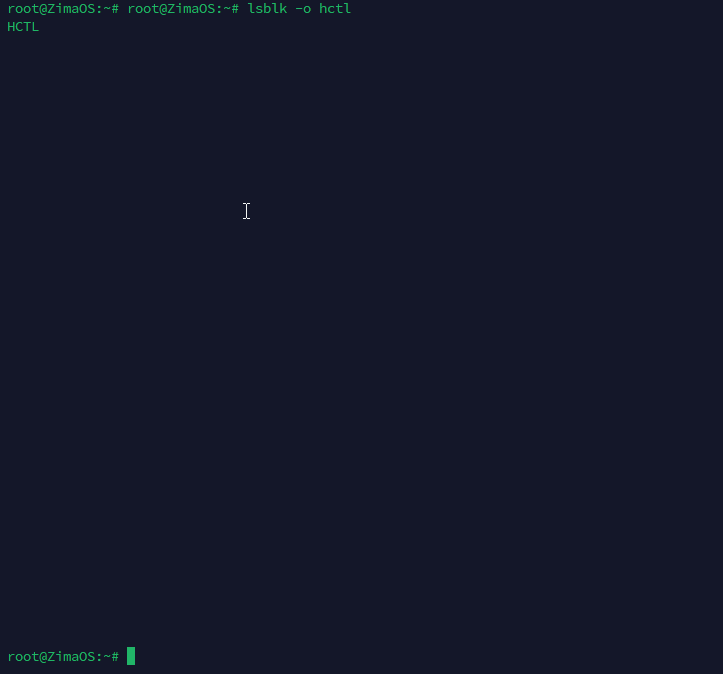

When i try to follow the instructions from the above post - How to Resolve Disk Display Issues on Non-ZimaCube Devices
I get no result for lsblk -o hctl
There are two set of instructions in that post, the first is for SATA drives, the second is for NVME drives, this is the bit you will need.

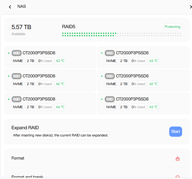

For me I changed the four drives in the conf file were setup as :
0a,0b,0c,0d (plus the other descriptors),
when I ran the command line from the instructions it showed that these needed changing to: 03,04,05,06 (even though I only had 3xNVME drives).
Once changed and restarted as per the instruction the drives showed up correctly as per my screen shot in the previous post.
Ooops thats quite embarrassing, it clearly states the difference in the 2 drive types in that post :man_facepalming:
Thank you very much for that prompt response, problem is now solved.
