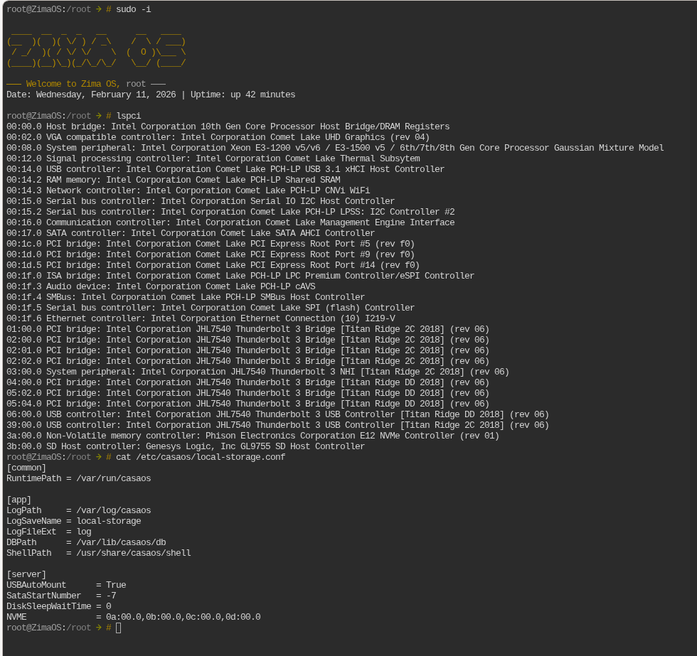

Your NVMe is detected by the system.
lspci shows:
Phison E12 NVMe Controller (3a:00.0)
So this is not a hardware issue.
The problem is filtering.
In /etc/casaos/local-storage.conf:
NVME = 0a:00.0,0b:00.0,0c:00.0,0d:00.0
Your NVMe is 3a:00.0, not in that list.
CasaOS local-storage ignores devices outside the allowed PCI range and rewrites the config on restart. That’s why your manual edit doesn’t stick.
Before changing anything, please run:
lsblk -o NAME,SIZE,TYPE,MOUNTPOINT
nvme list
We need to confirm the block device exists (likely /dev/nvme0n1) and isn’t mounted or flagged as system.
If it appears there but not in the UI, this is a local-storage filtering issue, not a disk failure.

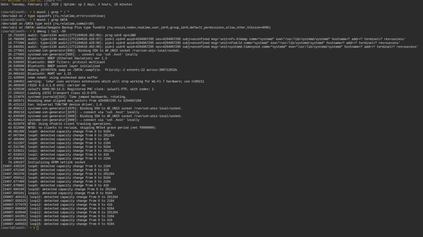

nvme list
Failed to open /dev/nvme0
Node SN Model Namespace Usage Format FW Rev
/dev/nvme0n1 0 0.00 B / 0.00 B 1 B + 0 B

Now confirm it is not mounted:
mount | grep nvme
If nothing returns, manually mount it to test:
mkdir -p /mnt/nvme-test
mount /dev/nvme0n1p1 /mnt/nvme-test
ls /mnt/nvme-test
If your files appear, the disk is fine.
At that point the issue is UI integration, not hardware.
Tell me if the manual mount works.
sudo mkdir -p /mnt/nvme-test
mkdir: cannot create directory ‘/mnt/nvme-test’: Read-only file system
It looks like your system has remounted itself read-only.
Please confirm first:
mount | grep " / "
mount | grep DATA
If you see ro in the mount flags, the filesystem is in read-only mode.
Then check for errors:
dmesg | tail -50
ZimaOS switches to read-only if it detects disk or filesystem issues.
Let’s confirm that before trying any more mounts.
This is expected behavior on ZimaOS.
The root filesystem / is squashfs and permanently read-only. That is why creating /mnt/nvme-test fails. It is not a system error.
From your mount output:
/dev/sda3 on / type squashfs (ro,...)
/dev/sda8 on /DATA type ext4 (rw,...)
/DATA is the writable partition on ZimaOS.
I believe the system is functioning normally.
I suggest creating the mount point under /DATA instead:
mkdir -p /DATA/nvme-test
sudo mount /dev/nvme0n1p1 /DATA/nvme-test
ls /DATA/nvme-test
If the files appear, the NVMe is healthy and this is simply a ZimaOS storage import/UI limitation — not a disk issue.
