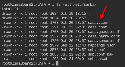

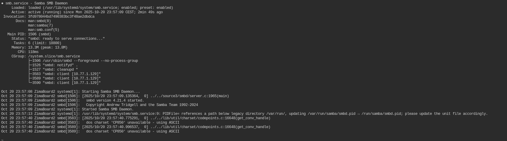

below pictures are from zimaOS via ssh
my computer is running arch linux with KDE and using dolfin filemanager.. it works great on my older shares on the network.. and windows.. but not ZimaOS
seems like there are some support missing for charset’s that from what i can read online should be there…
