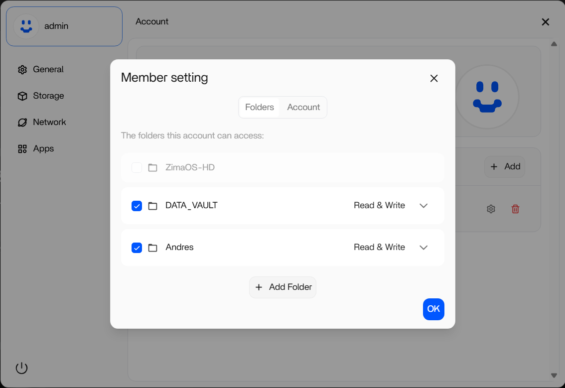

Hi, I’m new to ZimaOS.
I’ve just setup my os with an admin account and now I’ve made my own account which has all the same read and write privileges.

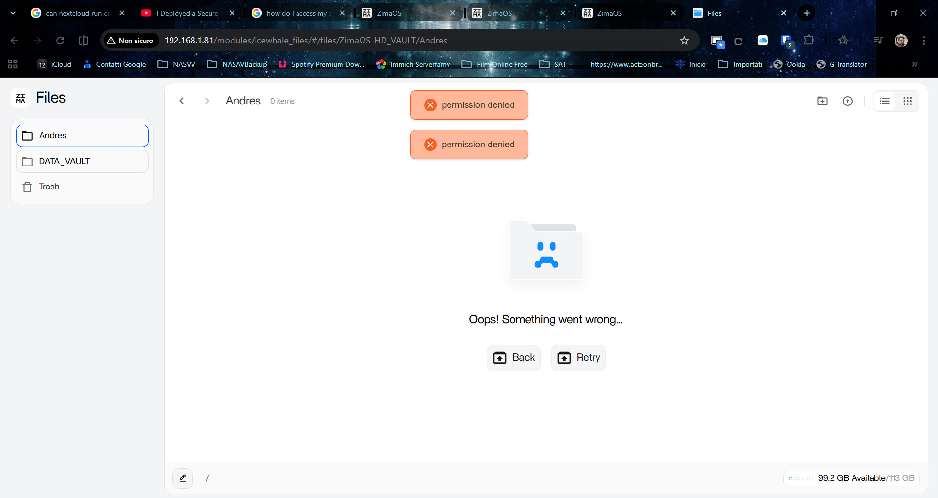

Is there a particular reason why it does this?
My NAS is literally empty, I haven’t installed anything so far and I can’t access my raid array or any folder at all without having that “permission denied” message from my own account.

From your screenshot, that path (ZimaOS-HD_VAULT/Andres) looks like a mounted or previously created storage location, not something created fresh by your new user. In those cases, ZimaOS user permissions don’t override the underlying Linux ownership.
So even if your user has read/write in the UI, the folder itself is likely owned by root (or another UID), which is why you’re getting permission denied.

Yes, admin (which is still me) has access to everything without errors and so far I’ve created only one more user (Andres, still me) that gets those errors.

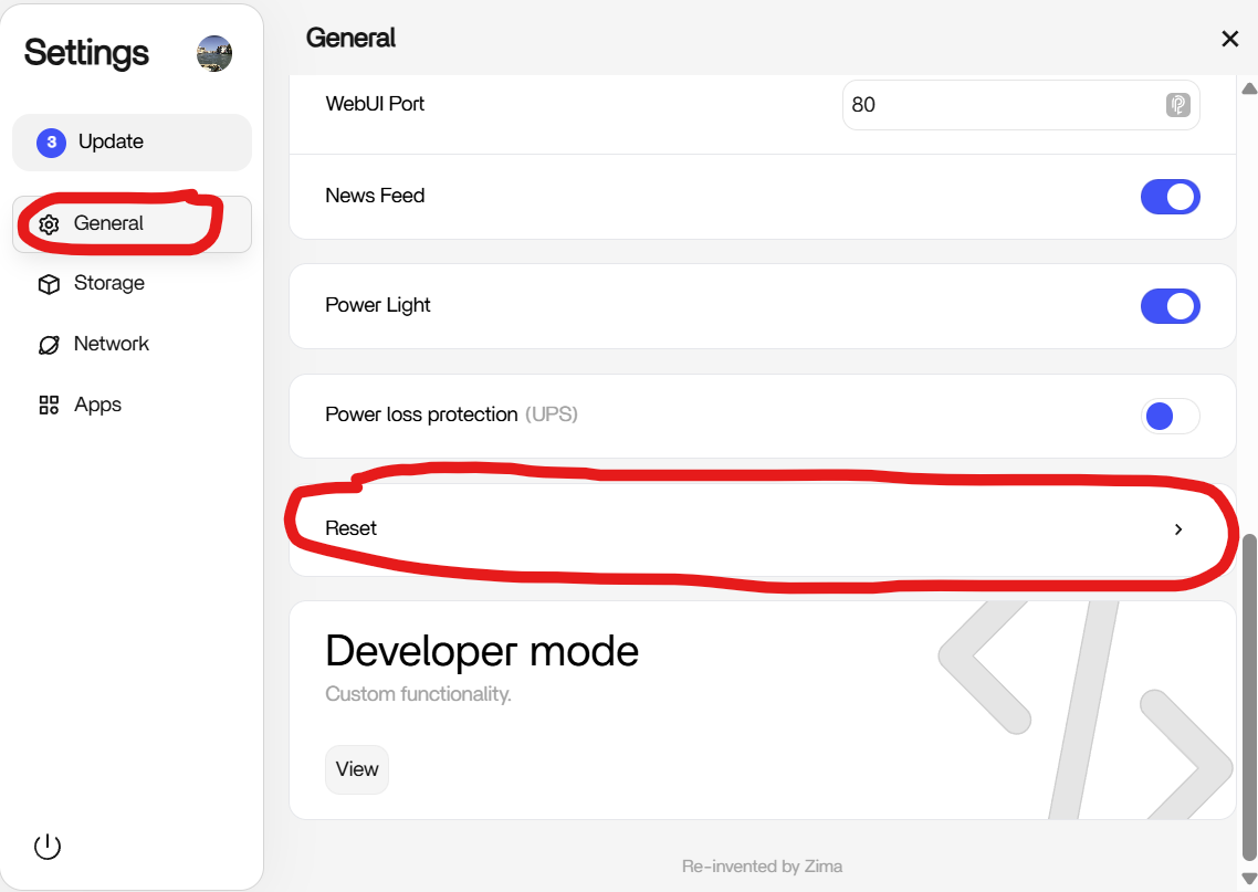

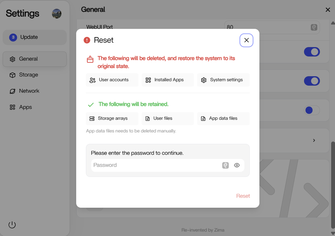

Yeah to fix this properly, the best option now is a full factory reset.
Go to:
Settings > General > scroll down > Reset
Run that and let ZimaOS reset itself back to a clean state.
It will:
  • remove all apps
  • clear AppData
  • reset users and permissions
With the failed migration and mixed permissions, this is the fastest and cleanest way forward instead of trying to fix everything manually.

Funny thing, that’s exactly how I migrated the first time

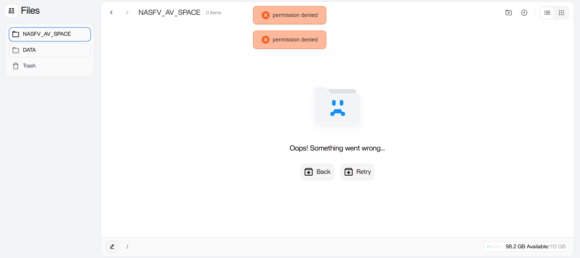

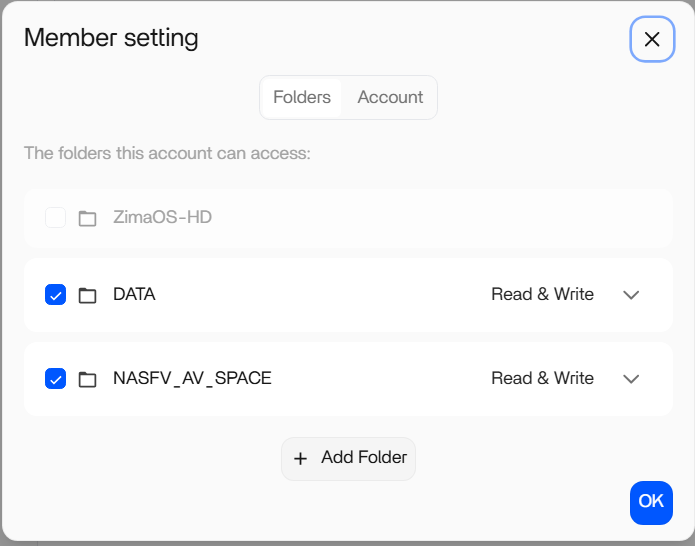

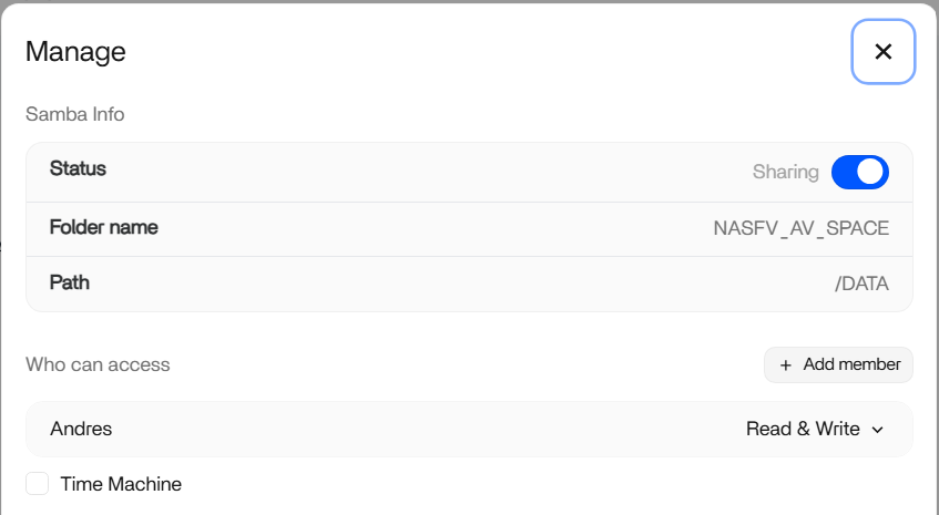

I just reset my nas (NASFV), matter of fact I format and installed a fresh copy of ZimaOS to be sure, I set it up with standard paths, (boot drive only OS and apps, /DATA is my raid), but now I’m trying to set up my shared folder /DATA/NASF_AV_SPACE to use with my personal account (Andres) and once logged in I still don’t have permission to navigate through my stuff.
Any suggestions please?
Yeah that’s actually normal.
The reset only wipes the system (apps, users, AppData), it doesn’t touch your storage. So ZimaOS will detect your drives again and those folders will show back up.
That doesn’t mean the reset failed, it just means your RAID is still there, which is what you want.

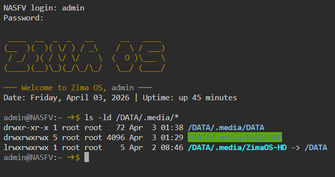

No, as I said I format everything to be sure, not reset. It’s a fresh install of ZimaOS, both boot ssd and raid have been formatted… I’m still scratching my head
Yeah that’s definitely not expected then.
If both the OS drive and the RAID were formatted, there shouldn’t be any old folders or permission leftovers coming back.
That points more to how the storage is being initialized/mounted rather than anything you carried over.
At this point don’t start migrating yet, keep it as clean as possible.
Can you just check one thing for me:
ls -ld /DATA/.media/*
If those folders are still showing as root root on a fresh install, then that’s the reason your user can’t access anything.
We just need to confirm that before touching anything else.

This is the result of your command line:
If you see a “NASAVBKP” in the list, it’s a separate NAS that recieves beckups only from my main nas and my father’s that has a synology oversees.
