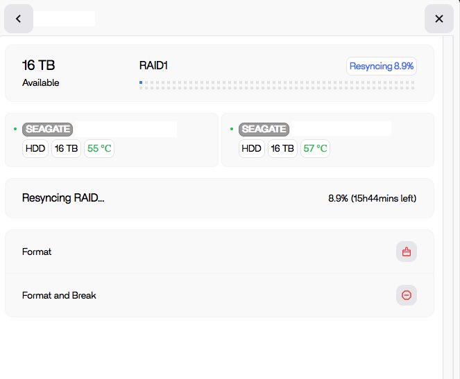

I have a brandnew ZimaBoard2 (updated to ZimaOS 1.5.4) with 2 brandnew HDDs. Just set up a RAID1, following whatever defaults are given by ZimaOS.
But now I’ve a question: ZimaOS dashboard reports the RAID1 is resyncing. Why? Is this a normal behaviour for a freshly set up RAID1? Note also, by now I also haven’t copied a single bit of my data yet to the RAID.

Thanks. So while you observed a resync as well, you definitely consider that a normal / to be expected operation?

If the two hard drives are brand new, or have just been put into ZimaOS to form a RAID 1 array, the system needs to perform an initial synchronization.
Reason: RAID 1 works by mirroring, so the two disks must be exactly the same.
Process: Although both disks are empty, the system needs to “write” the data from beginning to end to ensure that every sector of the hard drive is aligned and to establish a verification mechanism. This way, when writing data in the future, the system will know where to write it.
Thank you very much! This is the confirmation I was looking for and I’m relieved that this is normal operation.
