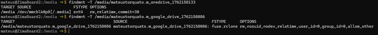

However, via SSH, I can still see leftover cloud-related directories under /media
OneDrive directories exist under /media but are not mounted (different from google drive):

Google Drive still showing is the giveaway, it’s mounted via FUSE and remained attached, while OneDrive/Dropbox didn’t remount.
