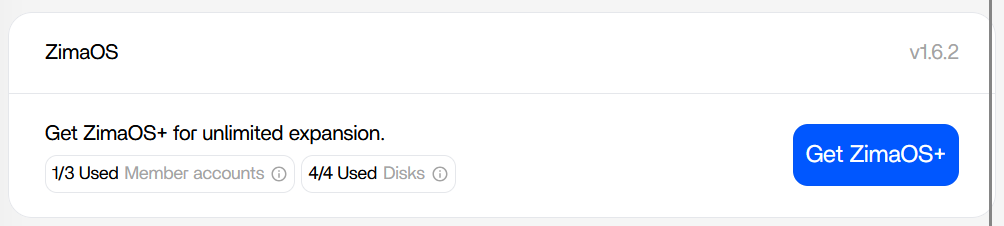

Hello everyone,
after updating my system to ZimaOS 1.6.2, my ZimaOS+ license is missing.
Instead, I’m being prompted to purchase a new one.
Is anyone else having this problem, and is there a way for me to get my license back?

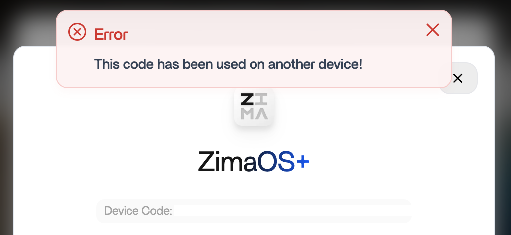

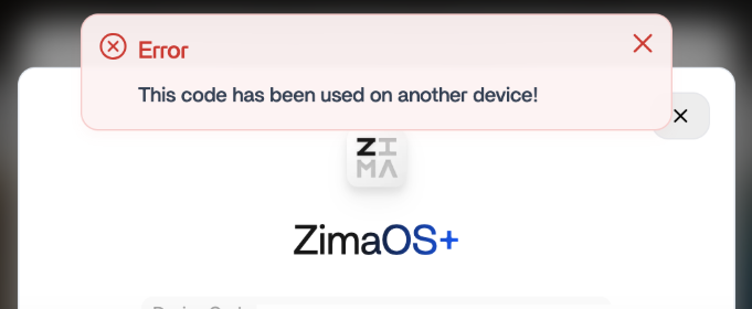

Hello, same here.
Following the 1.6.2 update, the ZimaOS+ license is deactivated. When trying to reactivate it with the ZimaOS PLUS code, I get this error message even though the DEVICE CODE is correct.

Hello, here is the result.
Now the zimaos version is 1.6.1 and the same error message :confused:

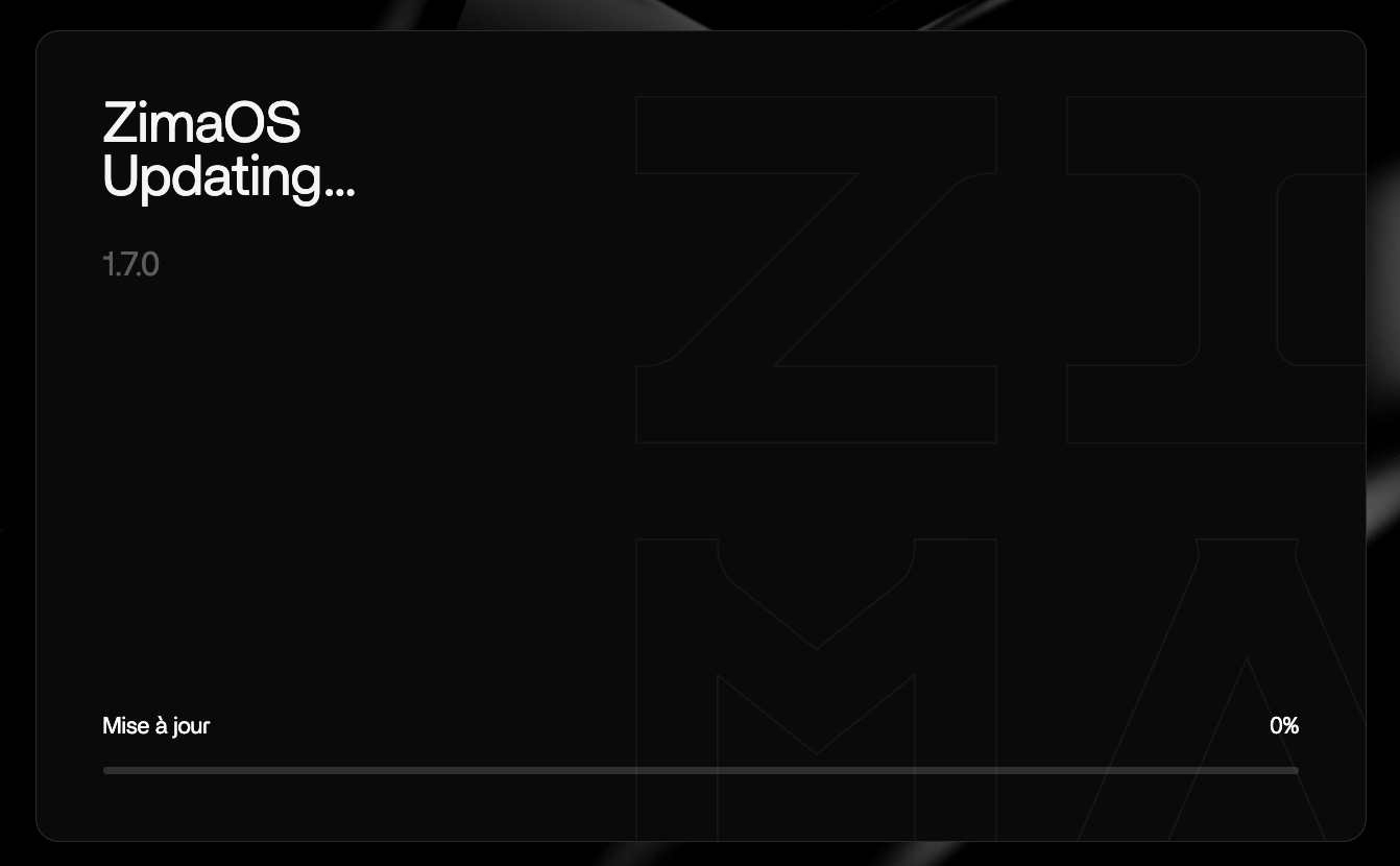

Hi,
I’m trying to update to this new version 1.7.0, but since the downgrade, the update no longer starts.
Thank you for your help.
I put the raucb file in /ZimaOS-HD/.ota/offline/
but it still the same :confused:
