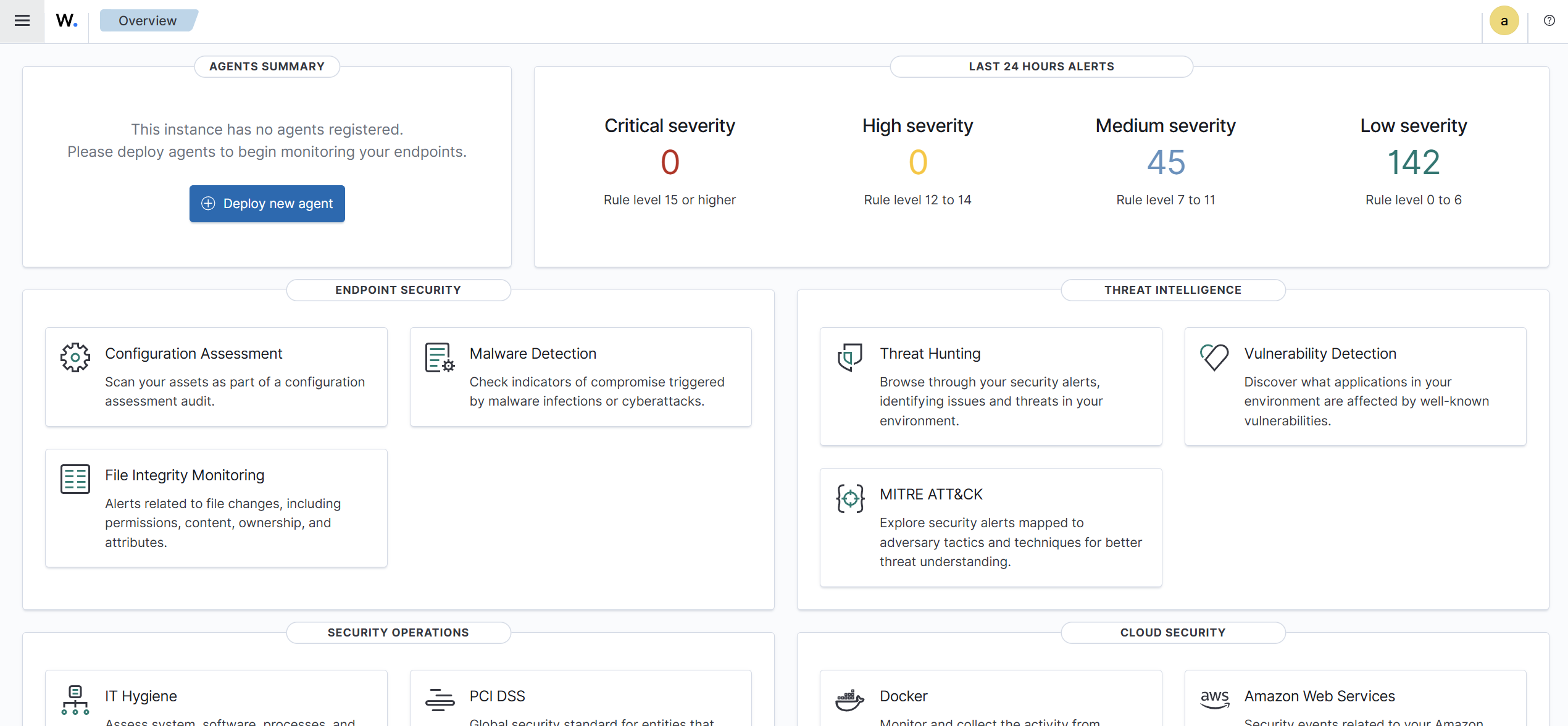

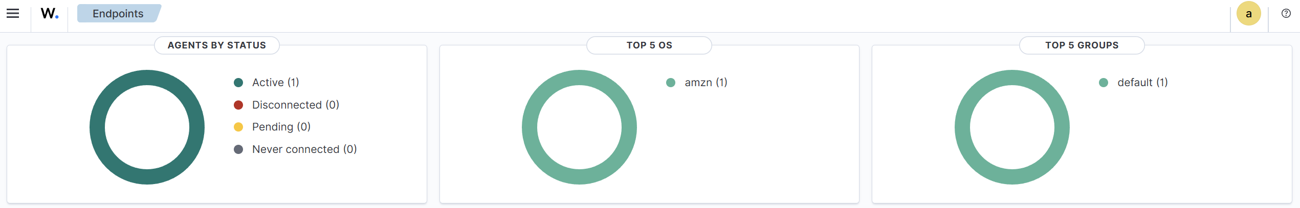

Got the dashboard running, but not sure how to use it. Also not sure how to Deploy new agent, command not working.
Your manager is running. The missing step is adding one agent.
On ZimaOS, the agent is added as another Docker container (not via the dashboard button).
How to add the agent (ZimaOS / Docker)
  1. Go to Terminal in ZimaOS
  2. Run this command (replace the IP if needed):
docker run -d \
  --name wazuh-agent \
  --restart unless-stopped \
  -e WAZUH_MANAGER="YOUR_ZIMA_IP" \
  -e WAZUH_AGENT_NAME="zimaos-agent" \
  wazuh/wazuh-agent:4.14.2
Example if your ZimaOS IP is 192.168.0.189:
-e WAZUH_MANAGER="192.168.0.189"
  1. Wait about 30–60 seconds
  2. Refresh the Wazuh dashboard
What will happen
  • The agent auto-registers using port 1515
  • It starts sending data on port 1514

Yes it was exacly what I tired and still wasn’t showing in the dashboard.
In the meantime I found another solution.
I am now using cloudflare.com ZeroTrust tunnel with 2 factor authentification and it is a lot more difficult to login to my server now.

Agent working now, but there must be something not right, not much information is displayed, definitely nothing about users. I went through most of the sections on the dashboard.
Good, that screenshot confirms the agent is connected and working.
What you’re seeing is normal. By default, Wazuh does not immediately show “user activity” in the overview panels.
A few important points to clarify:
• Login and failed-login events come from authentication logs, not from the agent summary
• Those events appear under Security Events / Authentication, not the main agent widgets
• It can take a little time for log volume to build before dashboards populate
• If there is no SSH or local login activity, there will be nothing to show yet
To actually see user-related events, make sure you:
  • Generate a login or failed login attempt (SSH is easiest)
  • Then check Security Events or filter alerts by authentication rules
Nothing is broken. The agent is healthy, it’s just that Wazuh only shows what actually happens, and the default dashboards are very conservative.
Once login activity occurs, you’ll see it reflected in alerts.
