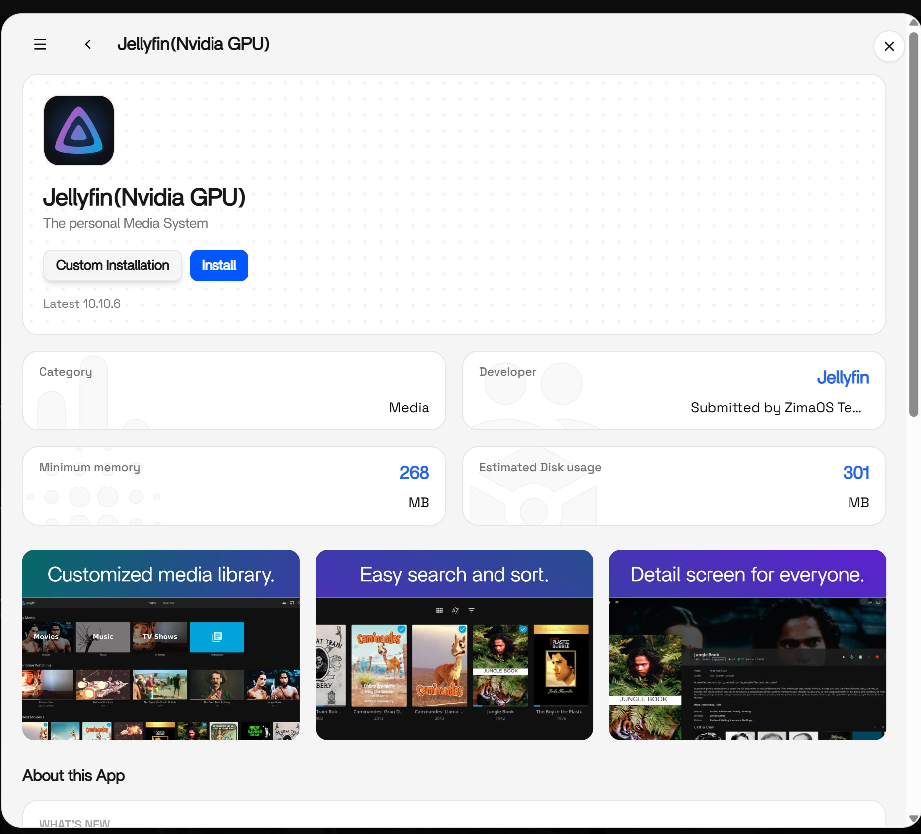

Jellyfin(NVIDIA GPU) in ZimaOS app store is outdated
When will there be an update for the “Jellyfin(NVIDIA GPU)” docker from the ZimaOS app store?
It has been outdated for a while and since today there isn’t even any more connections possible to it through Jellyfin Android apps.
It has completely stopped working on my TV for example where in a warning message they recommend using “v10.10.3 or newer”

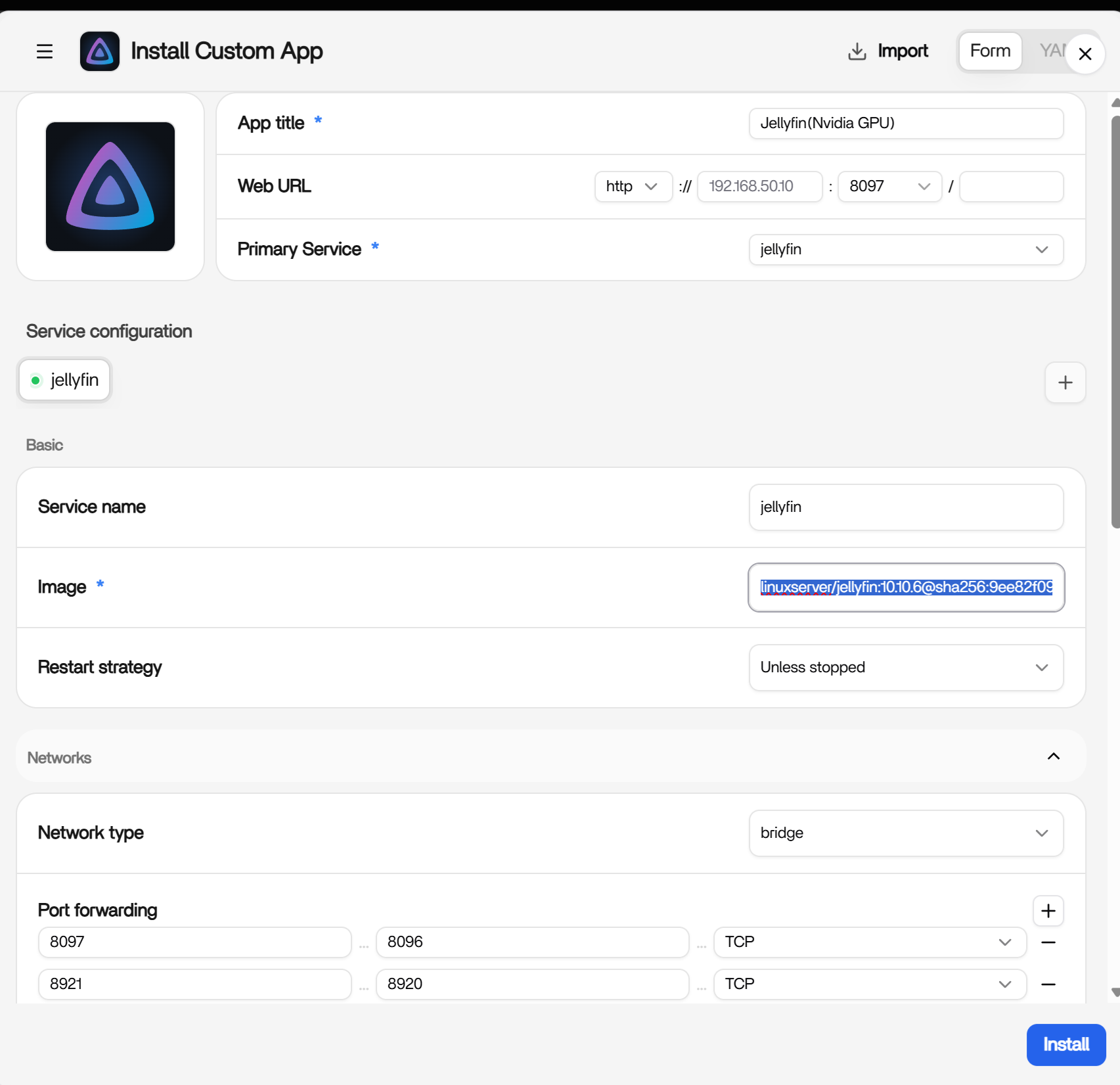

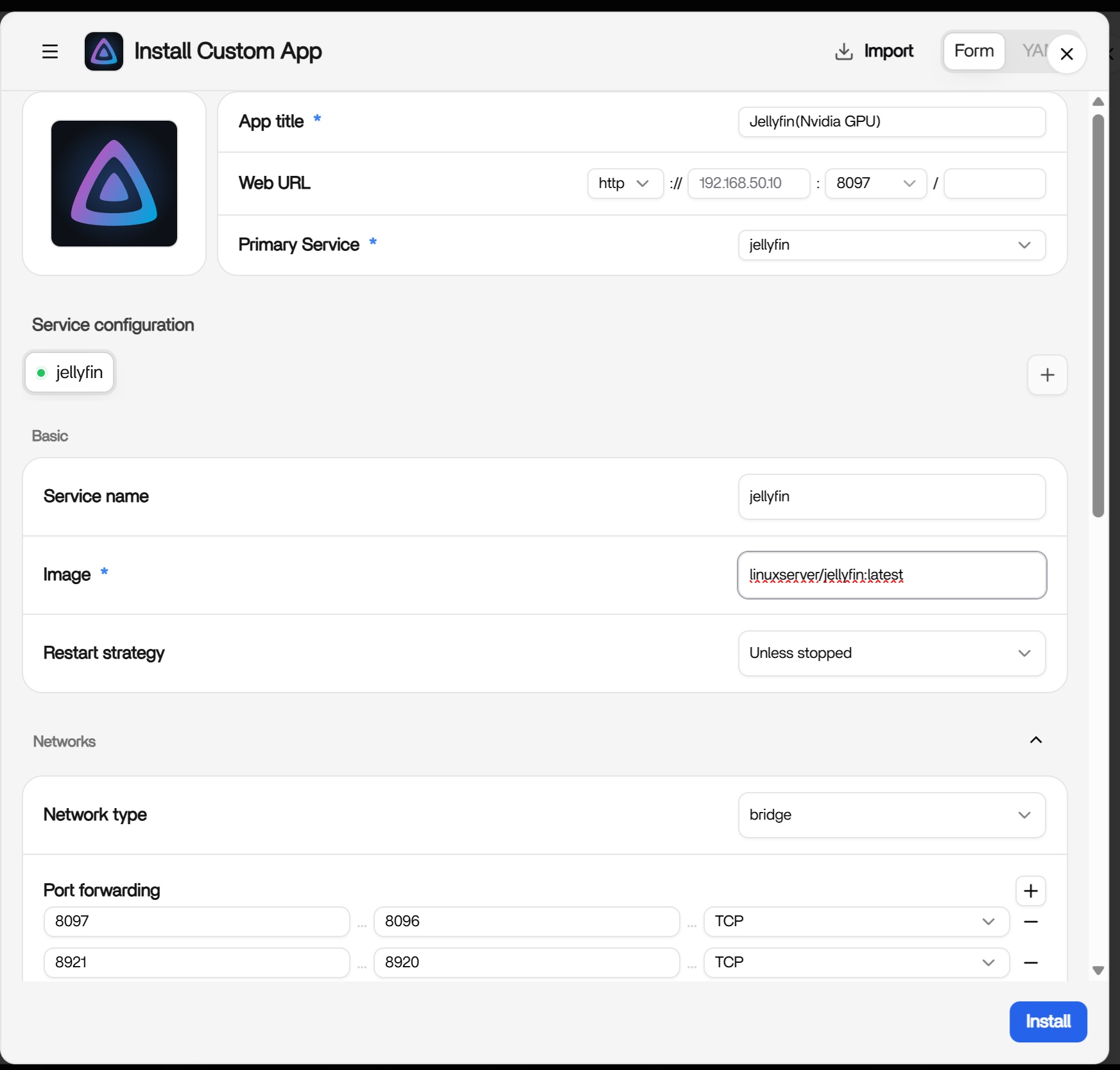

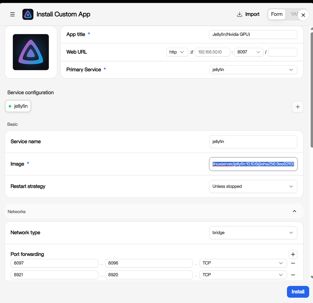

edit the image name to linuxserver/jellyfin:latest and it will install latest versions from now on.

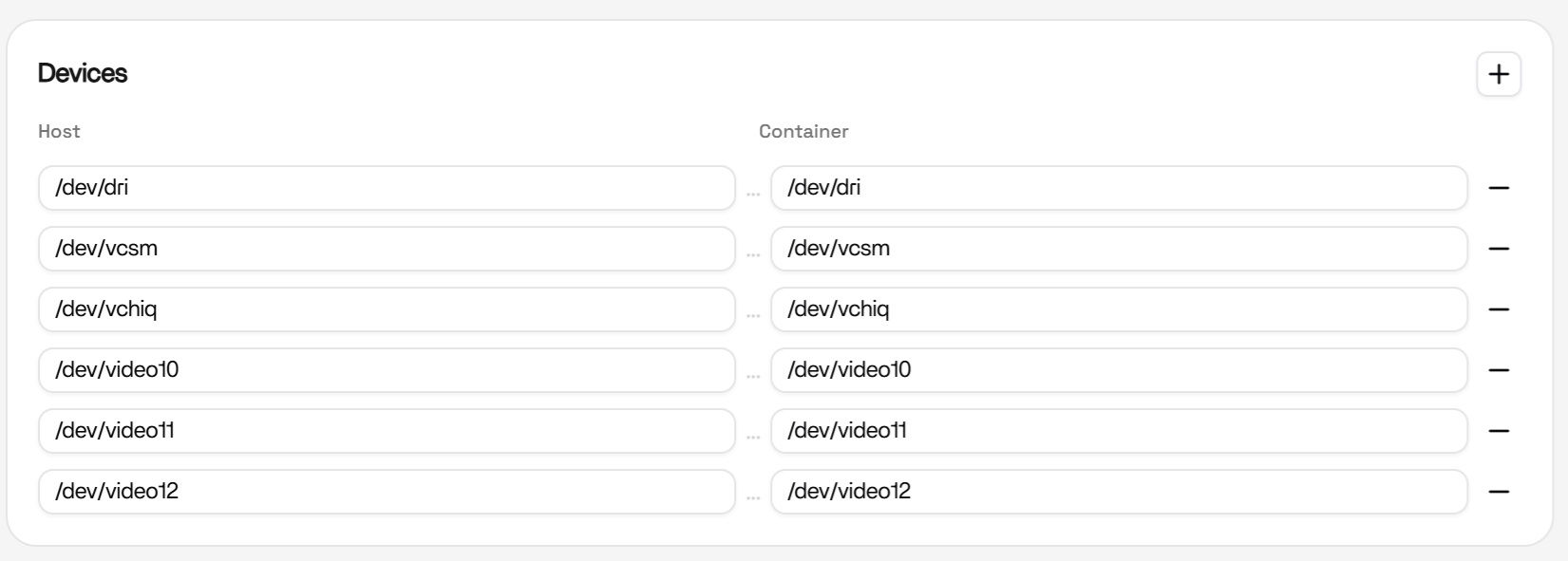

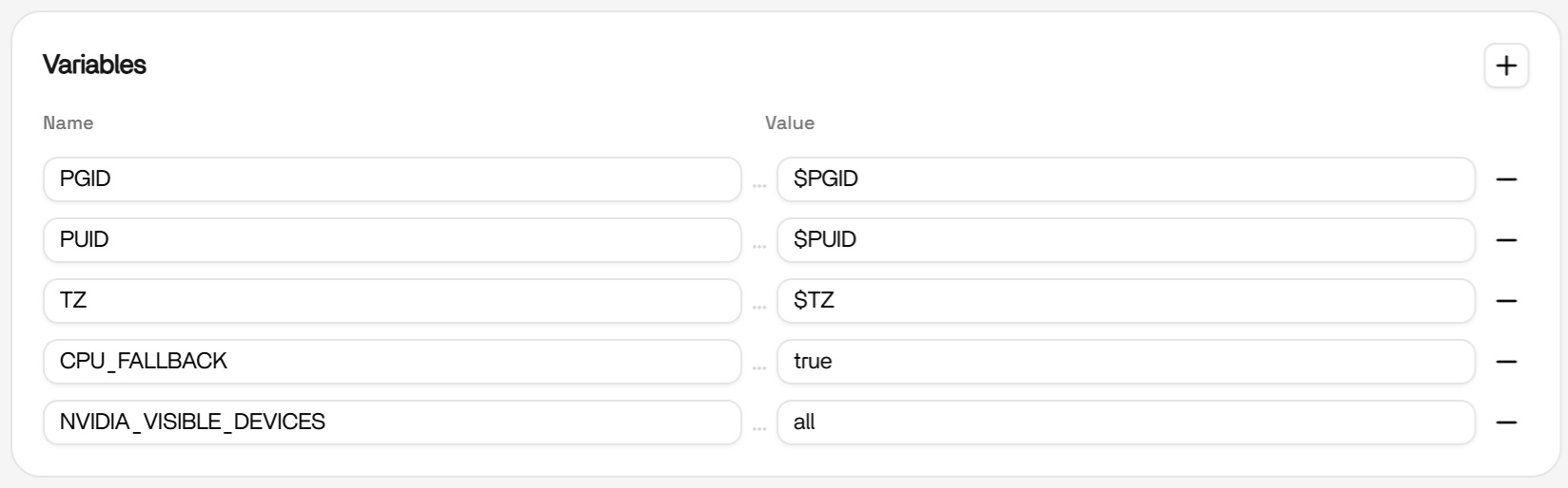

the nvidia settings you need are already entered in the settings to contain the needed configuration for nvidia gpus. you can also go to the app store and use the custom install option for nvidia gpu and change the image to linuxserver/jellyfin:latest for a first time install.
the only difference between jellyfin and jellyfin nvidia gpu is the enviromental variables and devices sections are set up for nvidia gpus as below. and since you already have the nvidia version installed with these added you just need to change the image name to instruct it to download the latest version which is now 12.1. any new version will appear as an update in the app store.

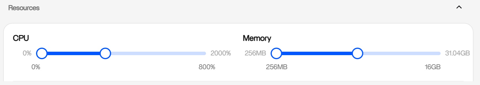

The zima updates to how docker images are handled also doesn’t setup the amount of cpu’s used as clearly as before since it has changed the number of cpu’s to percentage of cpu.
So having 4 cores would be 400% for example. I found since version 1.71 I had to manually change it from 100% as 1 core or 100% was making things slow, especially scanning libraries or loading in images while browsing.
