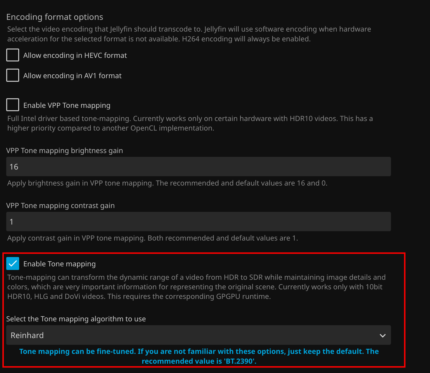

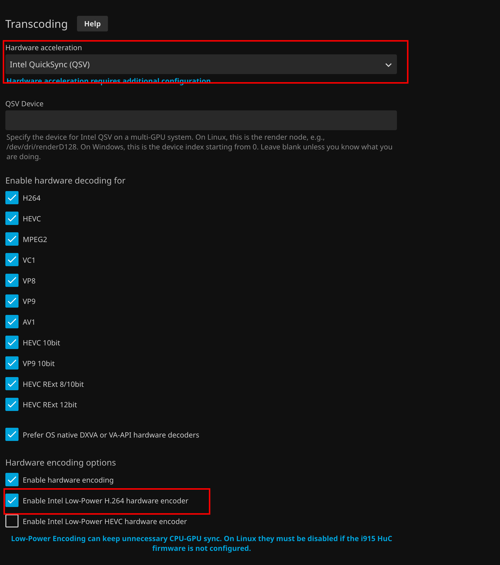

Here are my transcoding settings:

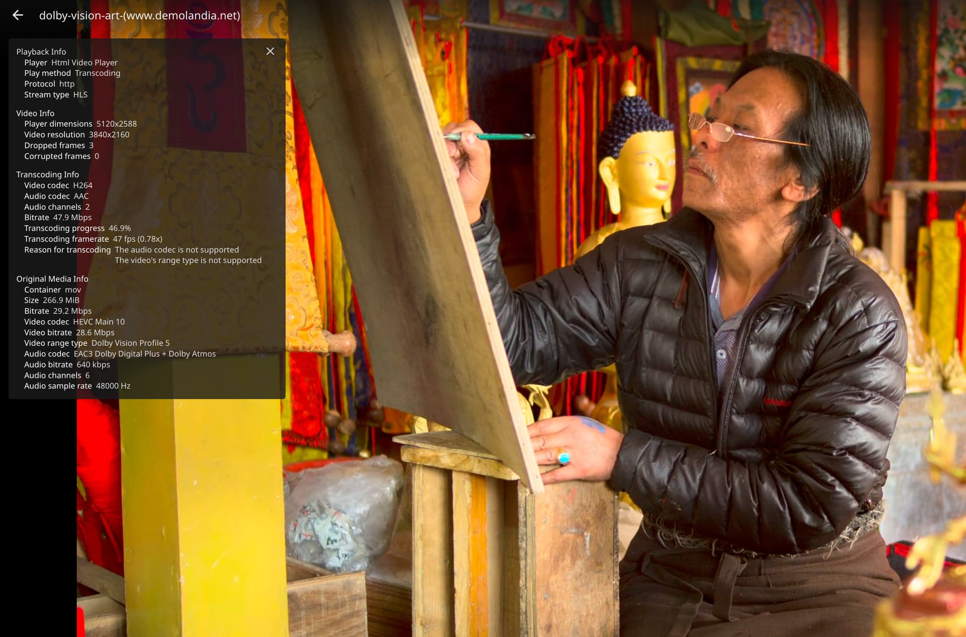

This is the final playback result:
Since the integrated graphics performance of the N100 is not very strong, it seems to only handle smooth conversion of 4k 30fps and below Dolby Vision videos.
