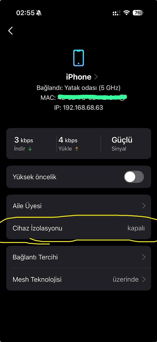

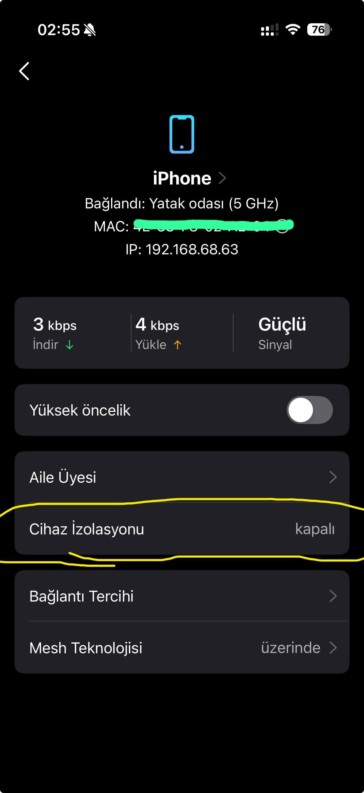

As I mentioned before, there is no isolation enabled. In the Deco app, there’s only one isolation-related setting, and it’s turned off. You can find a screenshot attached. My system language is Turkish, but I’m sure you’ll understand it when you see it :grinning_face:
I’ve tried many applications, software, and operating systems so far, and I’ve never encountered a situation where a client couldn’t find the device. I still don’t believe the problem is caused by my home network.

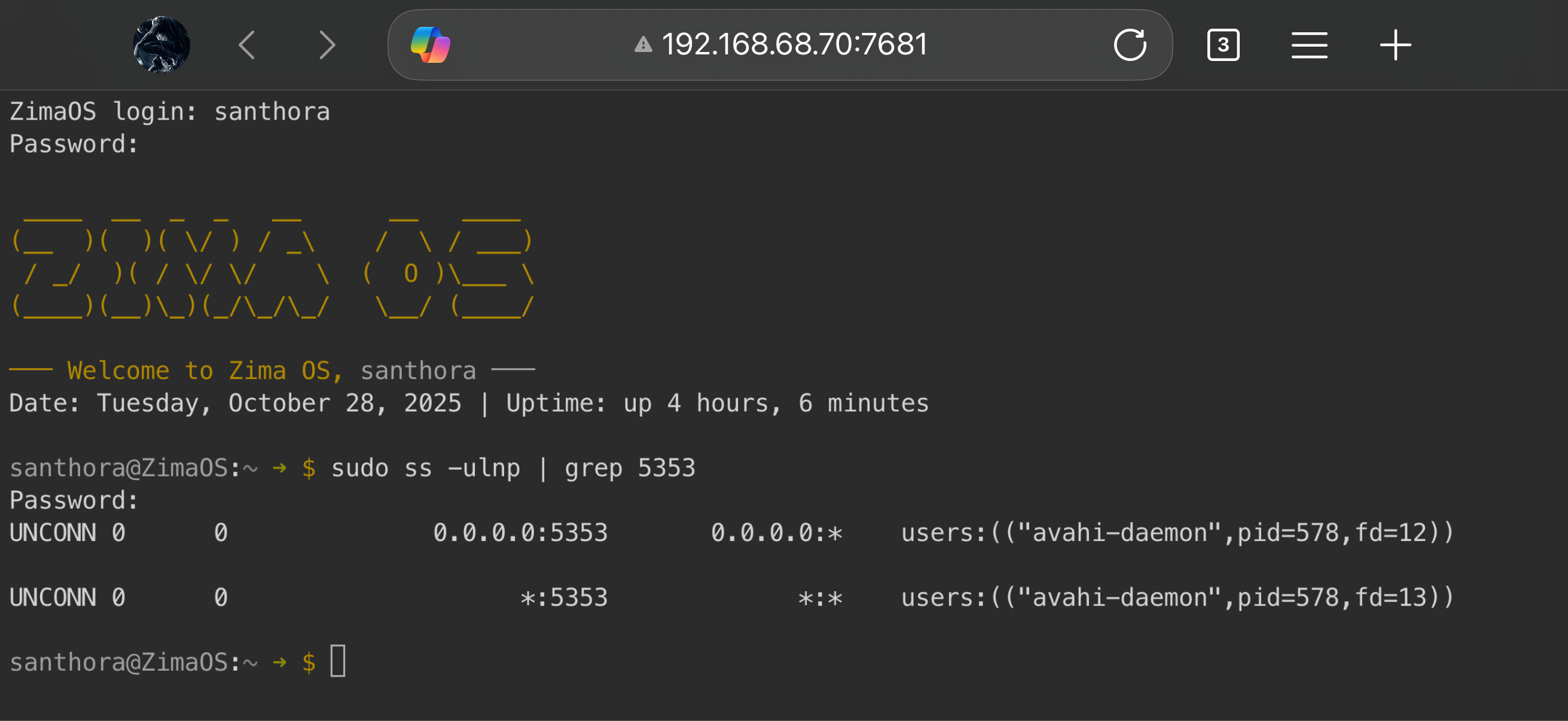

If you’re comfortable checking, please run the following on your ZimaOS terminal and share the results here:
sudo ss -ulnp | grep 5353
This simply lists which interfaces Avahi is listening on — it doesn’t make any changes.
It’ll help confirm whether discovery packets are being broadcast correctly on your main network interface.
I entered the command you requested and have attached the result. Also, I forgot to include the screenshot showing that client isolation is disabled in my previous message — I’ve attached it here as well :grinning_face:

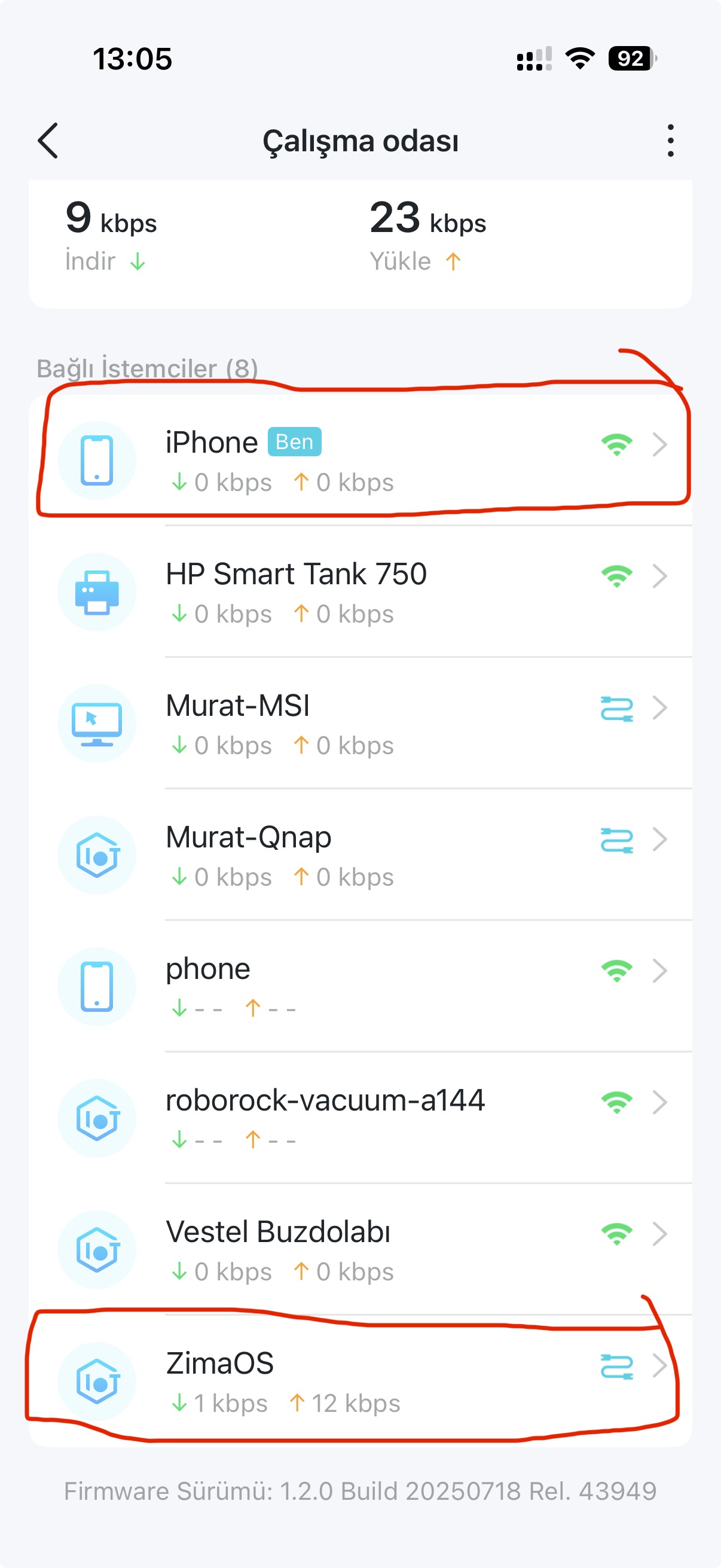

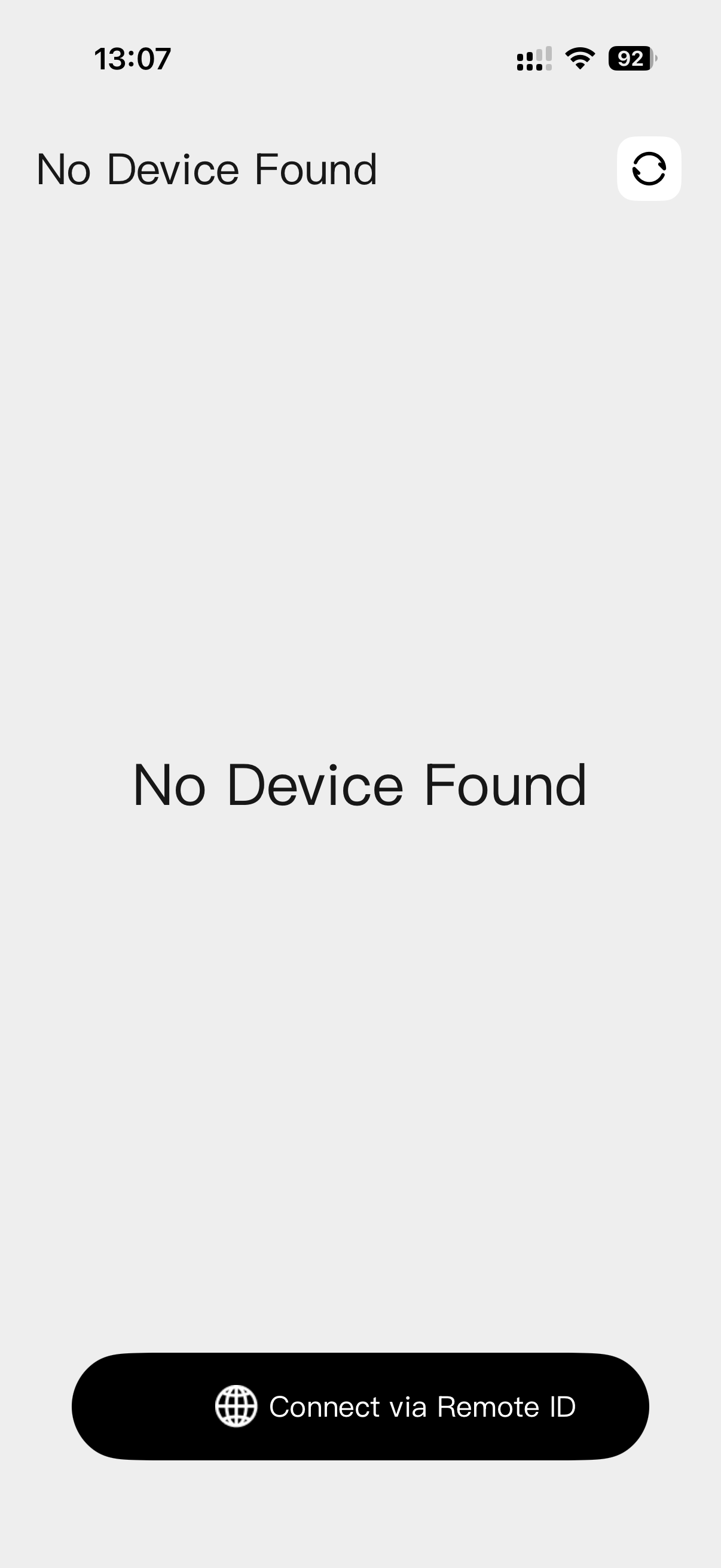

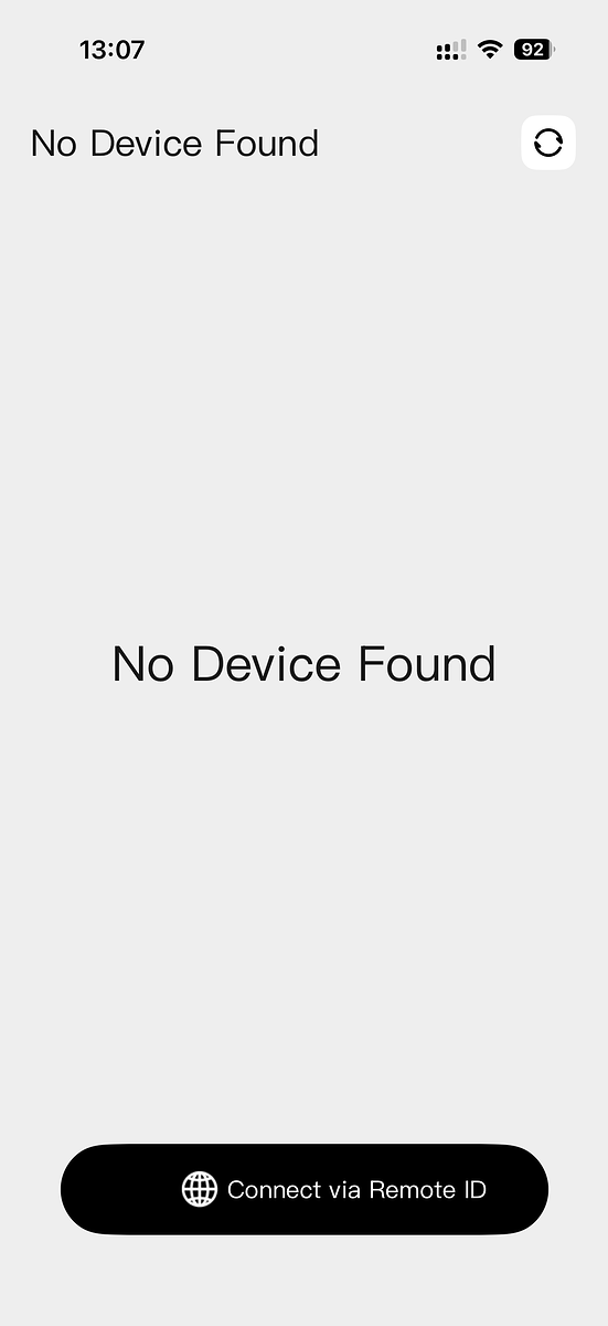

If possible, try connecting your phone to the same Deco unit where your ZimaOS server is wired, then reopen the Zima Client.
If the server appears, it confirms the mesh is filtering multicast discovery.
As you can see from the attached files, both devices are connected to the same unit, and the result is still the same :pensive_face:

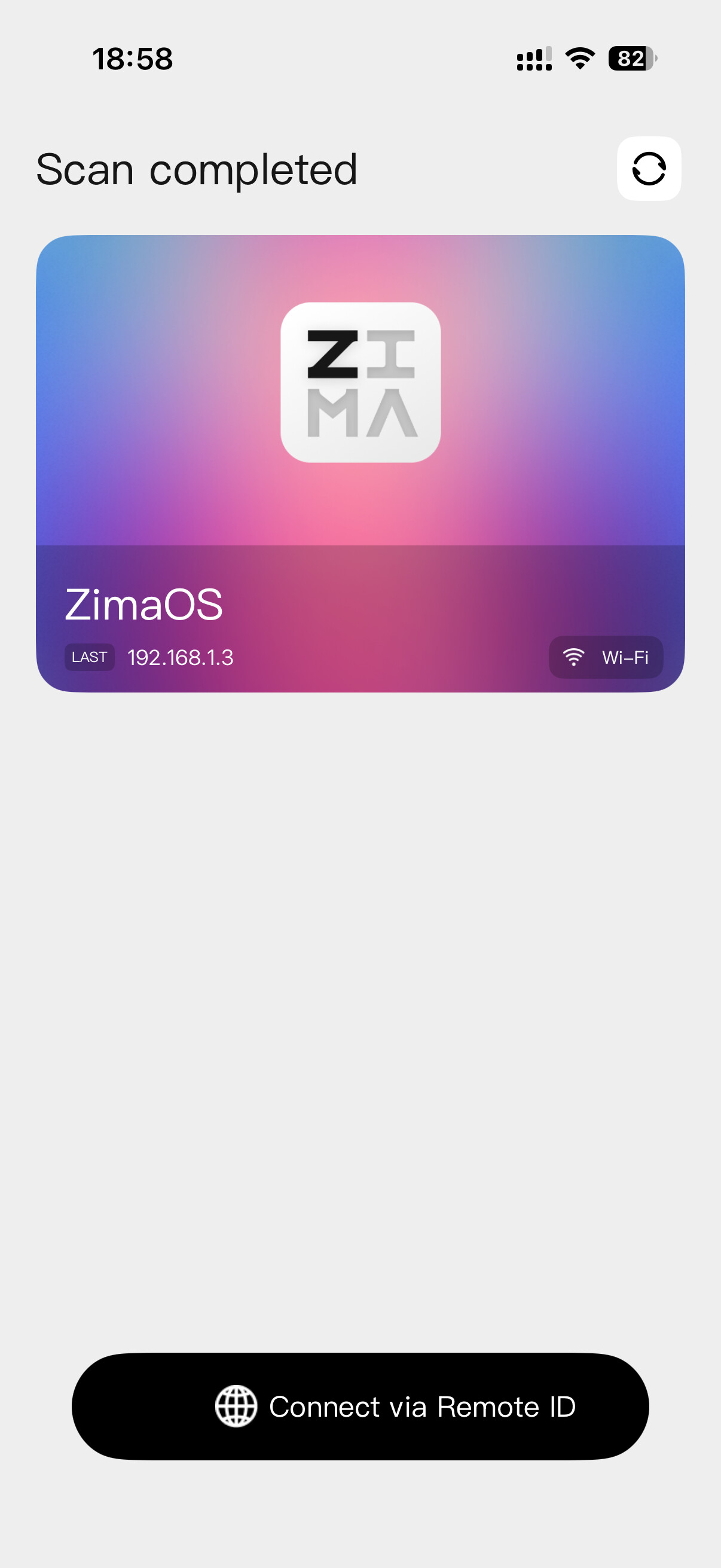

You’re right. I switched to the ZTE modem provided by my ISP — which I hadn’t been using — and tested it, and the Zima Client immediately found the server. You can see it in the attachment.
Thanks to everyone for their support. My Deco network, the usual suspect, has now basically confessed. :rofl:

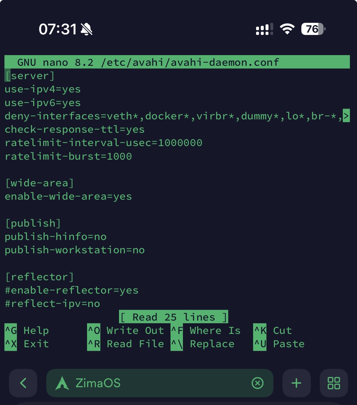

sudo nano /etc/avahi/avahi-daemon.conf
search for this and insert a „yes“:
[reflector]
enable-reflector=yes
save + exit
then restart service:
sudo systemctl restart avahi-daemon
Device findable now?
As you can see from the attached file, I followed your instructions, but nothing changed.
Do I need to revert the code to its original state, or is it okay to leave it as it is?
remove the „#“ and then try again.
