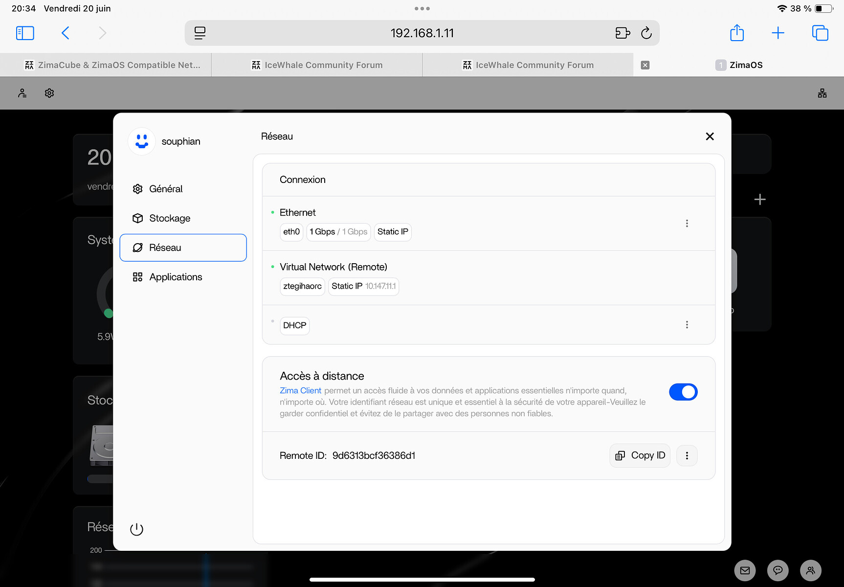

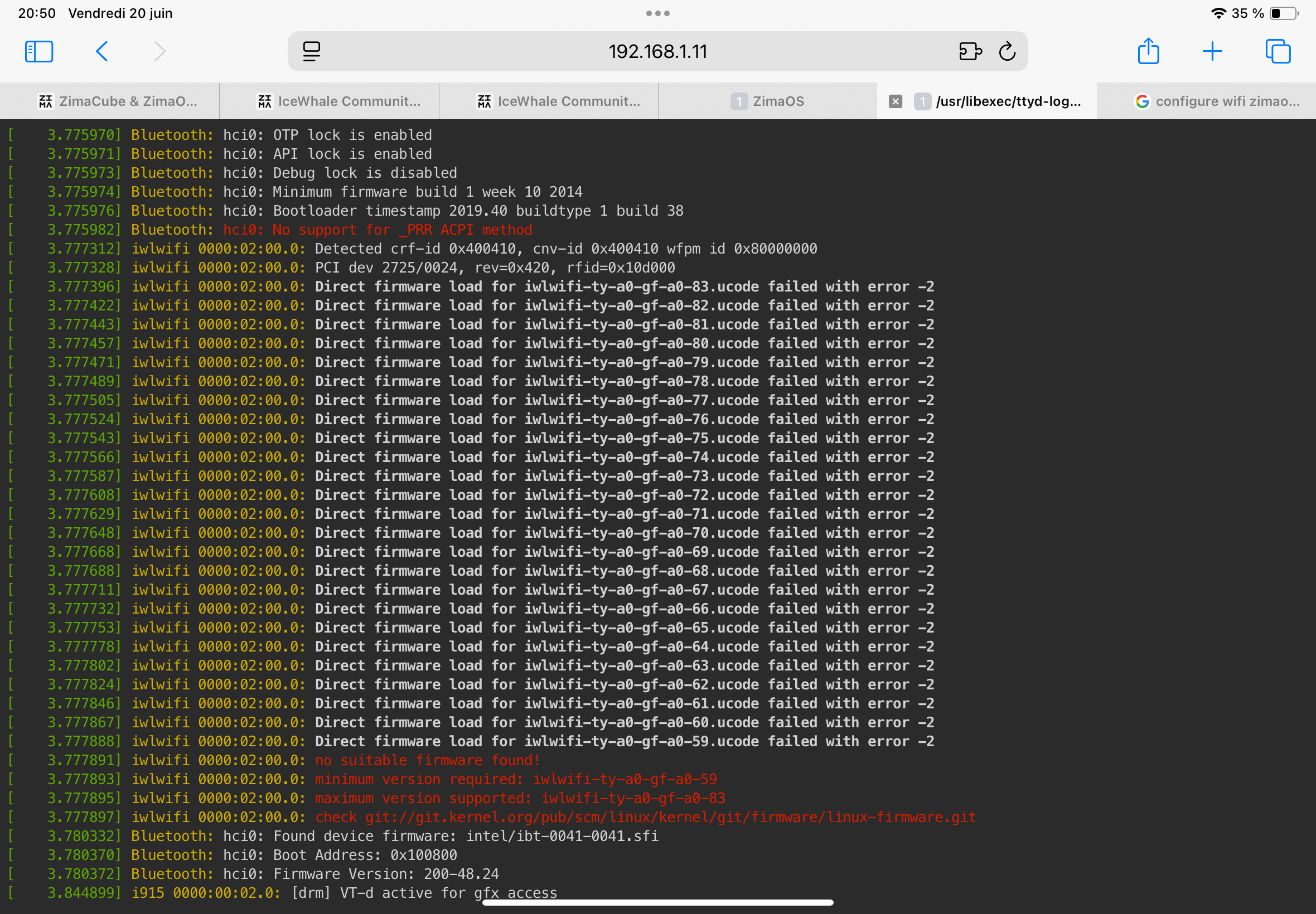

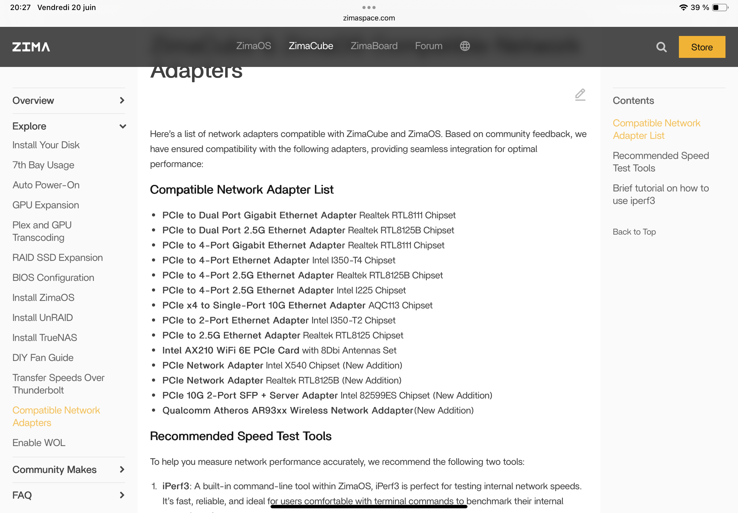

as showed in the pic the intel ax210 is comptible with zimaos
its not detected and iwlwifi firmware is not founded
anyone knows how to resolve the problem
It was tested internally. Though we suggest you use an Ethernet cable, you can get Wi-Fi support at the CLI level in 1.4.2.
