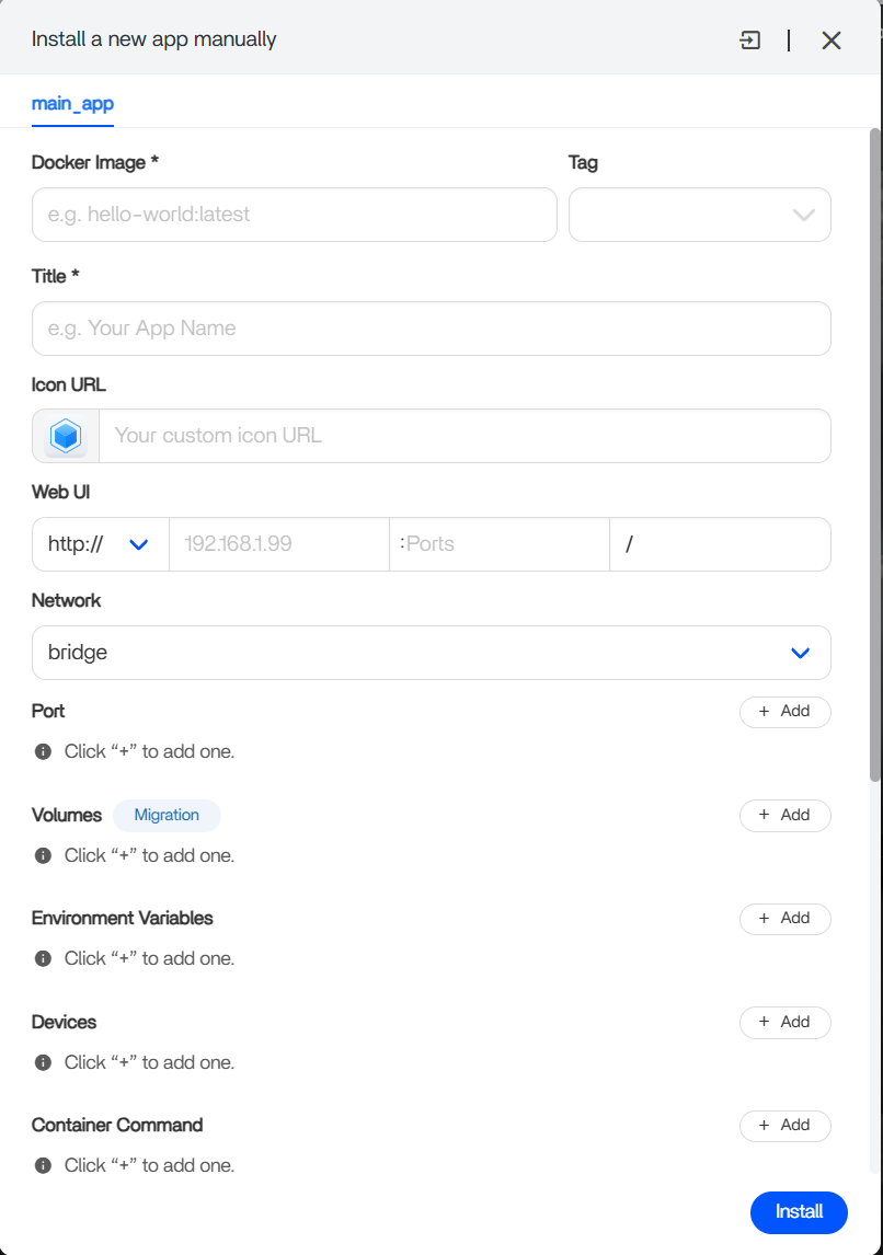

I thought about using the “add a contanerised Application” option and had a look but I’m not 100% sure on how to use it.

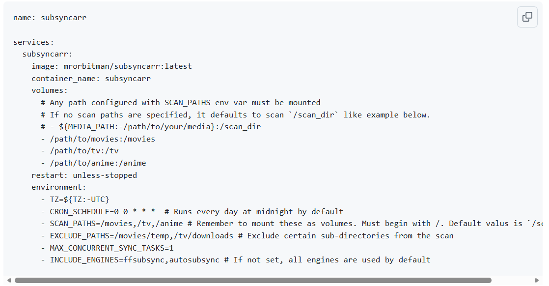

The docker app I want is here:
mrorbitman/subsyncarr - Docker Image
I don’t want to mess anything up with anything else and I think I’ve got a rough idea but all the install instructions don’t really co-relate with the options on the button in ZimaOs.
ZimaOs:
Install instructions:
I’m just not 100% what goes where and don’t want to spend many an evening messing up so if anyone has any tips/guidance or a “that’s not going to work silly” comments then please. Save me a few hours tearing my hair out (I’m bald)….

Hi Steve, welcome.
You are not being silly at all. The ZimaOS manual install screen is basically asking you to translate the Docker Compose example into fields.
Roughly it would be:
Docker Image
Tag
latest
Title
Subsyncarr
bridge
For this type of app, I would leave Web UI / Ports empty unless the app documentation specifically says it has a web interface and exposes a port.
The important part is the Volumes section. That is where you map your real media folders into the container.
Example:
Host path: /your/zimaos/movies/pathContainer path: /movies
Host path: /your/zimaos/tv/pathContainer path: /tv
Host path: /your/zimaos/anime/pathContainer path: /anime
Then under Environment Variables, add the values from the Docker example, for example:
TZ=Europe/London
CRON_SCHEDULE=0 0 * * *
SCAN_PATHS=/movies,/tv,/anime
The key thing is that SCAN_PATHS must match the container paths, not the ZimaOS host paths.
So if you map:
Host path: /DATA/Media/MoviesContainer path: /movies
Then SCAN_PATHS should use:
SCAN_PATHS=/movies
Not:
SCAN_PATHS=/DATA/Media/Movies
You can leave Devices and Container Command empty unless the documentation specifically tells you to add something there.
The main thing is to make sure the host paths are the real ZimaOS media paths where your Jellyfin libraries are stored. Check the exact paths in the ZimaOS Files app or from the Jellyfin container volume mappings first.
As long as you only add this as a new container and map the media folders correctly, it should not interfere with Jellyfin. The worst case is usually that Subsyncarr cannot see the folders until the paths are corrected.
