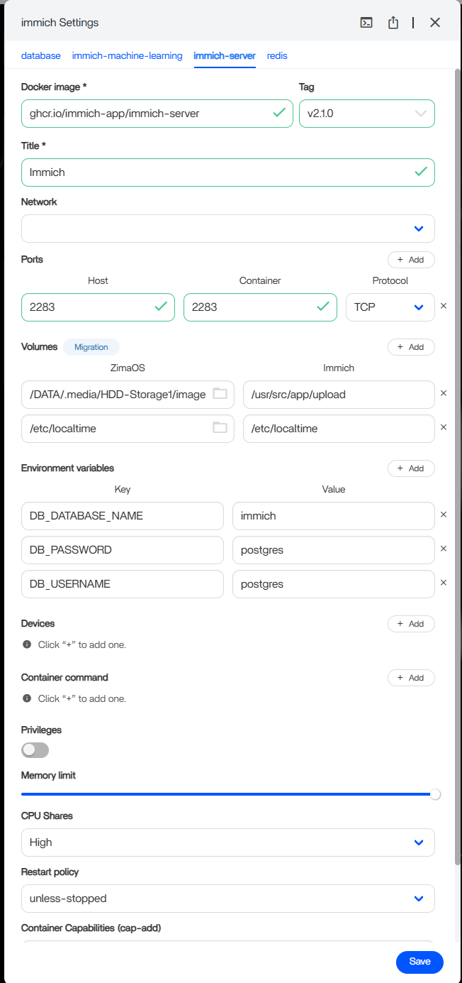

been trying this problem for a week now and kind of loosing my hair😂, sorry for such a noob here. I have searched the community and none of them really solved but gave me Ideas and thanks. My problem is I can’t seem to change the Storage location of Immich where it should save the Photos. It always use the System SSD with 250gb. I want it to store it in my 1TB HDD (for testing) but it’s not using it. I tried CogZog instruction (thanks for your effort) but Immich (version 2.7.4) keeps failing to start or it breaks. I tried the one that says before opening immich “In the immich-server tab, map your album storage location in the Volumes section (default is /DATA/Gallery/immich).” Keeps failing to start too after changing the Path. Even in my Mobile Phone when I tried to upload, the Storage shown is the System SSD. I appreciate very much for the help.
PS: I opened a new Topic cause I mostly see is from version 2.3.1 , I am not sure maybe there’s a difference since I just starting to make my own Homeserver. Sorry if it’s wrong for starting this Topic again, Thank you.

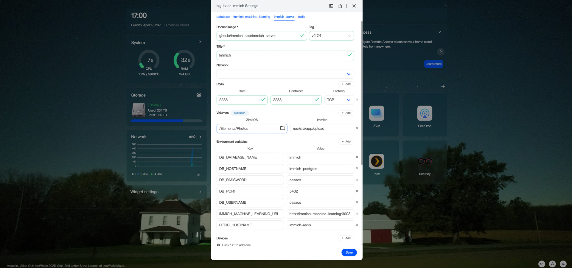

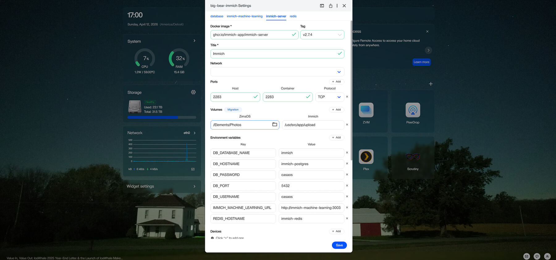

Didn’t seem to work for me. I had added an external path to a folder on my storage drive and that worked but replacing the default upload path to the same did not…
Hi! Thanks for your reply.
Could you please share a few screenshots of your container setup (especially the volume/storage configuration)? That would really help me understand what might be going wrong.
Thanks a lot!

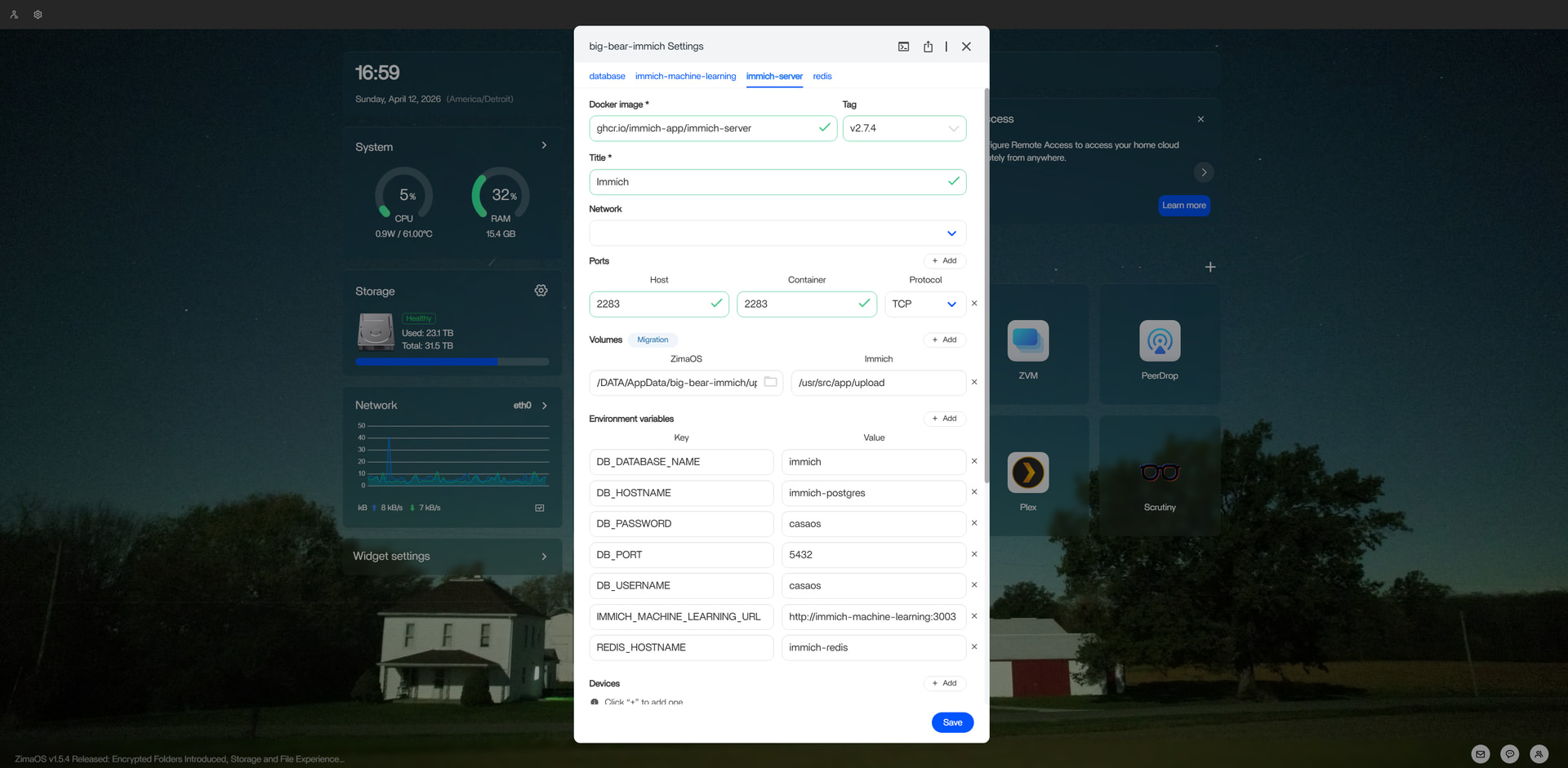

this is my attempt and fail.
Hi! Thanks again for your screenshots.
Instead of using:
/Elements/Photos
it should actually be:
/DATA/.media/Elements/Photos
I think I found the issue. My path was wrong before.
/DATA/.media/Elements/Photos/upload

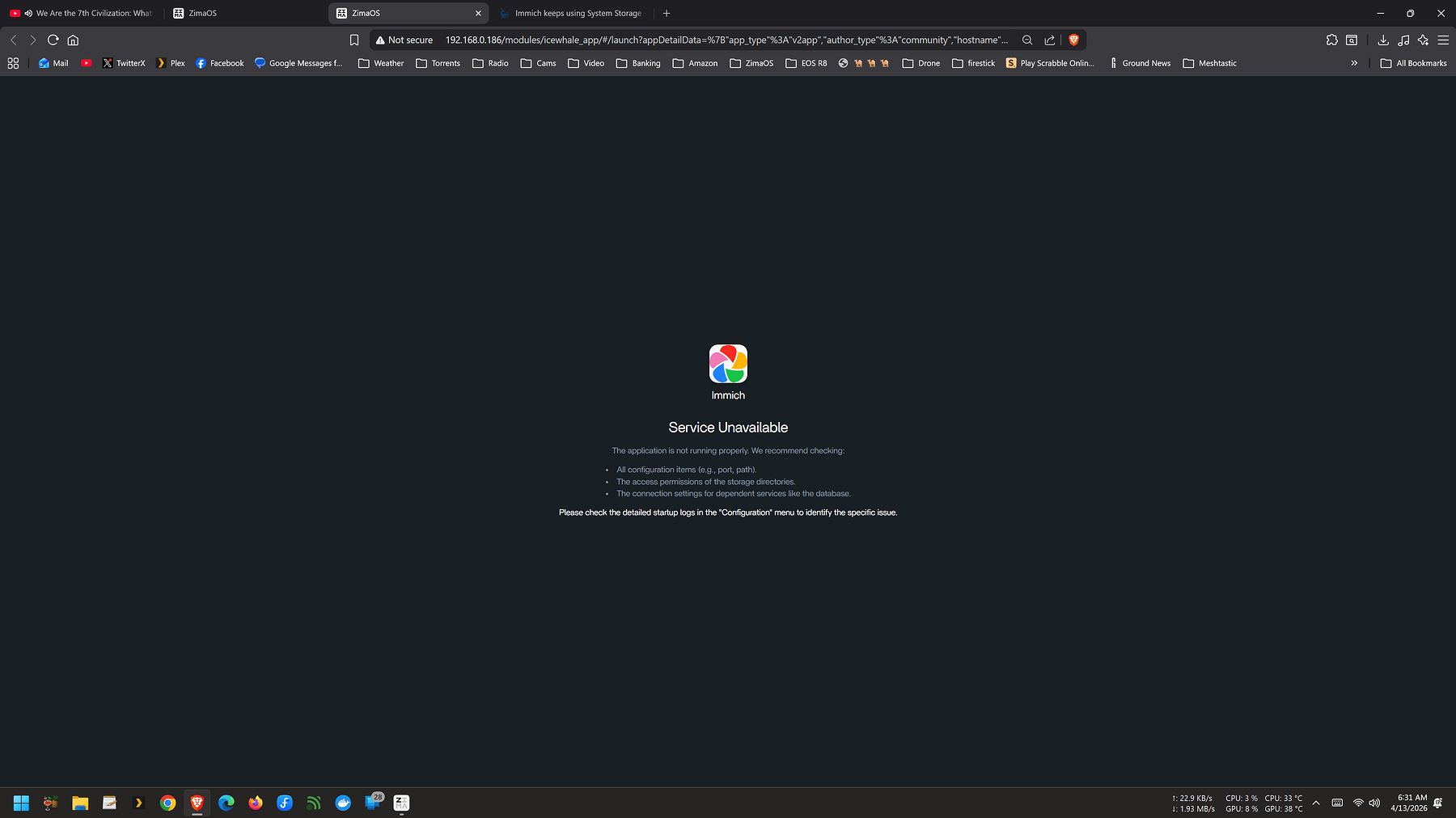

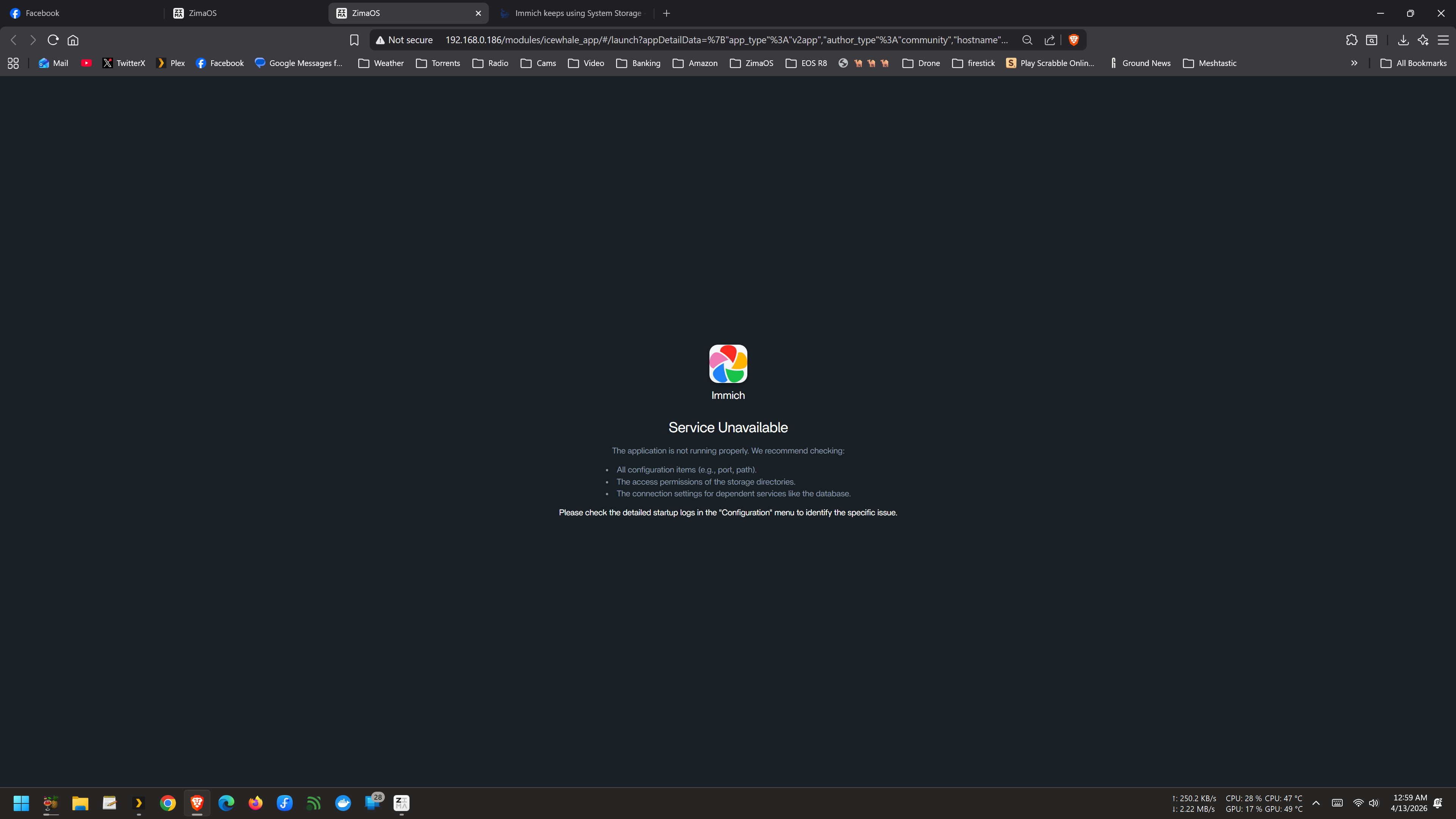

nope that failed as well. a message came up and said the container was unhealthy and for the last hour it has continued to try to load.

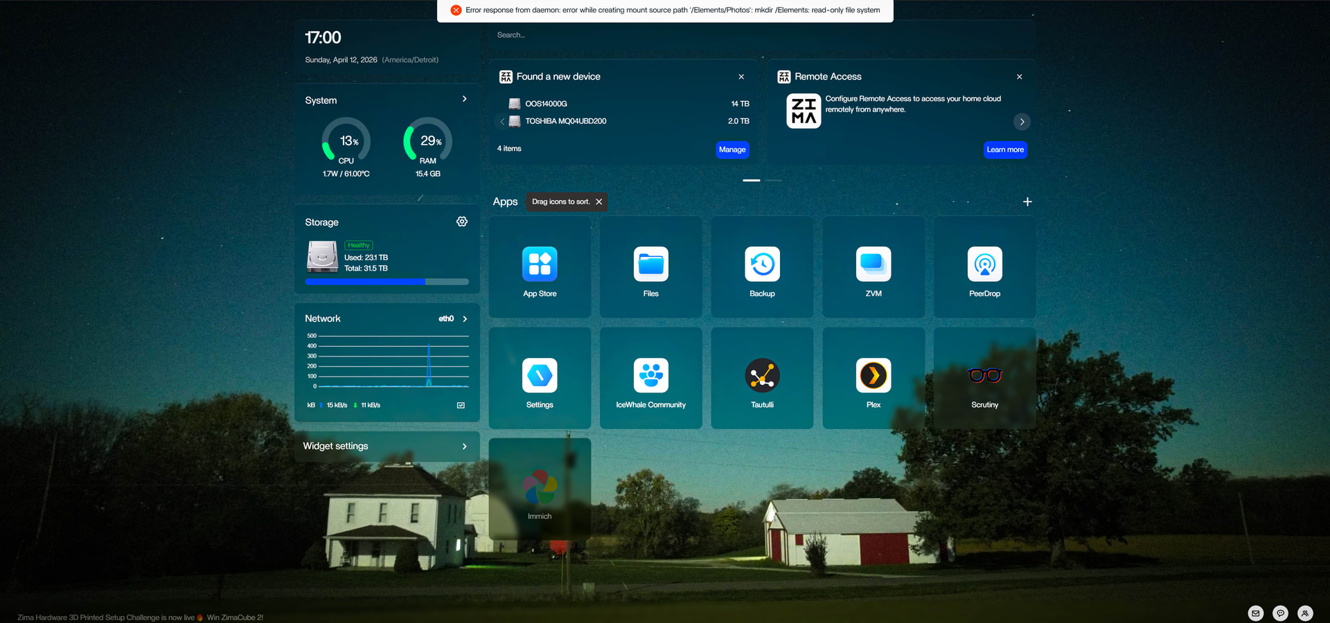

i am beginning to wonder if it goes back to the message on the first image i shared with the warning saying that external hdd is read only. i find that hard to believe because the “Files” container allows me to transfer files from my windows pc…. and i had previously reformatted that hard drive in exfat. but the “/DATA/.media/Elements/Photos” allowed the container to actually start. It was not until i tried to actually run immich that it became a problem.

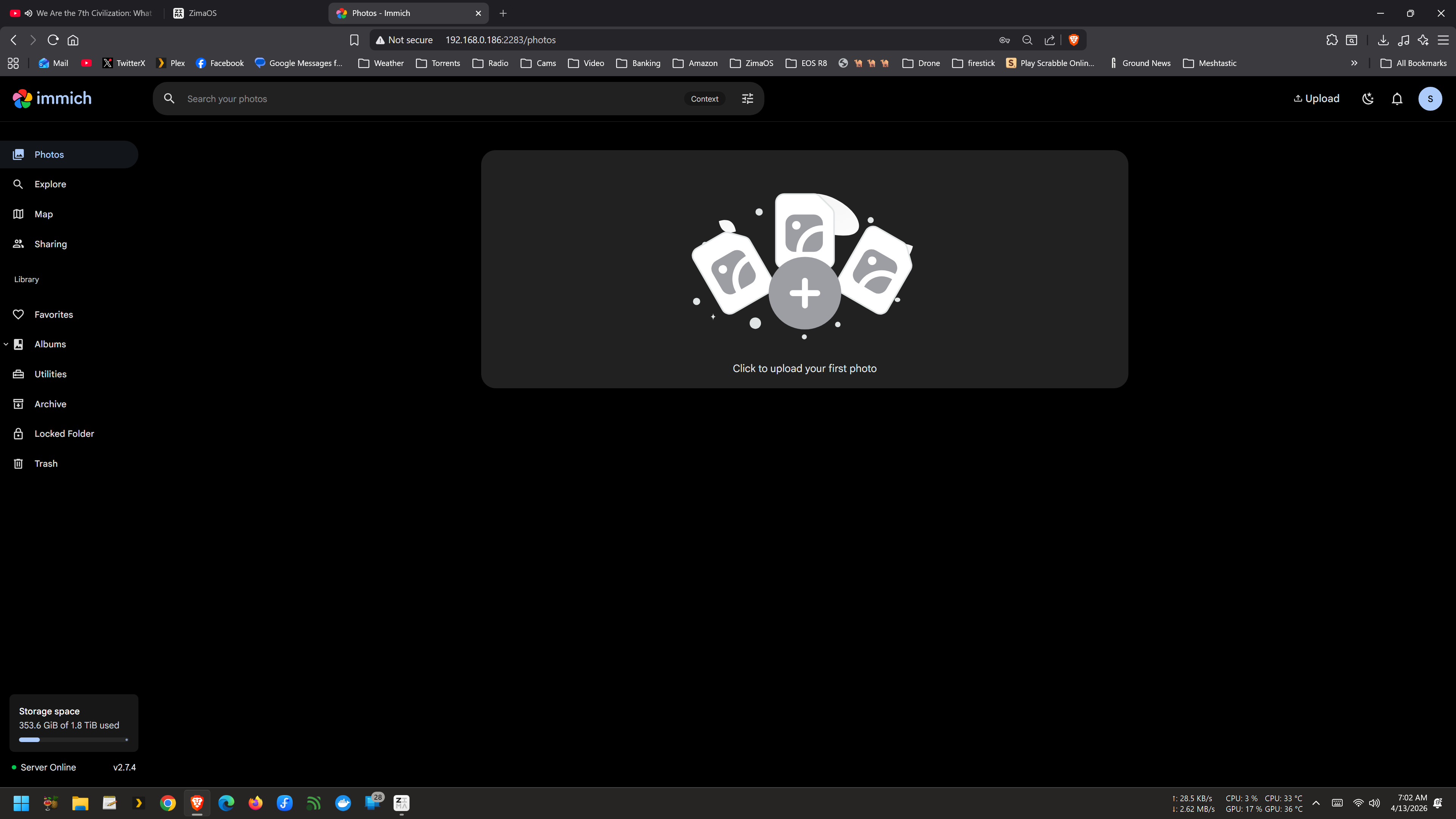

that did it. I followed your instructions then I used isanto1306’s YAML configuration to install immich and it now works.
