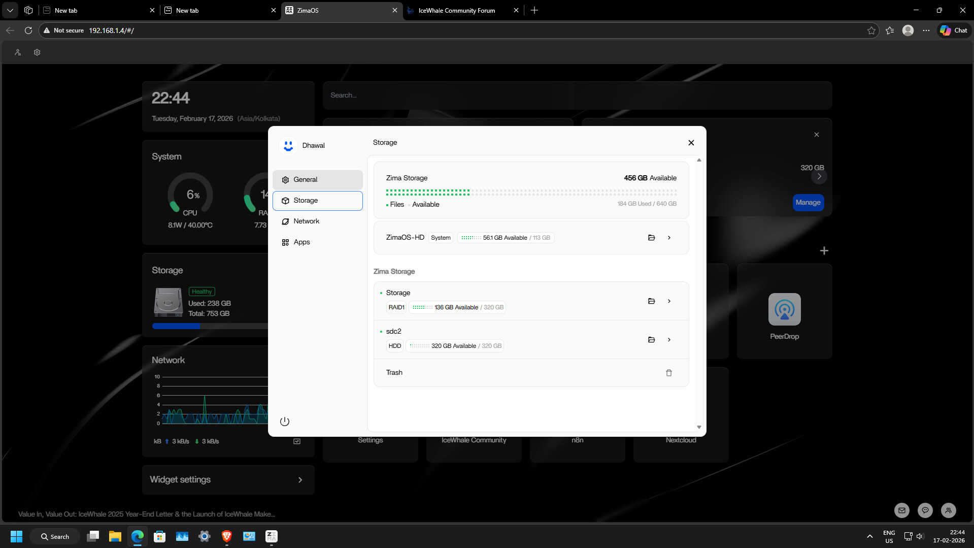

I had added new hdd i am unable to format it and change the file system from the ntfs to the ext4 can i gets help how to do that is there is any way to check the all the drives fromat which is conencted to the device
i am unable to format sdc2 and it is giving the error code 1
