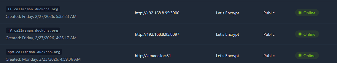

I’ll try it as well, what I did for now:
  1. Install nginx proxy
  2. enable https on zimaos
  3. since landing page of zimaos takes port 80 and 443 it creates some isues when configuring npm and other apps…
  4. solution edit /etc/casaos/gateway.ini 80 > 85, 443 > 444
  5. sudo systemctl restart zimaos-gateway.service
  6. Configure duckdns
  7. use cert from duckdns
bottom line is it works.
