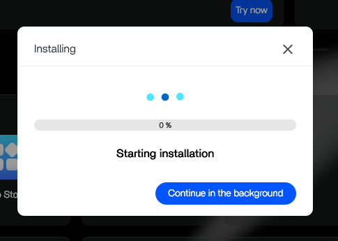

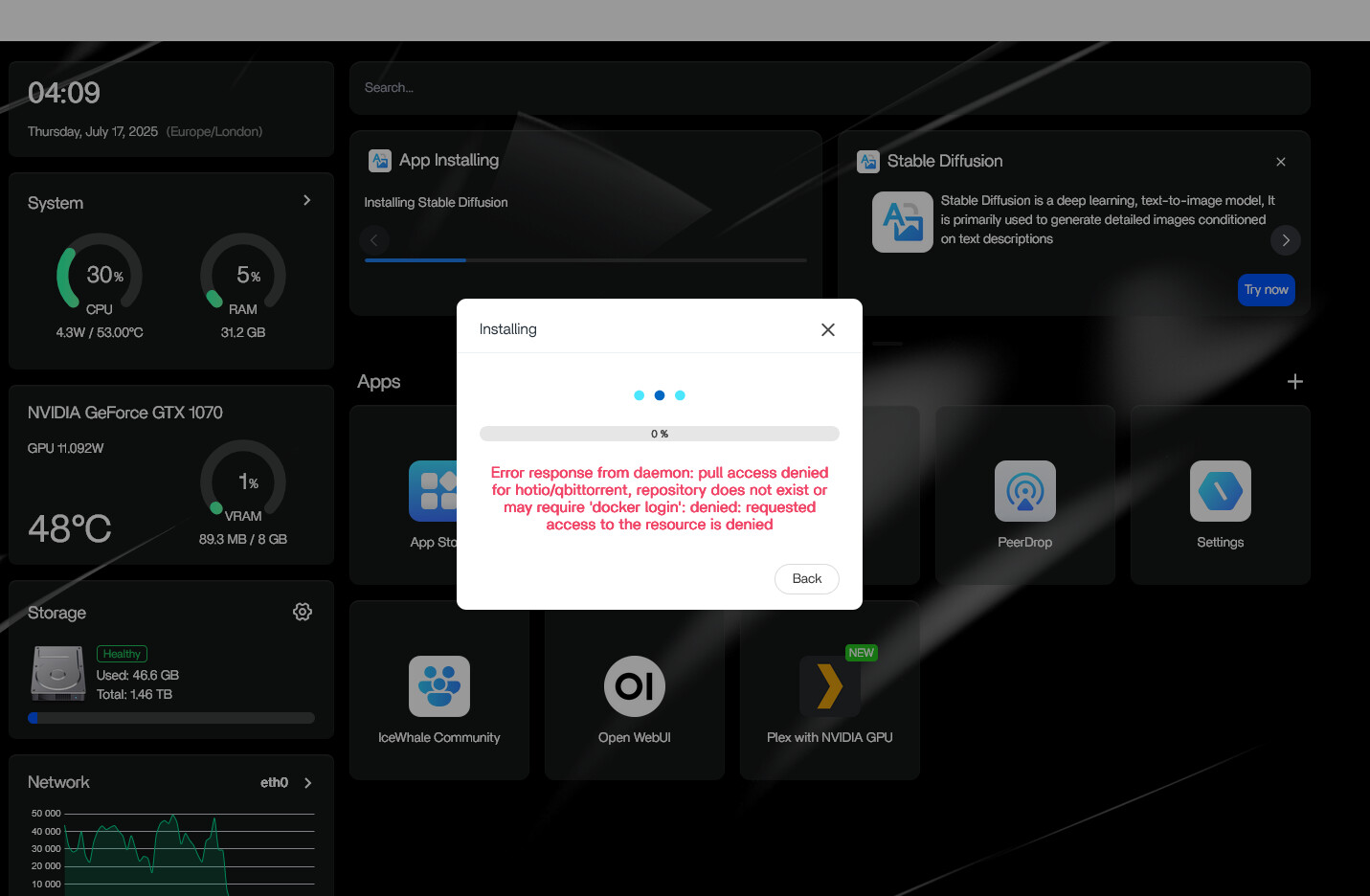

Hello, complete noob here, both to zima and docker.
I’m trying to install qBittorrent threw the appstore, but its not able to do a pullrequest.
Can anybody help me solve this issue?

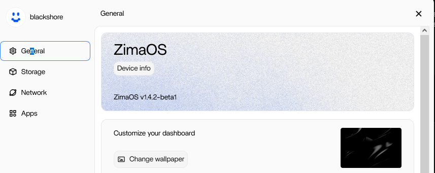

If convenient, would you please try the latest 1.4.2 beta1? In this version, we improve the experience of app installation the fix possible issues.
The download page: Releases · IceWhaleTech/ZimaOS · GitHub
Upgrade guide: Update offline | Zimaspace Docs

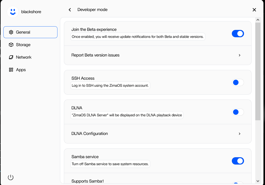

I have now enabled it. Do I need to do a offline update?
Its currently not showing up. How long before it shows up for update?

I have installed the beta now.
It does just seem to idle now.
