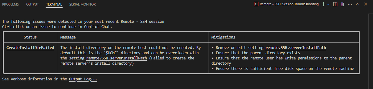

How do I connect to ZimaOS using VSCode?
When I try to connect to ZimaOS (on my zimacube) using VSCode from my other PC I get this message:
I am not able to connect using VSCode.

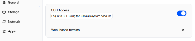

I am able to connect using Guacamole and ttydBridge app.
For security purposes, the folders under ZimaOS are mostly read-only. This might be the cause.
