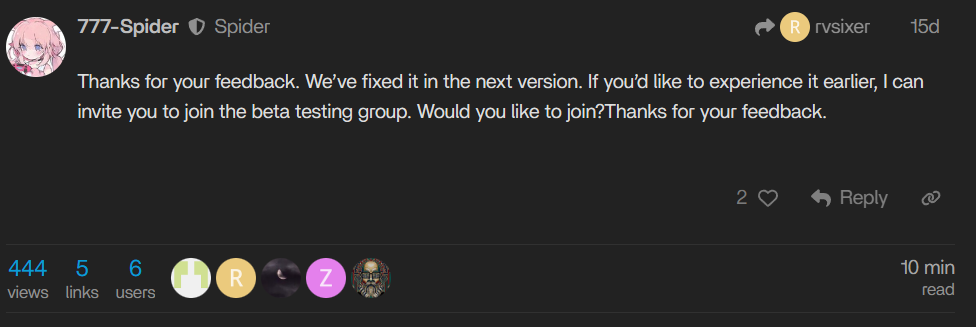

I too am new to ZimaOS and am experiencing the same behavior. My HDDs are setup in RAID1 and I believe it has something to do with RAID. But it is my understanding that this is going to be addressed in the next release, which should be released soon. My original HDDs were just standard desktop drives so I was concerned with all of the spinning up and down. But I recently replaced them with NAS rated drives and now just leave them spinning. I believe that this issue has been seen by many users, but it sounds like they have it sorted out. :slight_smile:
Raid/disk spindown (standby) not working as described - reasons and workaround
Welcome to version 1.6.0 beta2. We look forward to your feedback.
