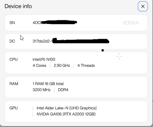

I have the Zimacube since Kickstarter and it does work almost perfectly, my issue is with handbrake and my rtx a2000, it will not detect the nvenc, no matter what handbrake version I use
Plex / Jellyfin / Immich will detect and use the card , also nvidia-smi does detect the card as well
