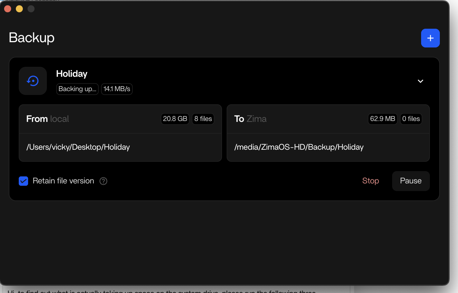

Also, are you using the client backup feature? If yes, could you please share a screenshot of your backup path in the client, similar to this example?
