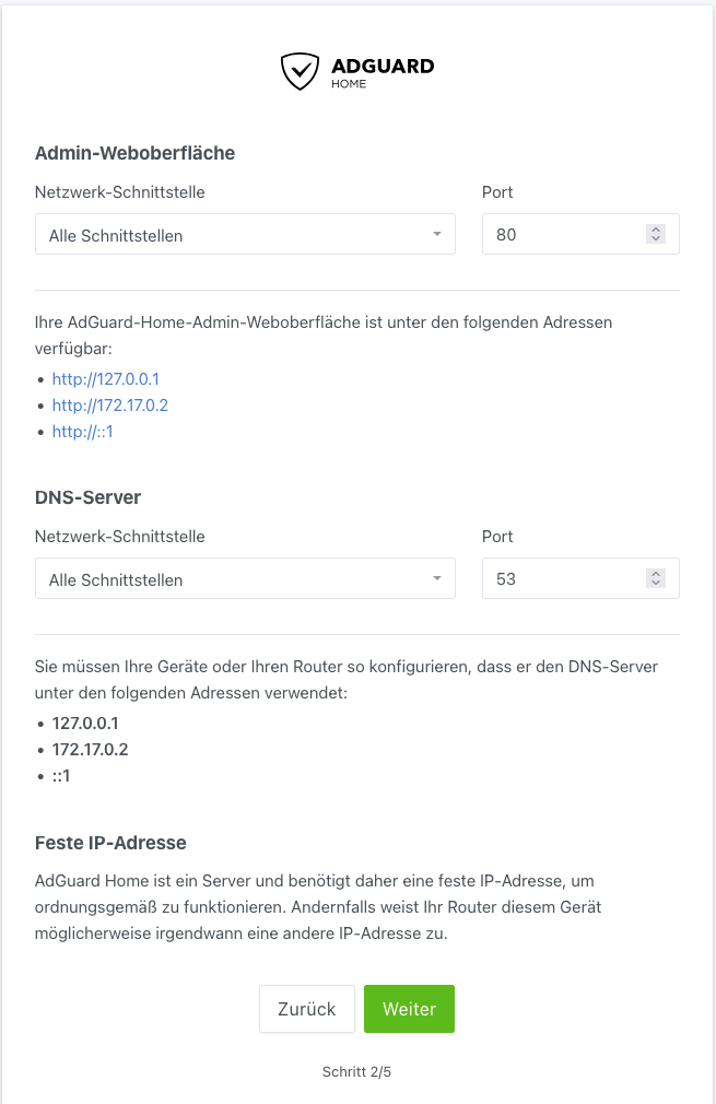

they are “healthy” just they dont want to be part of my local network (192.168.60.0/24)

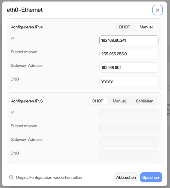

after doing a standard install thats what i see :
whereas my ethernet setup is

– Update :: this guide helped AdGuard unter ZimaOS installieren: Webinterface erreichbar machen, DNS eintragen – FRUNC
sry its german text but in general it says : Install the “Network” version (not the one thats default) run thru the setup then add tcp ports 8080 and 80 in app settings…
the setup assistant still doesnt show the 192.168.60.xxx IP but it seems like he does work.

What AdGuard is showing during the setup wizard is actually normal in many Docker deployments. The wizard only sees the network interfaces available inside the container, which is why it lists addresses like 127.0.0.1, 172.17.x.x, or ::1 rather than your host IP (192.168.60.241).
The important test is whether you can access the web interface and whether clients on your network can use AdGuard as their DNS server. From your update, it sounds like the network version of the app plus the additional port mappings resolved that part.
I would be cautious about editing the compose file and switching to network_mode: host unless you specifically need it. On ZimaOS, changing networking modes can sometimes create port conflicts or make an app inaccessible if the configuration no longer matches the App Store deployment.
If AdGuard is now reachable and DNS queries are being answered correctly from devices on 192.168.60.0/24, then I would consider that a successful setup, even if the installation wizard never displays the LAN IP you expected.
Out of curiosity, can you confirm whether a client device is now receiving DNS responses from AdGuard and whether ad blocking is working as expected? That would help confirm everything is functioning normally.
