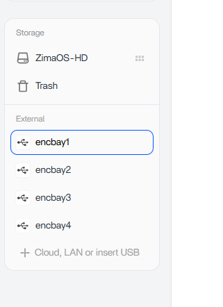

Files App Shows "Storage not Mount" Error message after manually mounting USB Drives by CLI
I have a GMTek mini computer connected via USB to a Terramaster 4 bay NAS enclosure.
Within the enclosure are 4 2TB Seagate HDDs.
I have mounted the disks within the command line and updated the /etc/fstab file with UUID entries of the drives to make the mount persistent.

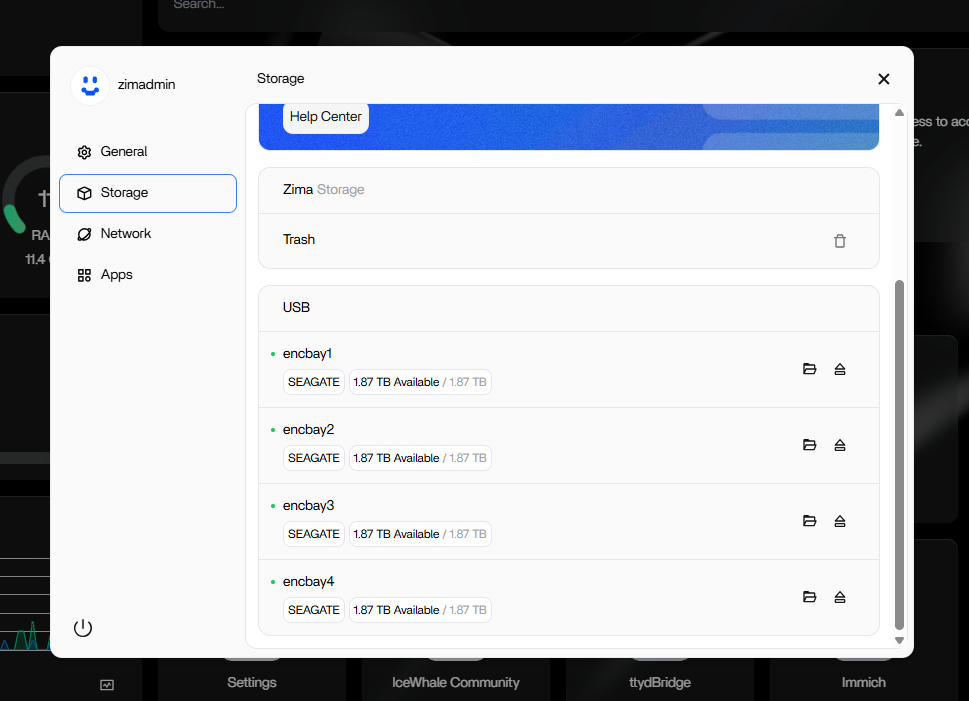

If i look in the storage section of the Dashboard, everything to my ey looks good

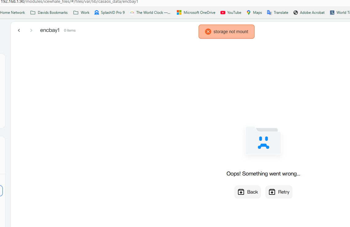

But when I go to the Files app and click on one of the drives in the left hand panel
i get a “Storage not Mount” error.
This suggests to me that the CLI mount has not been successful in some way.
Any ideas?
I believe what you’re seeing is expected.
Because the disks were mounted manually via CLI/fstab, Linux sees them, but ZimaOS never registered them in its storage database. So the Files app shows “Storage not Mount”, even though the mount is valid.
If you want the UI to recognise them, remove the fstab entries and add the drives through Storage in the dashboard.
If you keep using manual mounts, that’s fine, but the Files app will continue to show “not mount”.
