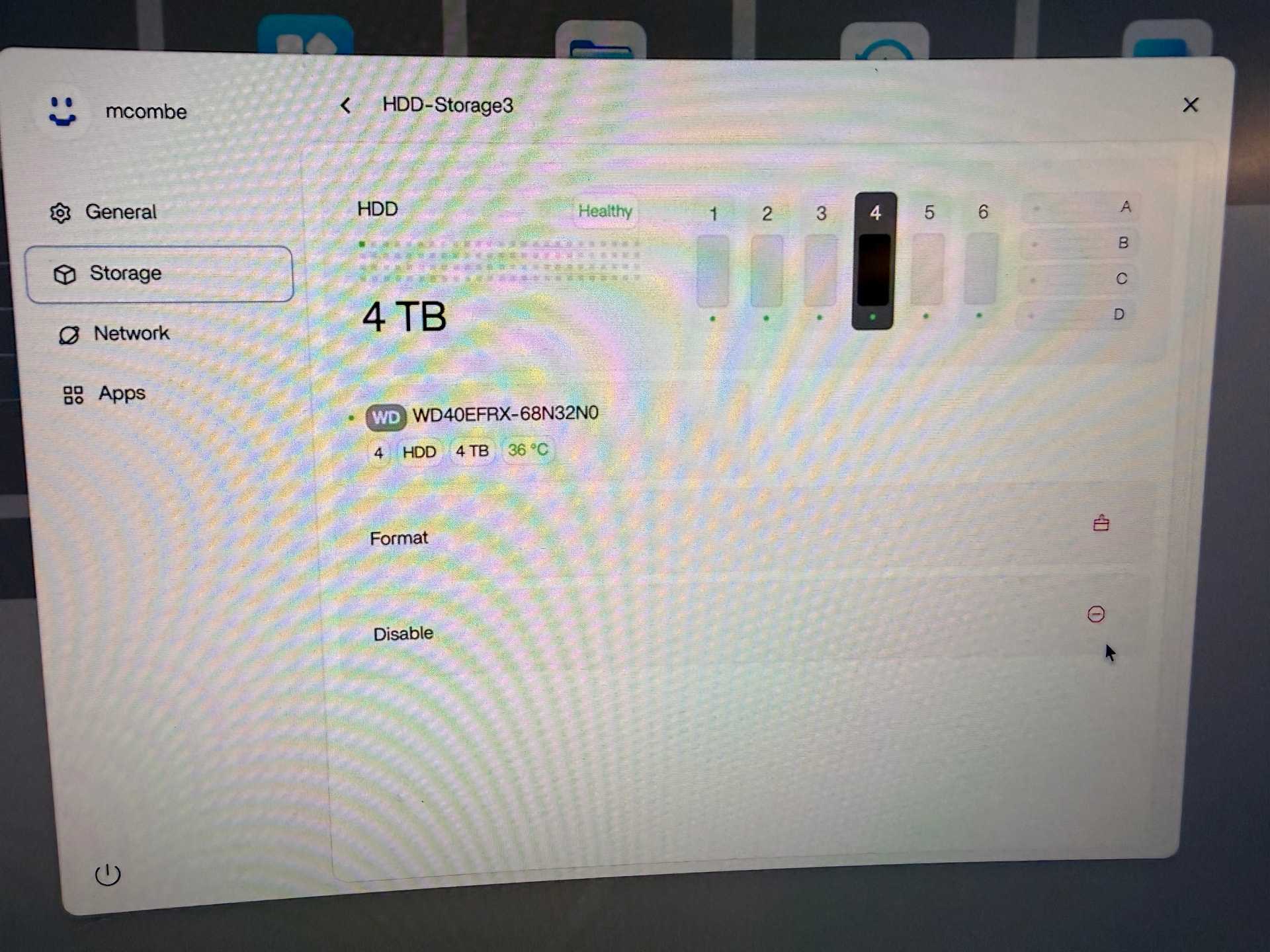

When attempting to disable a drive in ZimaOS on my ZimaCube I get a popup error in red that says Failed to Disable: Precheck Failed. How do I fix this and disable the drive.

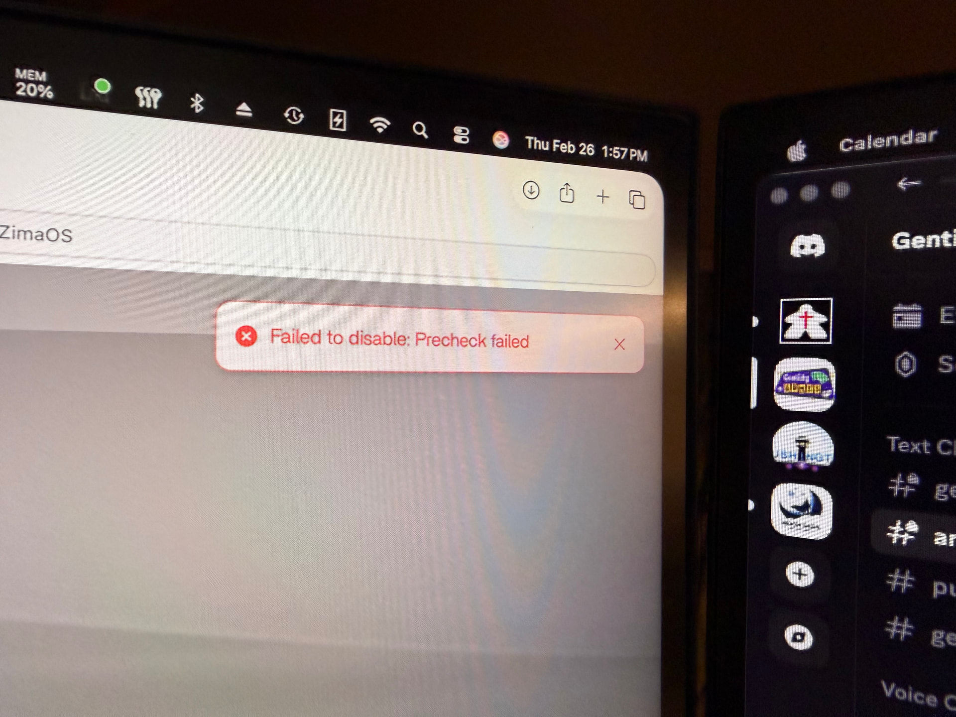

I click the little stop sign where is says Disable and the message Failed to disable: Precheck failed pops up in the upper right hand corner of the screen for a few seconds then disappears.

Then the process hangs.
We have found and fixed this problem, which will be included in the next version, and the following is a manual solution
sudo -i
sqlite3 /var/lib/casaos/files.db
LTER TABLE trash_files ADD COLUMN user_id INTEGER NOT NULL DEFAULT 0;
.exit
systemctl restart icewhale-files
