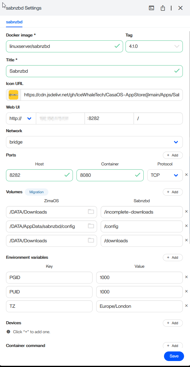

Below is my current setup and the App settings screen.
This is how it looks atm.
This is what i have on the App Settings

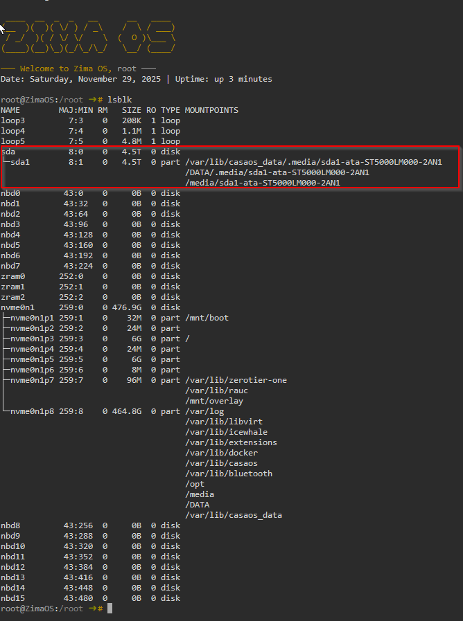

I think i did all that.
sda           8:0    0   4.5T  0 disk
└─sda1        8:1    0   4.5T  0 part /var/lib/casaos_data/HDD1
                                      /DATA/HDD1

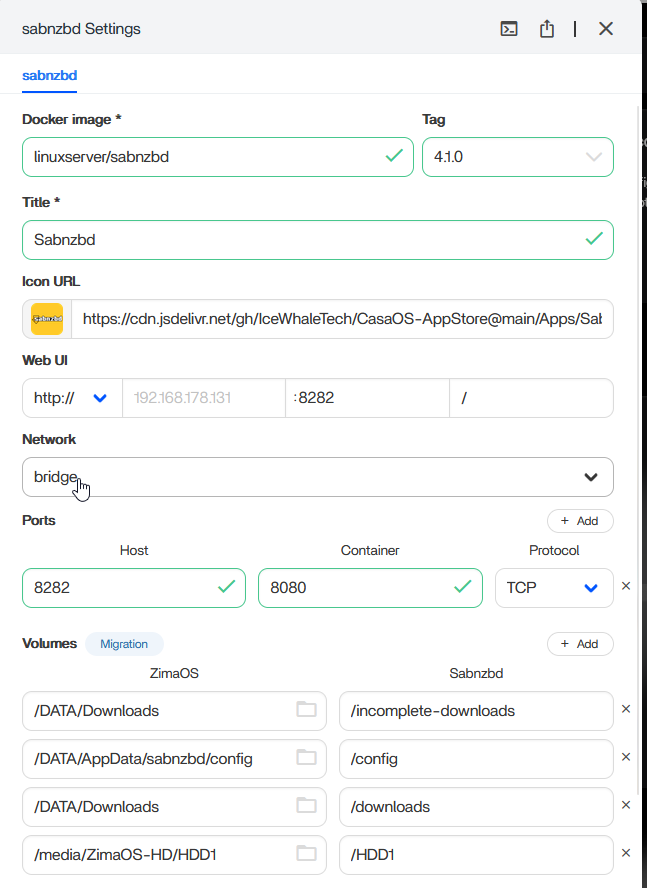

I created the Path /DATA/HDD1 and mounted it.
In the App i put the Settings like this.

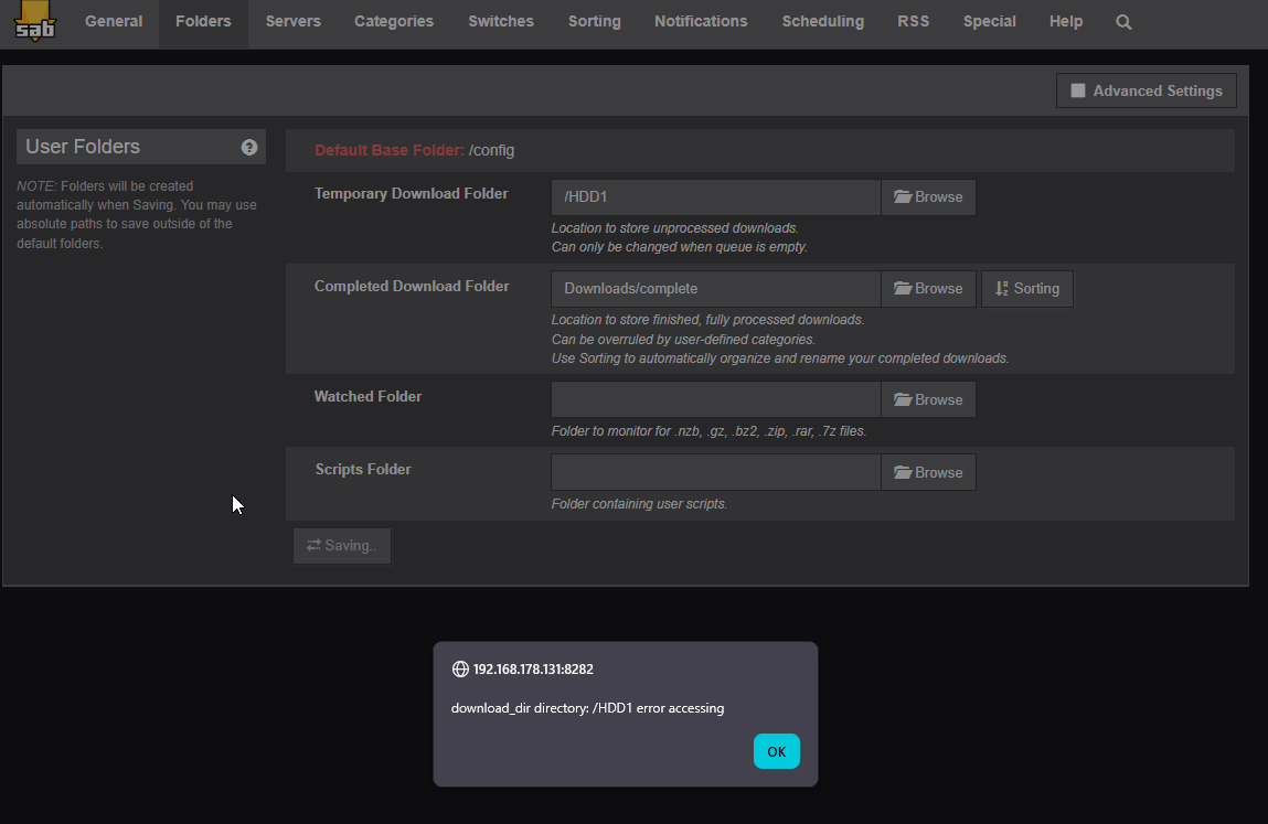

Yet when I´m selecting the Download Path in SABnzbd i get a Permission Error.
What have i done wrong?
App settings => adjust PUID, because „1000“ is not correct. Set PUID to 999 and try again.
