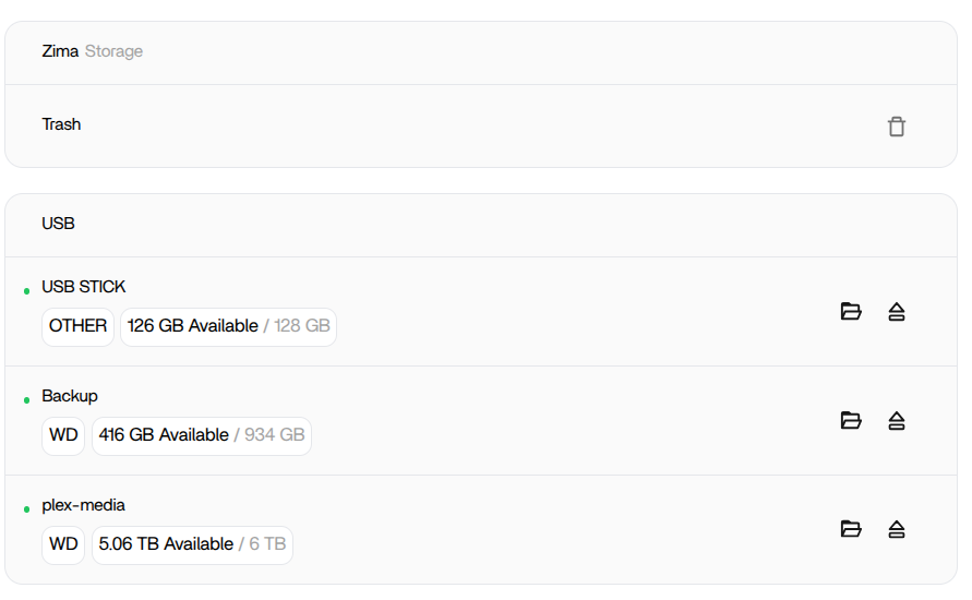

EMBY and Jellyfin cannot get to folders on usb connected drives
From your screenshot the USB drives are mounted correctly at the OS level (green status, capacity shown), so the issue is very likely container-side access, not storage failure.
On ZimaOS, apps like Jellyfin and Emby run inside Docker containers. They can only see paths that are explicitly mapped into the container.

That worked–=new to this–Thanks
