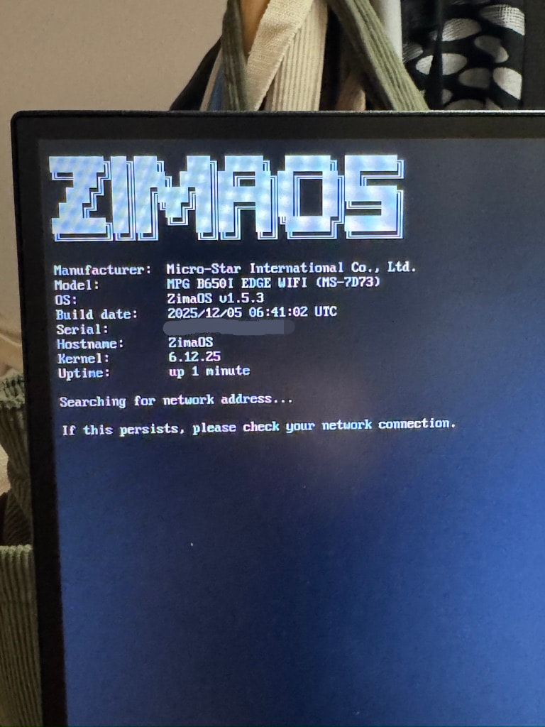

I have installed v1.5.3 x86_64, where it kept showing the following:
I have managed to check in network manager tui, but although it was not showing any WiFi entries and also checked if i could modprobe the driver and it was saying that the module does not exist within the FS.
Let me know whether you require more information.
