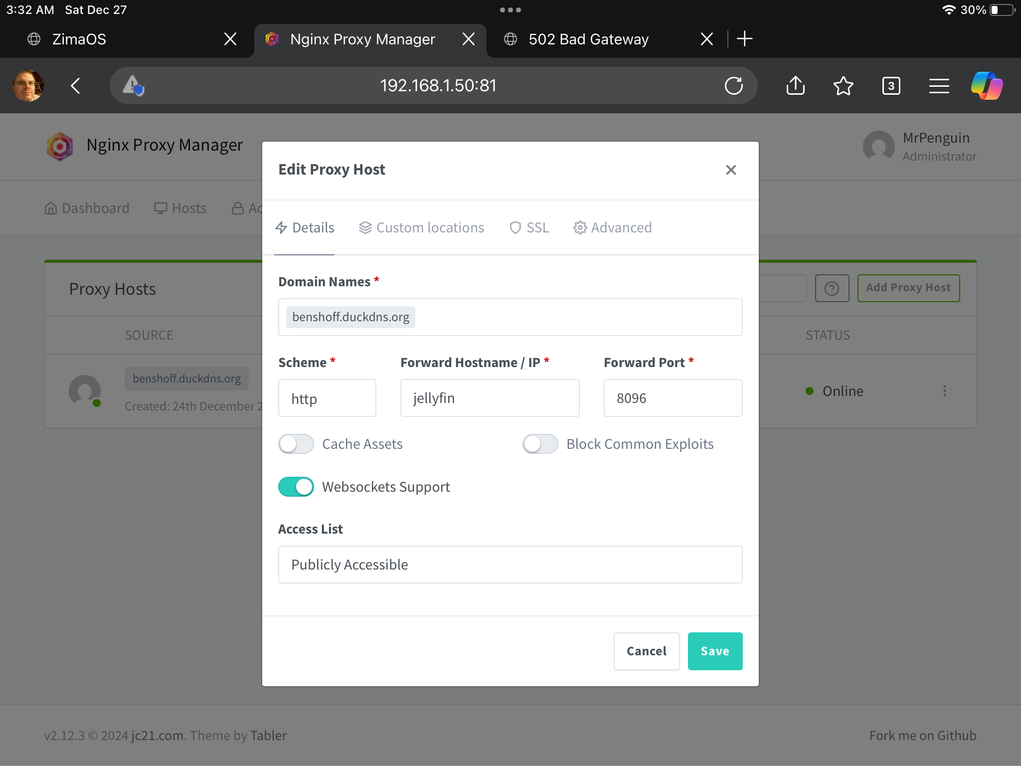

Step 2 – Fix Nginx Proxy Manager (this is likely the issue)
Edit the Proxy Host and set exactly:
  • Domain: benshoff.duckdns.org
  • Scheme: http
  • Forward Hostname: jellyfin
  • Forward Port: 8096
  • Websockets: ON
  • Block Common Exploits: optional
  • Nothing else enabled
Save.

Step 1, Fix the Proxy Host (THIS IS THE IMPORTANT PART)
Open Nginx Proxy Manager > Proxy Hosts > Edit your domain
Set EXACTLY:
  • Domain Name
  • Scheme
http
  • Forward Hostname / IP
jellyfin
  • Forward Port
8096
  • Websockets
ON
Everything else OFF.
Save.

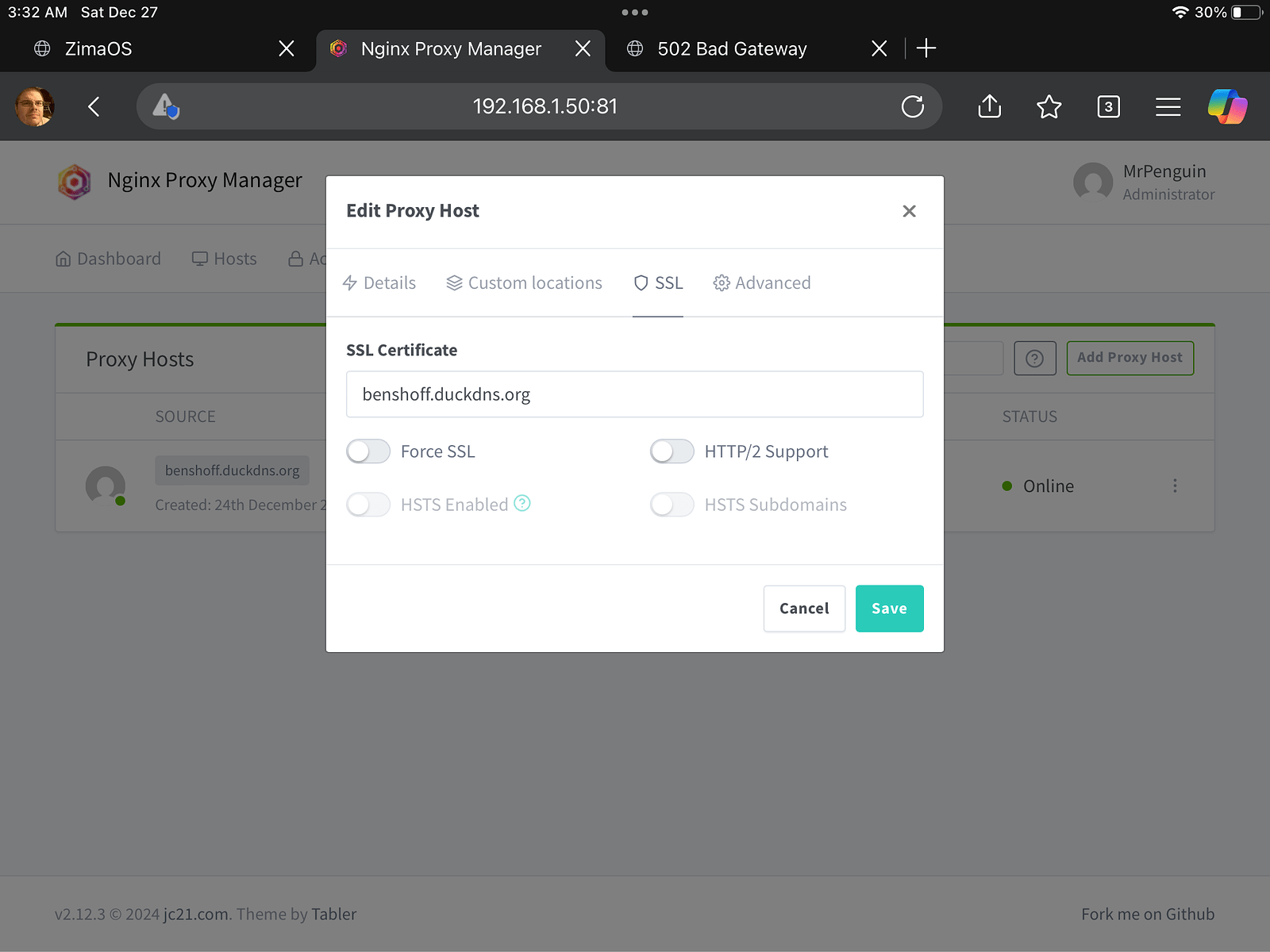

I do not see an option to disable ssl temporarily
I stopped at that point. As everything I have is what you have told me.
By turning on http2. Only. Which is what I think you wanted me to do, went to my router afterwards again. I. Now have it back to the screenshot I gave before
Thanks, this explains it. One clarification first:
HTTP/2 is NOT what needed to be turned on.
Turning on HTTP/2 does not disable SSL and does not fix routing. It actually changes nothing for this issue.
What we need to do is remove SSL entirely for a moment so we can test basic routing.
Do this exactly (no router changes)
Step 1, Remove SSL properly
  1. Open Nginx Proxy Manager > Proxy Hosts
  2. Edit benshoff.duckdns.org
  3. Go to the SSL tab
  4. In SSL Certificate, select:
None
  1. Make sure all toggles are OFF:
  • Force SSL
  • HTTP/2
  • HSTS
  1. Click Save
This is the only way to “disable SSL” in NPM.

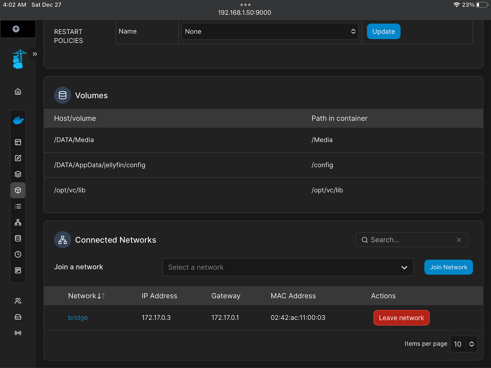

Step 3, If it’s still 502
Then Jellyfin and NPM are not on the same Docker network.
Fix:
  • In Portainer, check which network Nginx Proxy Manager uses
  • Attach Jellyfin to that same network
  • Redeploy Jellyfin
  • Repeat Step 2

This is what I am seeing
Your setup is correct. The only problem is that Nginx Proxy Manager is not reaching Jellyfin by name.
Fix it like this:
In Nginx Proxy Manager > Proxy Host set:
  • Scheme: http
  • Forward Host / IP: 172.17.0.3
  • Websockets: ON
Save.
Then open:
http://benshoff.duckdns.org
You should see Jellyfin.
After that works, re-enable SSL and force HTTPS.
Do not change anything else.

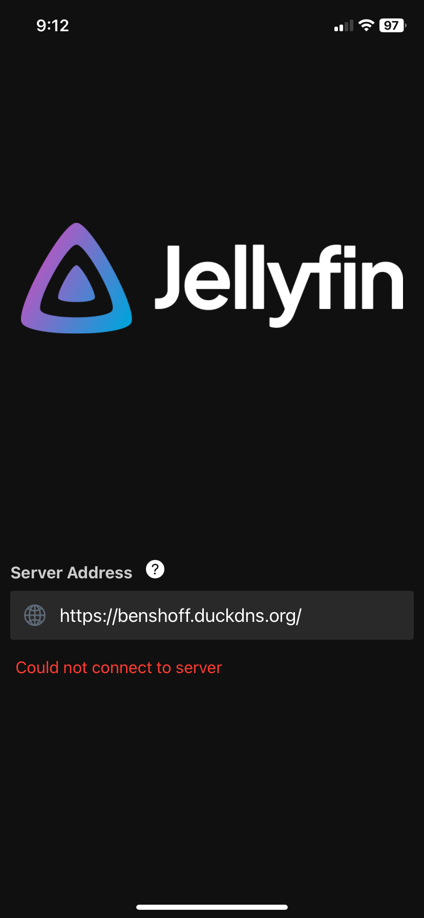

Thank you for your explanation as always. Using the instructions as provided on your last comment to me, It still will not work on my app on my iphone. I have not tried it on roku or firestick yet. I ran out of time. I included a screenshot of the app on my phone
What’s happening
Your phone is on the same local network as Jellyfin.
When the app tries to reach:
https://benshoff.duckdns.org
it goes out to the internet and back in.
Your router does NOT support NAT loopback (hairpin NAT) for apps — very common.
That’s why:
  • Jellyfin works in the browser
  • HTTPS works externally
  • Jellyfin mobile / Roku apps fail locally
  • Plex works (it uses cloud relay)
Nothing is misconfigured.
The correct fix (simple)
While you’re at home (same Wi-Fi/LAN):
Use local IP in the app:
http://192.168.1.50:8096
That will work immediately.
When you’re away from home:
Use:
Why this matters
  • Jellyfin apps do not handle routers without NAT loopback well
  • Browsers are more forgiving
  • This is a router limitation, not Jellyfin, not ZimaOS, not NPM
Optional (advanced, not required)
To make one address work everywhere, you’d need:
  • NAT loopback enabled on the router or
  • Split DNS (internal DNS points benshoff.duckdns.org to 192.168.1.50)
Most home users don’t bother.
Bottom line
  • Your setup is correct
  • Use local IP at home
  • Use DuckDNS externally
  • Roku and Fire TV will behave the same way
You’re done, this is expected behaviour, not another problem.

  • 172.17.0.3 = Jellyfin’s internal Docker IP
    This is the only IP NPM should forward to.
When you changed NPM to the public IP, routing broke, which is why:
  • DuckDNS went to ZimaOS again
  • Port 81 stopped working

In Nginx Proxy Manager > Proxy Host:
