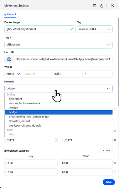

Since network connectivity varies from region to region and from ISP to ISP, you may be able to test network connectivity using some tools.
For example, the Chrome browser in the BigBear store can be used to perform this type of test intuitively. (The ZimaOS supports installing Docker apps from third-party stores. It also supports manual installation of apps from yaml file/CLI.)

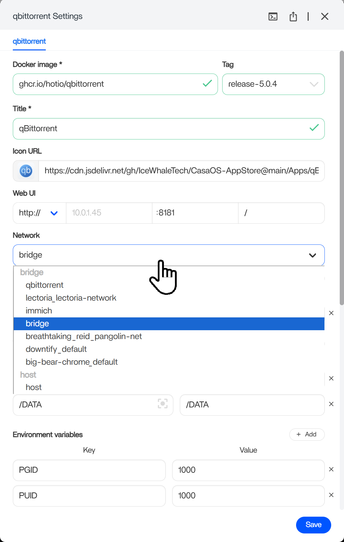

At the same time, network modes such as Host are also options worth trying.
You can change the network settings in the app settings panel.
Looking forward to your feedback.
Yeah that’s what ended up fixing it. Dk why the bridge was failing even after a clean install, so shifted all my containers to host mode.

Before setting it to host, make sure to note down the container port while in bridge mode. That will be the port you need to use. For jellyfin, that’s 8096. So your new url is [ip-address]:8096
I think that’s what it was! It looks like even after swapping the port to 8096 and setting it to host, the link from the dashboard was still pointing to <ip-address>:8097. Navigating directly to <ip-address>:8096 worked!

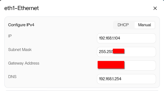

Might this be the problem? The Gateway Address value is my real, public IP. This is from the Network settings for my cube.

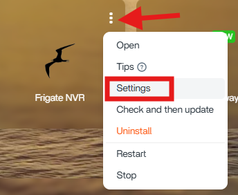

That could be vpn related, but no typically that would not be your public IP. That looks like DHCP is handing out a bad gateway if it is saying your gateway is your public IP address. As for where I was talking about is under App Settings.
From the main dashboard, find the app, click the 3 dots, then settings
From there you can go to the top where my last screenshot showed where the docker terminal would be at.

It looks like you set your IP static? The gateway should be your internal IP for your router typically. In your case it is likely 192.168.1.1 or if your DNS is your router, then 192.168.1.254
But yes, that could easily be the issue completely.
The issue is the gateway setting.
Your gateway is set to a WAN (public) IP, which breaks outbound traffic.
A gateway must be a local LAN IP on the same subnet, for example 192.168.1.1.
Private LAN ranges are 192.168.x.x, 10.x.x.x, 172.16–31.x.x.
Public/WAN IPs cannot be used as a gateway.
Once the gateway is corrected and the service restarted, metadata and images will work normally.
