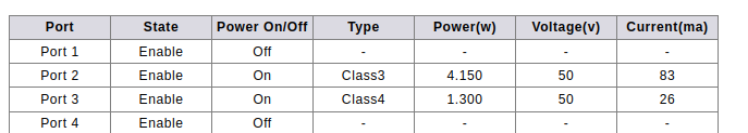

I got the Ethernet card sometime ago, but just today I got a POE switch.
It doesn’t work completely, though. I think the power provided by switch is below what ZimaBlade needs to work when my SATA SSD is connected:
Port 2 is my Home Assistant Yellow. Port 3 is the Ethernet card with POE I got it.

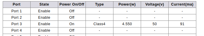

If I remove the SATA SSD I can boot over eMMC. Here is the power consumption after I removed the SSD:
