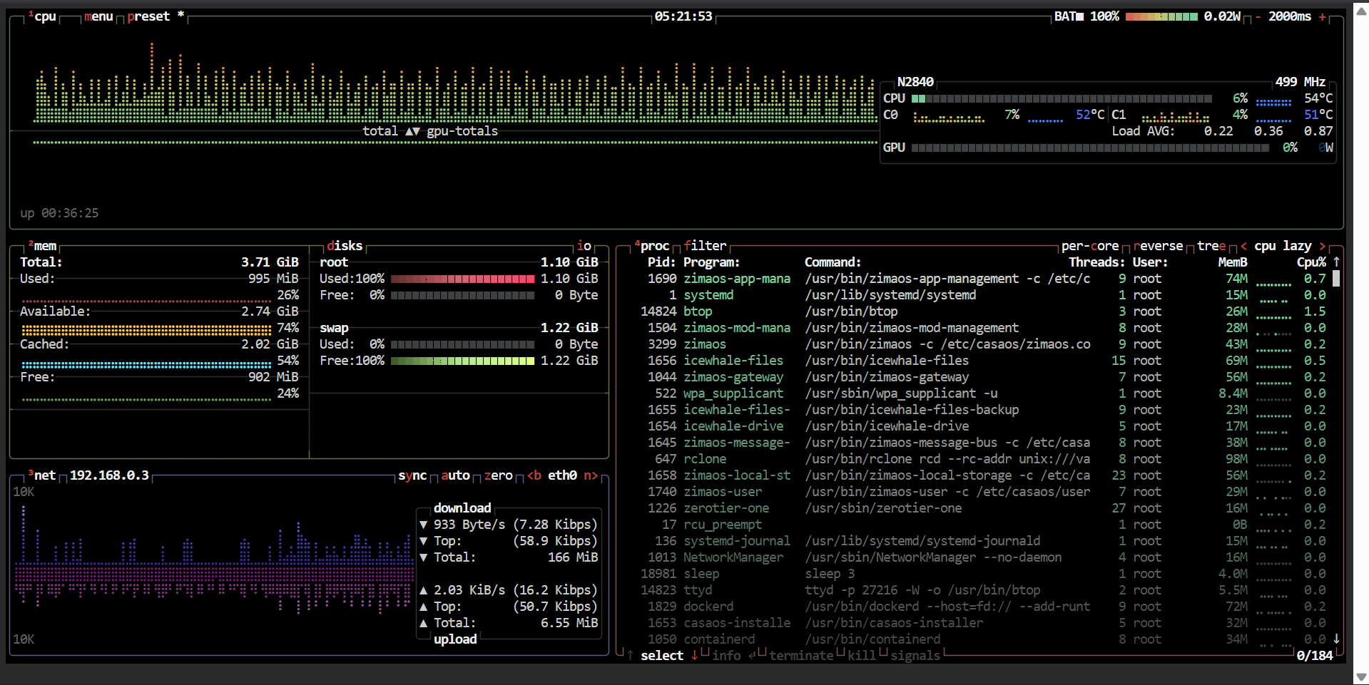

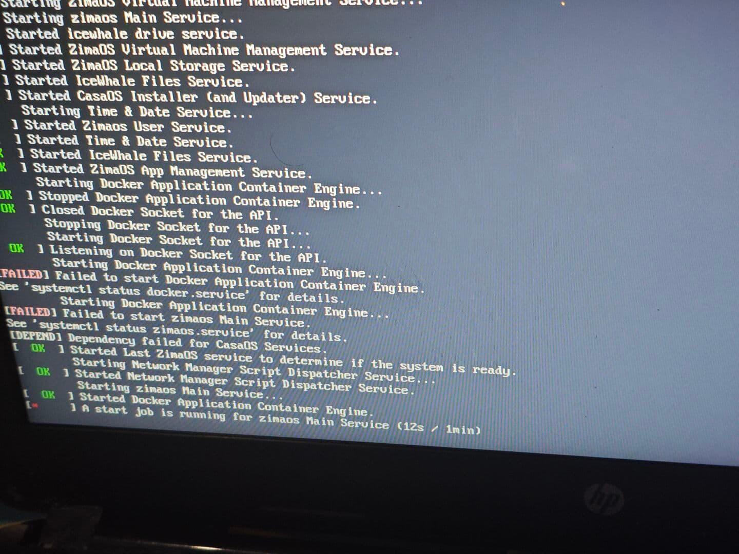

hey guys sorry for the broken english my cpu seems to be getting stuck at 500mhz with a maz power consumption of 0.4w when i was using casa os it could get up to 1.3w while pluged in i dont know what i did wrong withe the install i assume i did everything ok except when i boot up it shwos up docker and zima os wont start would that be anyhow related to my problem? once again sorry for the bad english

my cpu is getting stucked at 500mh and wont go any higher than that
And I can reproduce the problem like this:
i cant seem to tell you how to reproduce it since its doing it from the very beginning i boot up into zima os
here is the screenshot if you are referring to the error at boot shows and my stagnant cpu

i hvent done anything other than installing a immich and jellyfin and thats when i notice my cpu wasnt getting any faster and the power consumption stays the same
And I have tried these operations to fix it:
i have tried to install some cpufreq tools but failed as i cant seem to install it
i’ve tried reinstalling it 2 times and it still showing the same results
i’ve tried updating my bios since i saw it could be a firmware issue and still the same
i am monitoring it directly through the webui and btop which yielded the same results

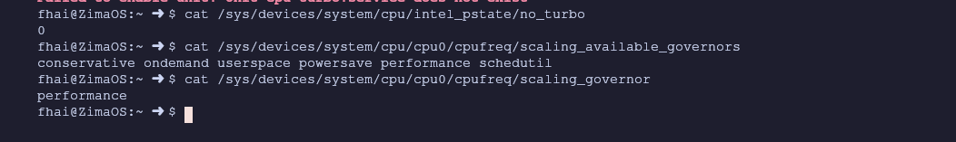

Please type in the command line:
cat /sys/devices/system/cpu/intel_pstate/no_turbo
cat /sys/devices/system/cpu/cpu0/cpufreq/scaling_available_governors
cat /sys/devices/system/cpu/cpu0/cpufreq/scaling_governor
Then show me the results.

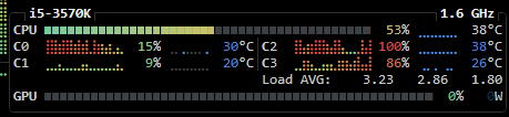

I am also having a similar issue.
CPU freq stuck at 1.6 GHz as shown in btop
Wattage seems to top out at ~25W
ZimaOS itself seems to run fine, but impossible to run any ZVM at these speeds.
Plex runs fine if not transcoding
Only noticed the issue once I tried to install some VM instances.
I tried enabling XMP in the BIOS as well as making sure turbo freq is set to auto. Same issue.
Running ZimaOS 1.4.4-1
System is an ASUS Z77 Sabertooth motherboard on the latest BIOS with an i5-3570K, 8GB of DDR3 RAM, running on a 128GB SSD.
The following are my responses to the three cat commands you inquired about regarding the other person:
0
conservative ondemand userspace powersave performance schedutil
userspace
Let me know if you need any more information.

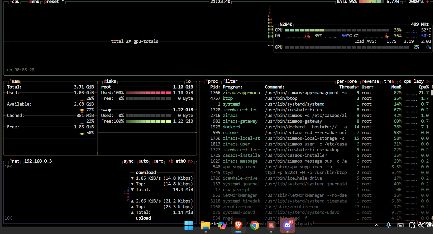

im quite confused as how to set up this fix of yours but when i try reinstalling again with the 1.5.0 version my cpu now is turboing but it seems now the idle freq is quite high(15-30%) do you seem to have that problem?
