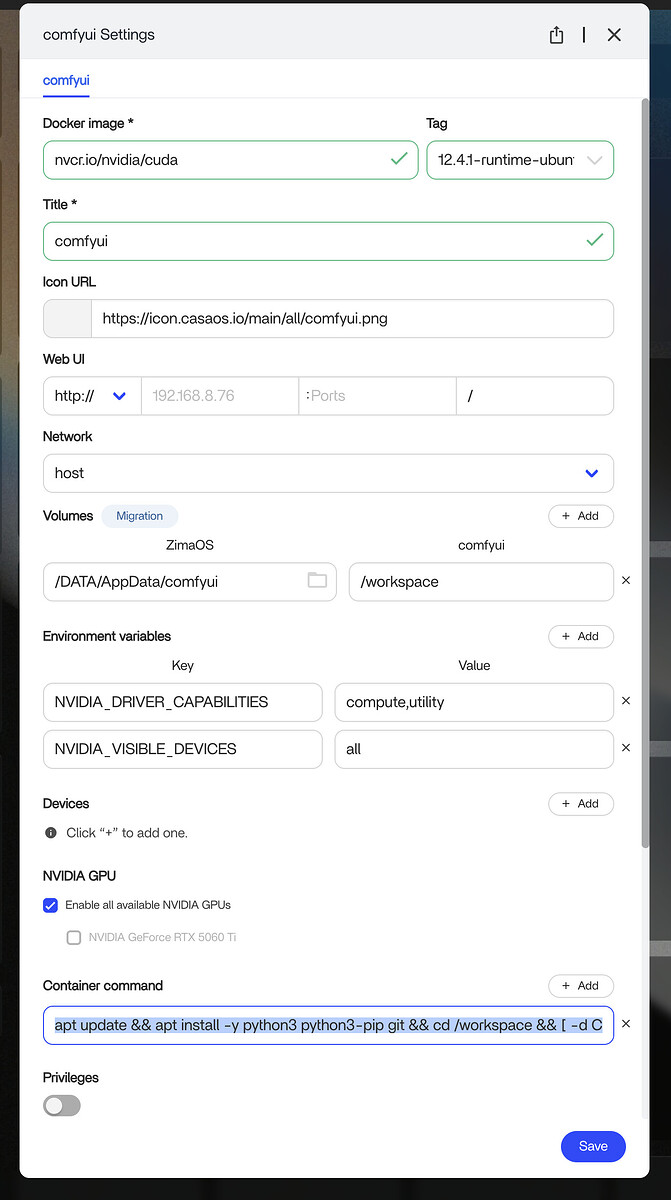

I could not get the app store version working but I eventually got comfyui working through a custom container.
the custom command is
apt update && apt install -y python3 python3-pip git && cd /workspace && [ -d ComfyUI ] || git clone https://github.com/comfyanonymous/ComfyUI.git && cd ComfyUI && pip3 install --upgrade pip && pip3 install --pre torch --index-url https://download.pytorch.org/whl/nightly/cu124 && pip3 install -r requirements.txt && python3 main.py --listen 0.0.0.0 --port 8188
should also add that im using a 5060ti and the driver support for this is probably the worst I’ve seen. More than a year out, and these blackwell cards still have poor driver support.
Props to the zima team for supporting it quickly though, and shame on nvidia.
it would then be running on 8188
