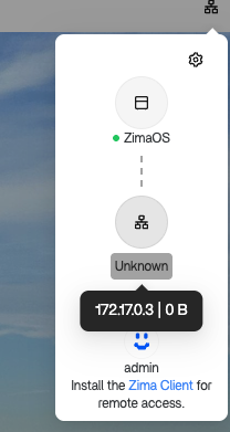

Not sure if this is related but when I click on the network icon on the top right, i get this:
the ip it shows 172… is not the servers ip whcih is 10.0.22.99
