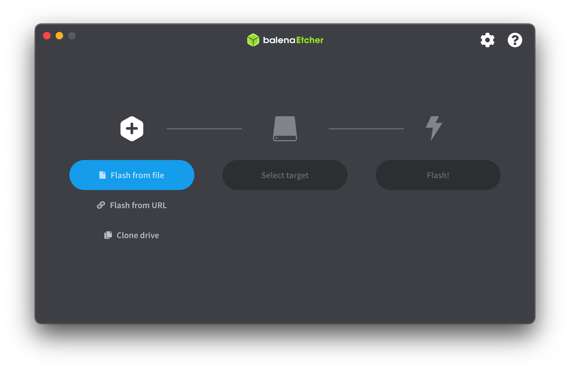

  1. Ubuntu System Installation
Refer to this guide for the specific installation process:
