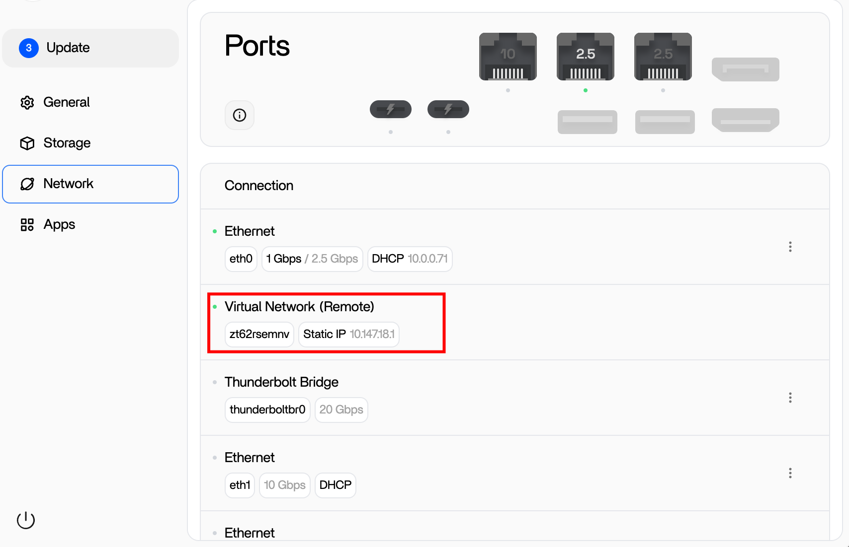

The IP address used for remote access is in the network settings, as shown in the following figure:
In my scenario using 10.147.18.1:8096
