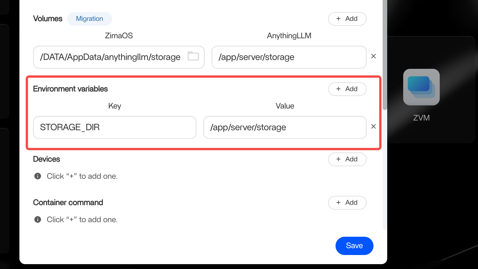

Hallo, i just installed anythinglll form app store without default settings, didnt change anything, when i try to load anythingllm i get an error message and cant load…does anyone has a similar problem?
I have the same issue with ZimaOS v 1.6.1 on a ZimaBoard 2. Did you found any solution?
You need to add an environment variable in the settings.
Reference documentation: anything-llm/docker/HOW_TO_USE_DOCKER.md at master · Mintplex-Labs/anything-llm · GitHub
