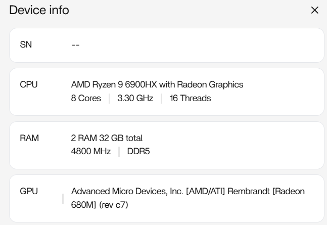

Likewise I’m running a AMD Ryzen 9 6900HX With Integrated AMD Radeon 680M Also have 32gb ram boot is 1TB SSD, plus another 2TB SATA, plan to add tomorrow another 2TB NVME drive (can support 2) I’ll have by USB3 or maybe USB4 C slot 2 16TB HDD currently on my OMV NAS as BTRFS Raid 1, would be nice if ZimaOS could use it without reformatting it. But either way I’ll have that. Probably going to shut down my Synology DS218+ that has 2 8TB HDD in them, and also hook them up to ZimaOS. I also might just sell the 218+ with the 2 drives in it. Both the 8TB and my 16TB drives are enterprise class drives.
Not that the integrated GPU is GREAT, it would be better to use it than not to use it.

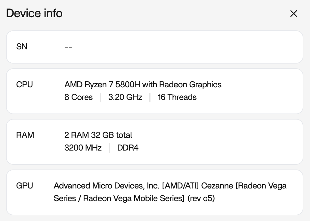

Hello guys,
I have to clarify. At present, ZimaOS already supports most AMD integrated graphics cards at the kernel level, since we don’t have enough AMD devices to test, but I tested only the AMD 5800H, which can fully use the GPU when transcoding with jellyfin. For ROCM, there really isn’t enough energy to support it at the moment.
So if it shows up in device info that means it will be used?
I haven’t tried to transcode anything yet. But apparently it does see mine
It appears in the device information doesn’t necessarily mean it has been driven. It takes actual testing to do that.
